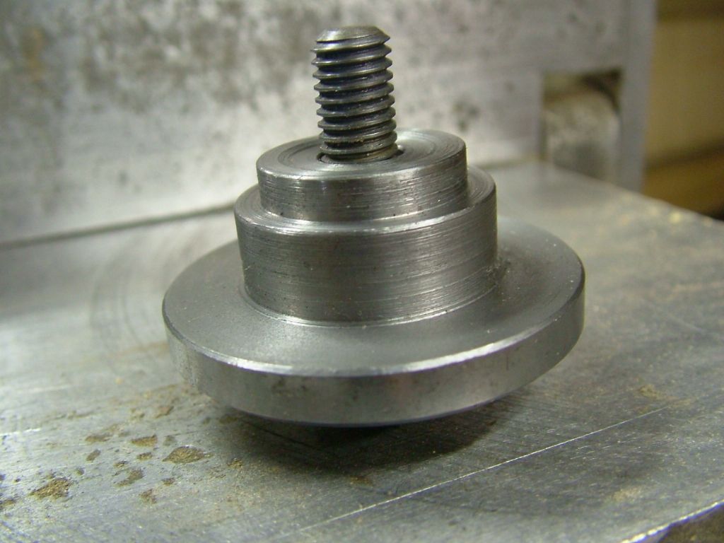

      Hi
      Fly cutter with the tool stuck out flailing a large radius on a small width workpiece NBG on a gear drive train.
      Keep the diameter of the cutting circle just a fraction wider than the job when flycutting to minimize the torque load on a chattering gear chain. Belt drive is infinitely smoother running on intermittent cutting
      Three toolbits mounted on 52 mm cutting head will cut faster with one bit starting the cut and the previous one exits.
      Setting up is a breeze take out the clamp bolt and fix the setup jig in its place to get all the tips equal by installing the toolbits to sit on the jig and do up the clamp screws.
      Sharpen dull HSS tips with an oilstone for longer life and almost mirror finish.

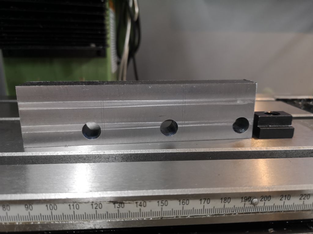

      Lee Jones 6
        @leejones6
        I do not currently have any plans to make new fly cutters.
        In fact, I'm only using (playing really) this one until the new carbide inserts for my face mill arrive.
        Not sure I can get any less stick-out than I already have. Maybe 5mm, but I've seen SO a lot further than mine.
        Incidentally I have noticed a small flat spot on the base of my cutter. I think my grind needs to be improved.

        Ron Laden
          @ronladen17547

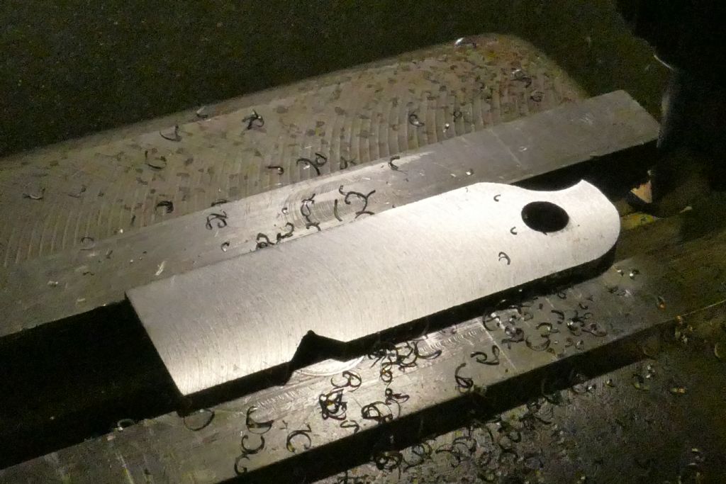

          Well done Lee, good that you have got a better finish. I am not used to the sound of your machine of course but the 600 rpm cut didn't sound that bad to me, sounded better than the slow cuts I thought.

            Recording on the mobile phone doesn't seem to pick-up the banging sound, which is a shame.

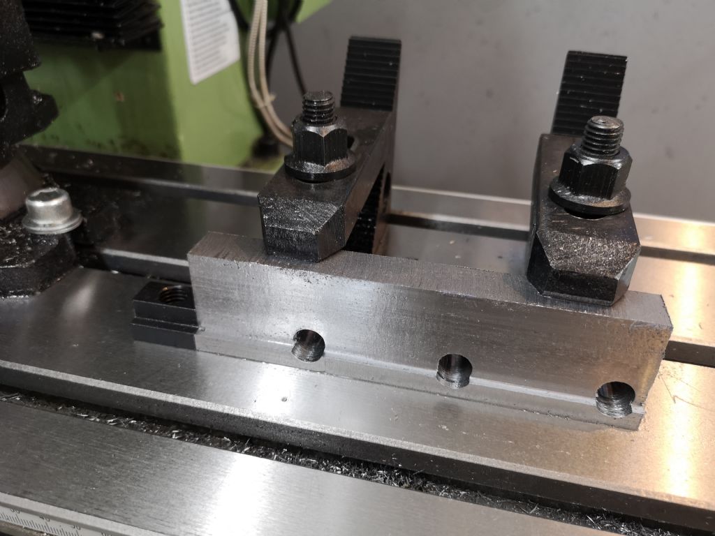

                    #475341
                    Martin Connelly
                      @martinconnelly55370

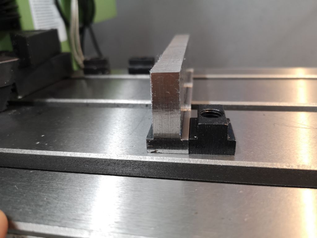

                      Lee, the low profile clamps mentioned earlier are here. They are priced for industry not home use but will give ideas on how to make your own.
                      WDS parts

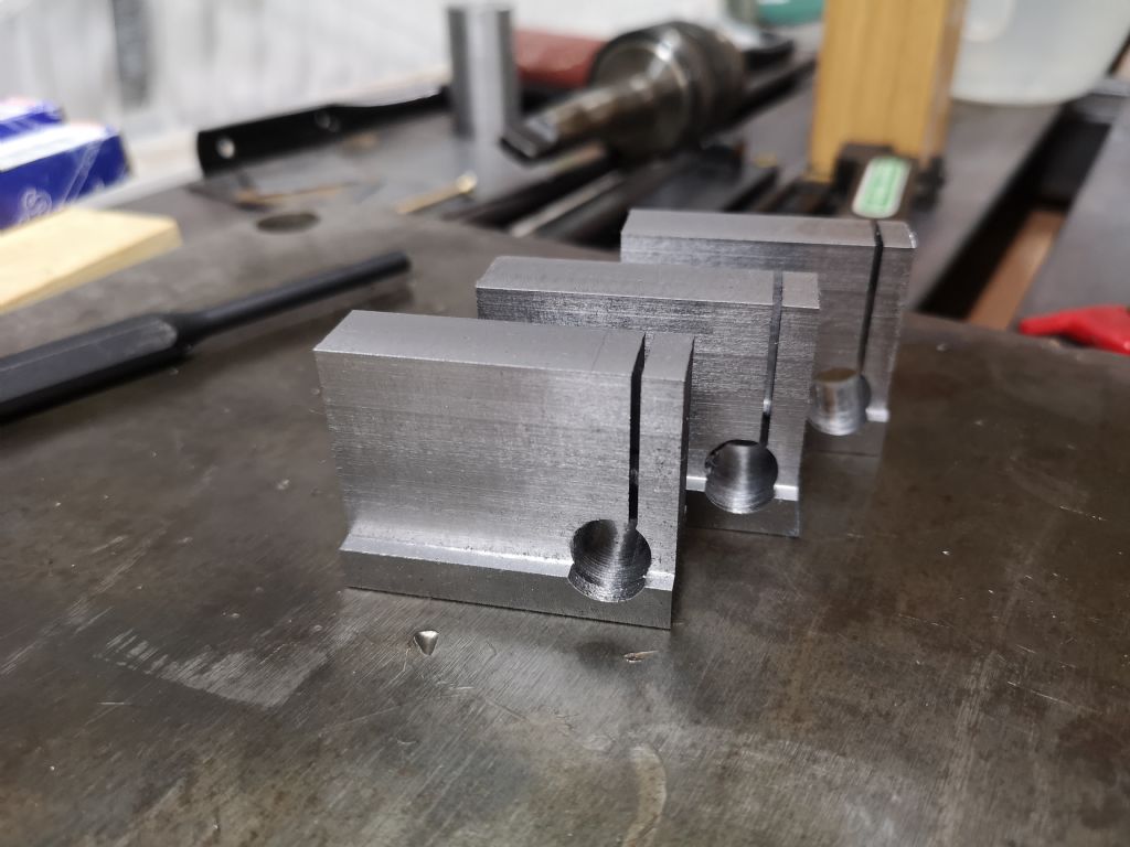

                        #475345
                        Lee Jones 6
                          @leejones6
                          Sneaky nap-time session:

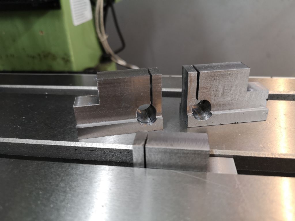

                          #475403
                          Lee Jones 6
                            @leejones6

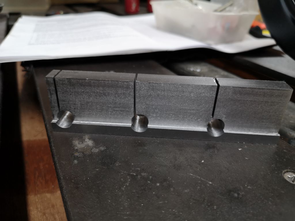

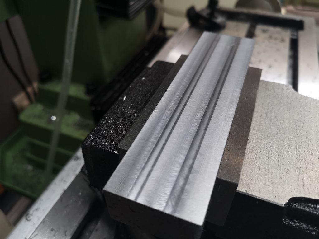

                            Other side milled:
                            #475404
                            Lee Jones 6
                              @leejones6
                              Not sure how I'm going to do the vertical cuts yet.
                              #475430
                              John Baron
                                @johnbaron31275
                                Posted by Lee Jones 6 on 27/05/2020 18:41:11:
                                Bandsaw !

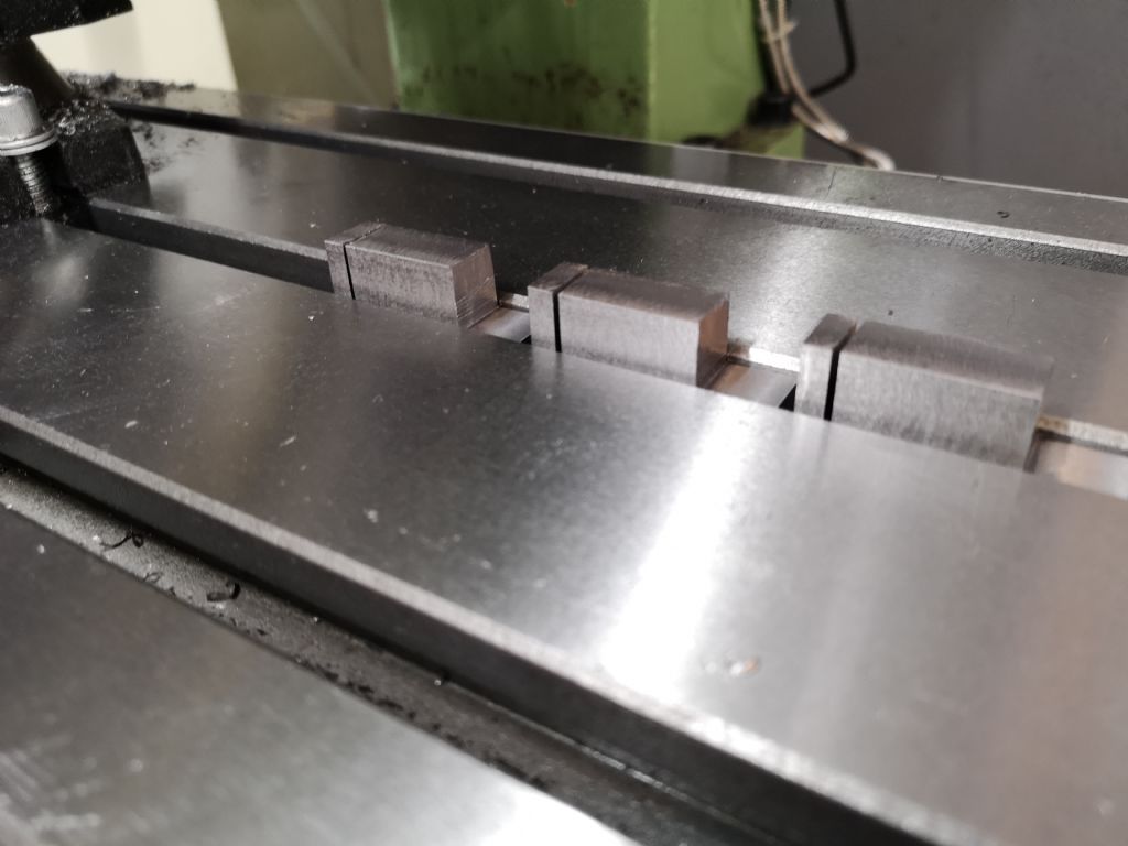

                                  #475457
                                  Lee Jones 6
                                    @leejones6

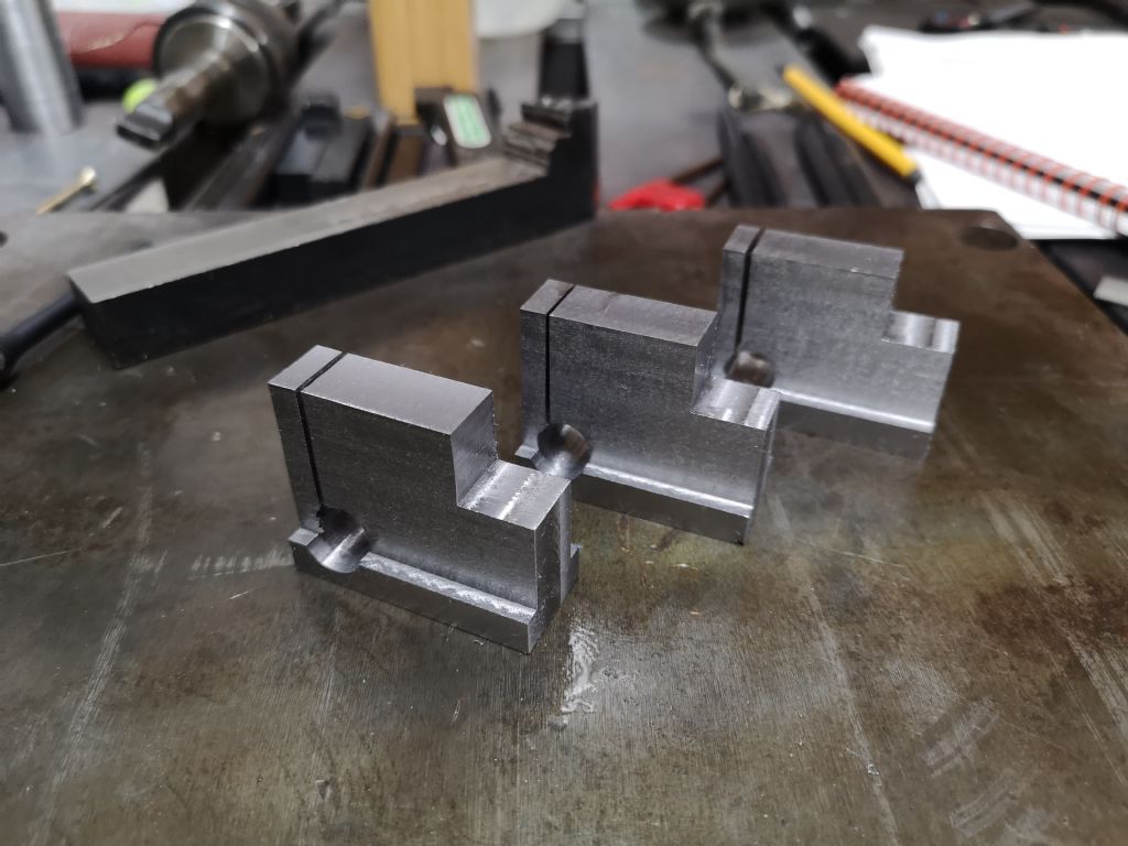

                                    Finished for the day:
