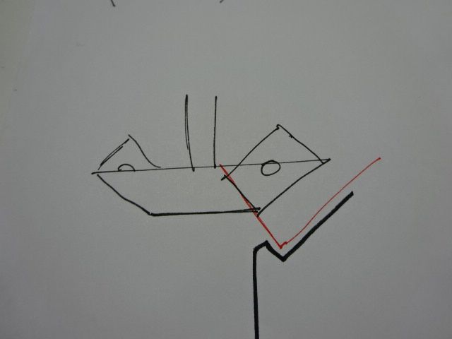

      Those insert cutters won't work as you need to get down into the bottom of the Vee, you need something that goes almost to a point if using an angled cutter.

        Actually the bottom of the 'v's are quite blunt:
        That cutter with those inserts was just a quickly Googled example.
        I'm sure you can pick-up sharper cutters.

          Lee that cutter will swing an inverted flat ended cone about 25mm across, So when used to cut the larger side of the Vee it will completely remove the smaller side, you need something that will cut like the red line, maybe 1mm at the bottom.
          #474613
          Lee Jones 6
            @leejones6
            Turn the work 45 degrees – put it on its side.

              Hi Lee, Guys,
              A 90 degree HSS or Carbide countersink will easily cut those "V" slots. The reason I said to take it easy with the cut, is that the shaft size on some of the counter sink bits may only be 1/4" diameter. As are some of mine. I have a nice six flute one that would do the job at full depth because it is on a 20 mm shank and is only 25 mm diameter. I've got that one in a plastic handle and use it for deburring holes.
