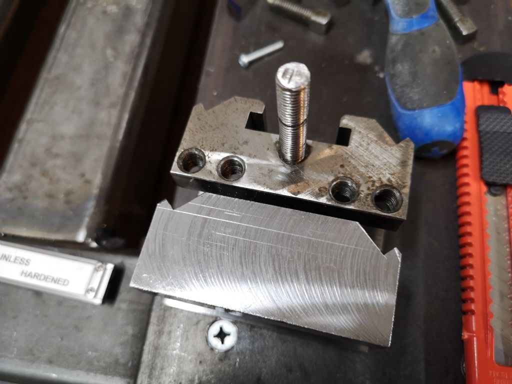

      Probably a little adventurous for someone at my level, but I do so like a challenge.

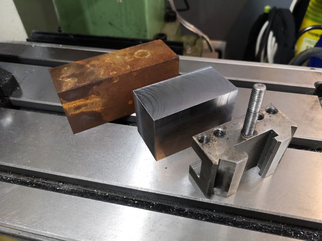

      From back to front;
      • Stock
      • Rough-cut Part
      • OEM Part

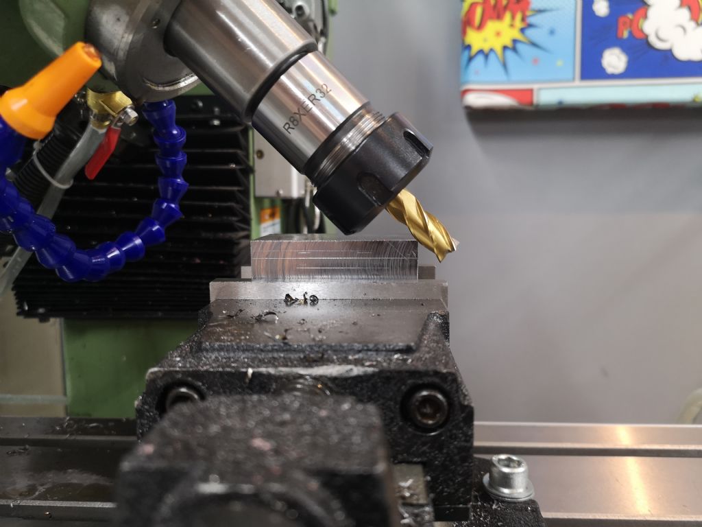

      Part milled to size:

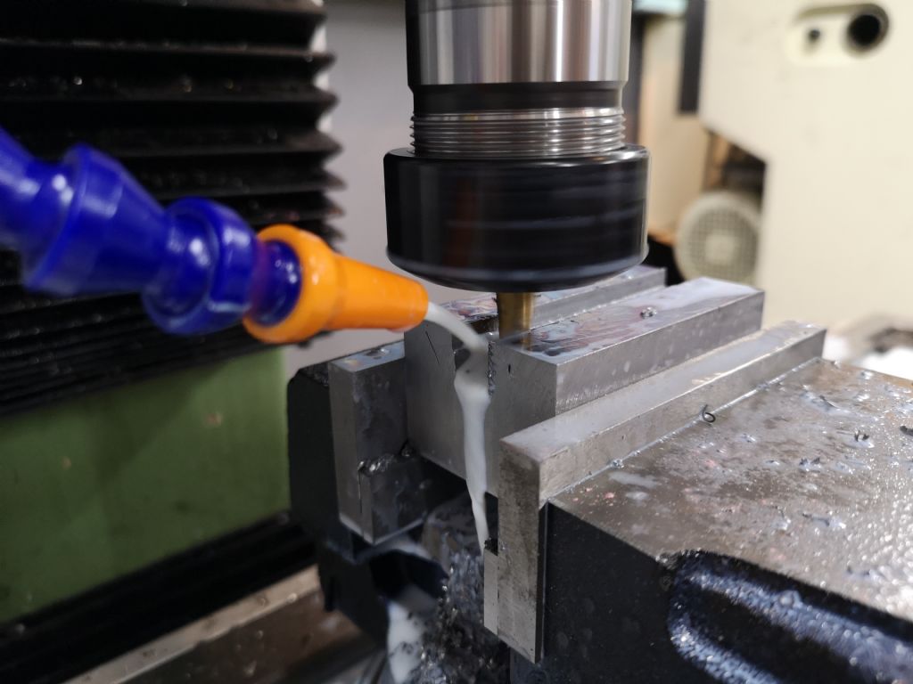

      Tool holding slot being milled with a 10mm 2-flute Carbide titanium nitride (TIN) coated HSS cutter:

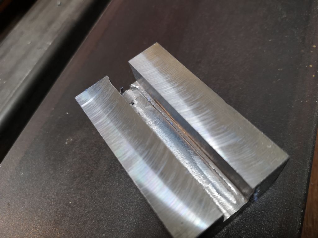

          Bump in the road.
          Looks like the cutter was pulled into the work on the last pass. Typical!
          Multiple failings on my part:
          • A 10-11mm collet was used (should have used 9-10mm)
          • The collet was not properly inserted/clicked properly into place (at least not intentionally!)
          • The collet needed de-burring
          Discussion HERE.

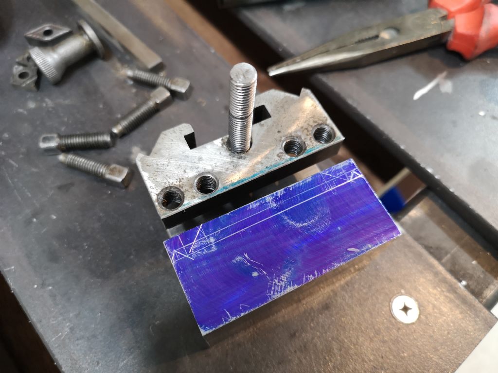

            Marking out for the 'V' slots.
            Discussion for cutting the slots HERE.

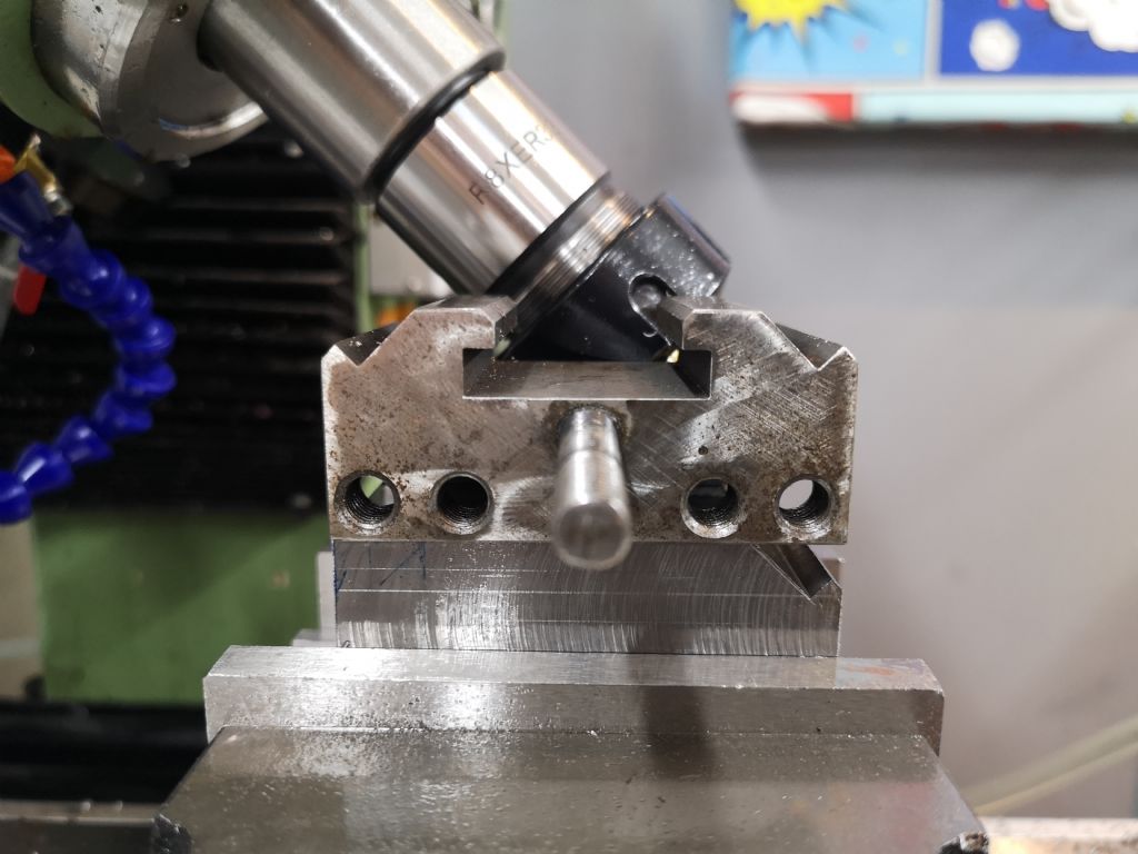

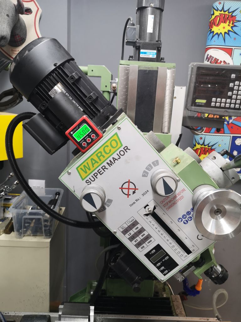

              Tilting the head (first time I did this).
              As you can see, I do not have an accurate way of measuring angles.
              Plan for [Project 86] is a Sine Bar/Plate.

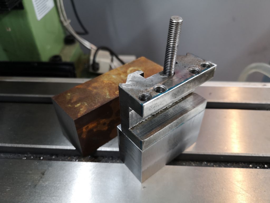

              First cut:
              One side done (look under the OEM Part):
              Both sides done (looks okay to me):

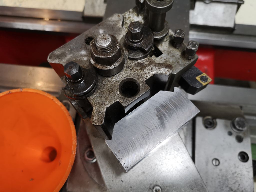

              Offering up to the tool holder. Can't see how it fits until we mill part of the 'T' slot out.
              Edited By Lee Jones 6 on 22/05/2020 08:24:15

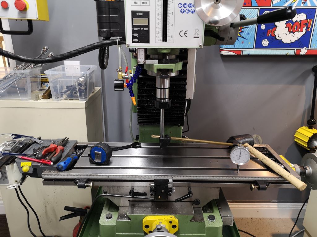

                Tramming the head back in to 0° (vertical):
                How does 0.1mm over 480mm sound?
                So 1mm over 4800mm (4.8m)?

                      Posted by Lee Jones 6 on 22/05/2020 08:21:14:
                      As nobody else has answered from last night I get about 1/10th of that in X&Y eg 0.003mm in 140mm on a Chinese machine.

                        Posted by JasonB on 22/05/2020 12:43:18:
                        I'll go beat it a few more times with a rubber mallet.
                        It was dialed in until I bolted the head down.
                        #473898
                          You just need to see how much it moves when you tighten it down and then set it to compensate.

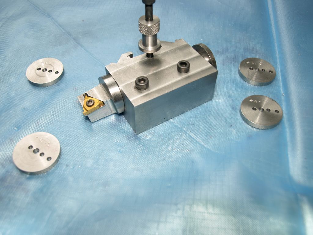

                                  Lee,
                                  Special application as mentioned. Variable angle screw cutting insert holder.
