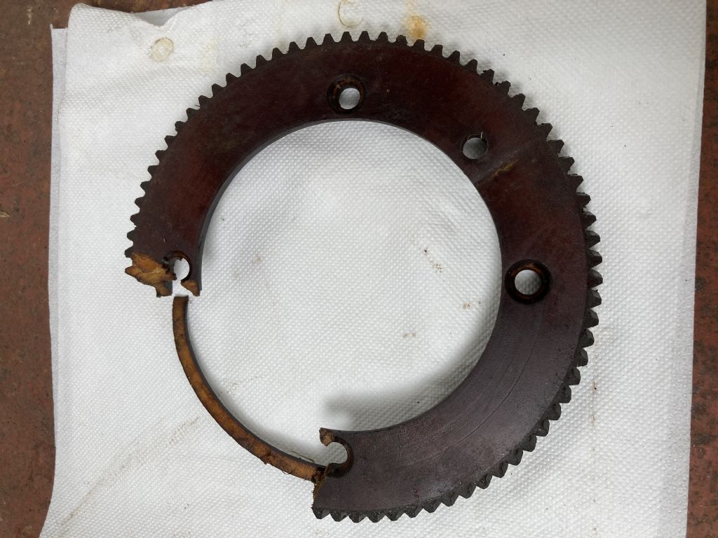

      Hi, Derrick Simpson here, retired farmer. I have a large workshop with a lathe, various saws and lots of tools. Spend a lot of time fixing [i hope] local golf course equipment etc.
      My Progress 2G drill stopped working y esterday and on dismantle found the TUFNOL large gear cog broken. I was hoping someone could advise how and where to purchase another. I dont use this machine often but its so handy for a slow turning drill.

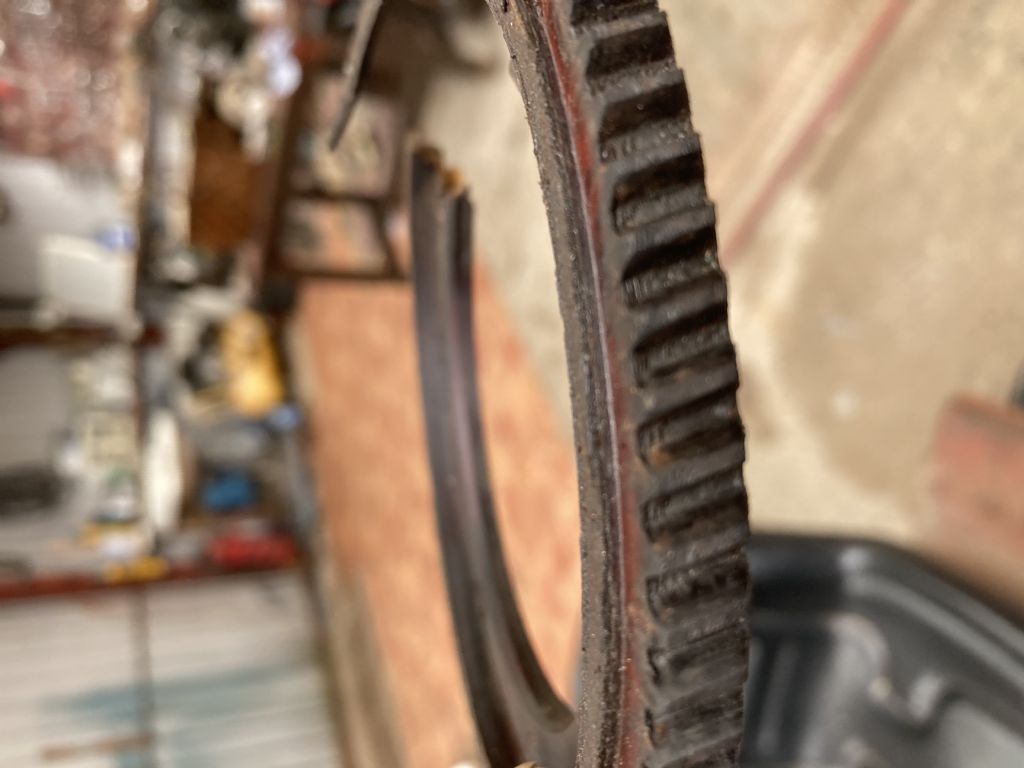

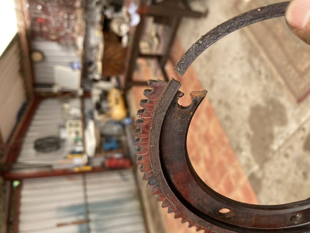

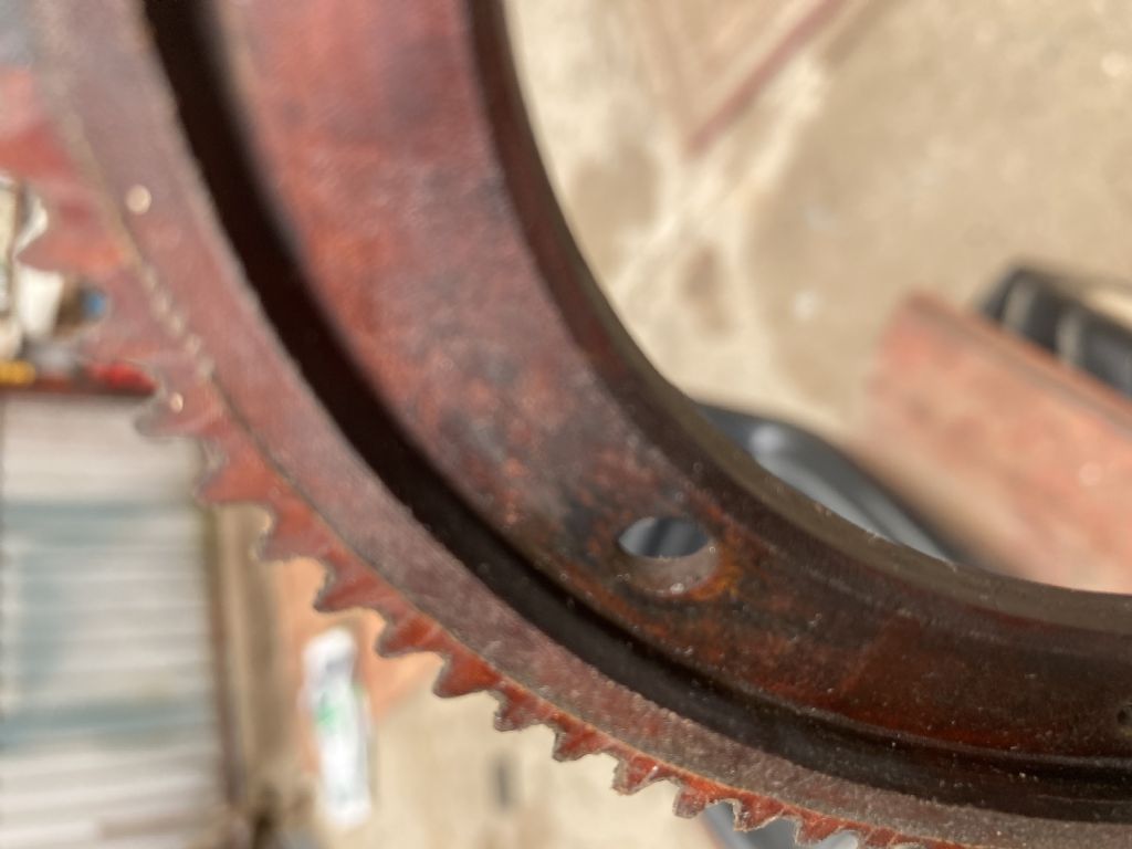

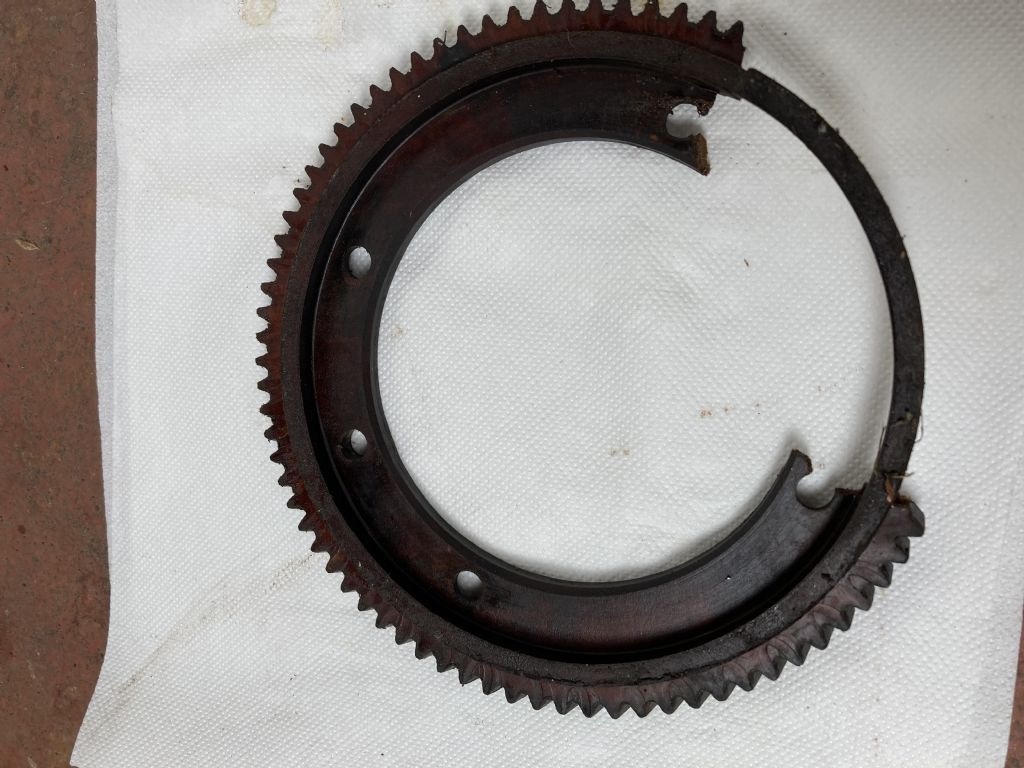

                          The gear construction is unusual and interesting in that there seems to be an internal bracer in the form of a split ring behind the gear teeth. Whether it is meant to be split is not clear, nor what it is made of..
                          Assuming the smaller drive gear to be made in steel, is there corresponding damage to that?
                          I am intrigued by this job, it would make an interesting challenge. I would need to examine it and the broken off pieces in detail before committing myself and cannot consider it anyway before the end of July. Why not send me an email so that we can go into the nitty gritty and sort something out that suits us both?

                                From 20-year-old memories, and thus suspect, I think that the metal hub, to which the gear is dowelled and fixed with screws, has its major diameter as the radial locating face for the gear. The hub fits quite tightly into the recess formed by the remnant of the 'upstand' on the face of the gear. The gear face inside and outside this 'upstand' have been faced down, thinning the clamping face and also the teeth (hope that makes sense). What looks like a retaining ring is the result of the 'upstand' having de-laminated.
                                The tooth width is small enough, I'm sure, to allow the gear to be cut without proper helical form, so the job isn't too bad…

                                  Thanks everyone for your comments and help, managed to get a piece of tufnol from plastic stockist .com, £20.00 delivered. Turned out the shape on my lathe [ i am not an expert] but it seems ok. Balked at the job of teeth so its now on its way to Brian who kindly volunteered to do the job.
