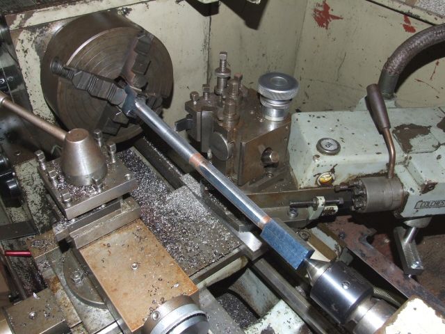

        I was looking at designs of radius turning tools based on boring heads and came across this video. The author (Ade Swash) uses an RCMT 06 carbide profile insert at the business end of the the tool, and it looks like it works well. He also uses the same insert for cutting the relief in the stock for his ball turning demo.
        Hmm I thought, I've got one of those 6mm diameter profile tools (bought when I had only a tiny lathe which couldn't cope with it), maybe it'll work with the bigger machine I have now. It did, once I'd conquered nerves and was assertive with the cross slide, like you have to do with parting.
        Question is – how big a profiling tool can one run on a 'domestic' lathe? I had a look at JB and they list up to 25mm diameter which would be 75mm (pi=3) cutting engagement if plunged to radius. Surely that would need a very big machine? Even 12mm would speed things up for me though if possible.
        I have a 12×36 lathe and I'm working in brass.

          As the width of tool engagement increases you will begin to get chatter. Screw machines could run very wide form tools, Most hobby lathes aren't sufficiently rigid to handle wide contact without chatter.
          The ball tool forces are primarily into the cross slide feed screw. Increased load on the tool will tend to decrease the depth of cut. With a form tool n the toolpost the cutting forces tend to tilt the tool down and to the left, momentarily increasing the depth of cut. That is when chatter begins.
          #425123
            A lot will also depend on material both type and diameter. Brass cuts easily but if too slender the cutting tool will deflect it and more chance of chatter. Stick out can also be an issue when clearance for the ball turner means the work is a long way out of the chuck.
            Your 75mm figure would be if the whole insert were touching, at the most only half will be in contact so 37.5mm and even then as you get further around the tool the depth of cut lessens to nothing.
            This form tool probably had a contact length of 30mm on my 280, stock is 16mm square
            Biggest issue using a round insert as shown in teh video is the large fillet you are left with where the ball joins the stock which becomes proportionally greater as ball diameter decreases and the wide cutting action of the "blunt" round tip will put more load on the work needing a larger dia contact with the parent stock, an RCGT rather than a RCMT would help a bit as the edge is sharper as would going down to a 5mm dia insert to reduce fillet dia and contact length.

                                          If I may just add a little to Dave's analysis: An appropriately located 'Gibraltar style' tool post should optimise the lathe's ability to use form-tools.
                                          Whatever its other merits; the ball-turning device in the video is a fine example of how not to mount a tool if you want to reduce chatter.
