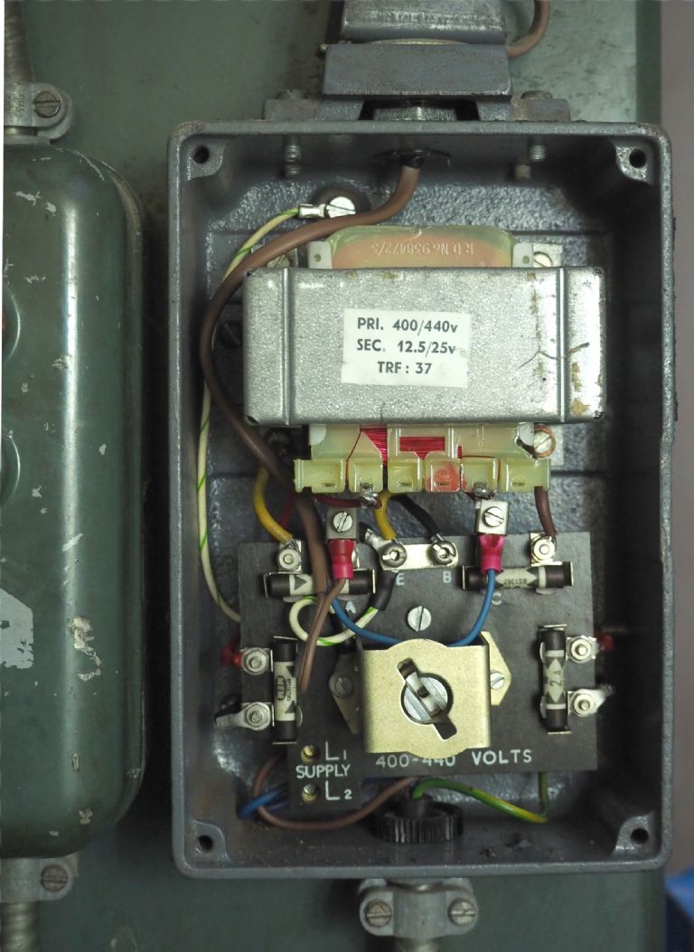

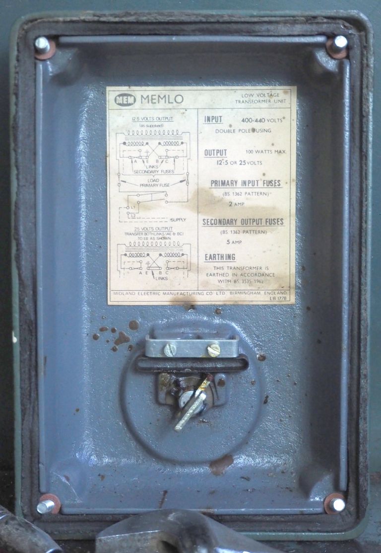

                              Is there a transformer between where the black cable comes out of the bottom right hand gland of the NVR and the lamp ? I think it is very unlikely that the bulb runs directly of 400 volts. (I am making the assumption that the static converter contains a 240 volt to 400 volt transformer and the motor is wired in star configuration for 400 volts phase to phase and not in delta configuration for 240 volts phase to phase.)
                              Les.
                              #396340
                              Emgee
                                @emgee
                                Les, most likely a 400v primary with 24/50v secondary, std fitting on most machines of the that Brook starter era.
                                Emgee
                                #396358
                                Miles Hellon
                                  @mileshellon
                                  Les, Emgee,
                                  The light runs on 24V. There is a 12.5V/25V transformer in the light switch box. With the present wiring, the light does work, but only when the machine is running!
                                  Regards,
                                  Miles

                                        If the light only works when the machine is running I think you have it wired to the output side of the contactor . (The side connected to the motor.) The incoming three phase from the static converter should be connected to the three lower connections (L1, L2, L3) and the motor connected to the three top connections. (A, B, C) If you have it connected with the incoming three phase to the top three terminals I don't see how it could have worked as there would be no power (From L1 & L3.) to power the solenoid. Can you post a diagram of how you have connected it showing which terminals are connected to the three phase from the static converter, which terminals are connected to the motor and how you have connected the start and stop buttons ? (I can't see any wires that look like they go to the start and stop buttons.
                                        Hi Emgee,
                                        I agree that is the most likely way the light would be powered. (That is the way it was done on machines in the factory I worked in in the mid 1960s.) I was thinking it may have been wired with a 240 volt lamp directly to the mains at some point in it's history.
                                        Les.
                                        #396375
                                        Miles Hellon
                                          @mileshellon
                                          Les,
                                          The light is connected to L1 and L2 input terminals. Because L2 is the ghost phase from the converter, I guess it only becomes active when the motor is running. I’ll changeover the light connection from L2 to L3.
                                          Regards,
                                          Miles
                                          #396388
                                          Les Jones 1
                                            @lesjones1
                                            The lamp should be connected to L1 and L3 which are the two phases that feed the solenoid. I think you should put some markers on both ends of each of the red wires so you know which are the real phases and which is the ghost phase.
                                            Les.
