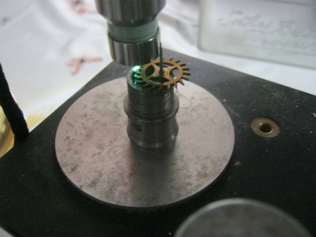

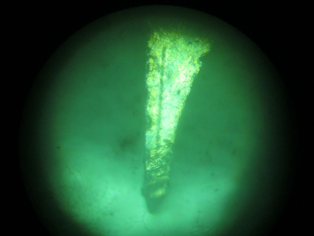

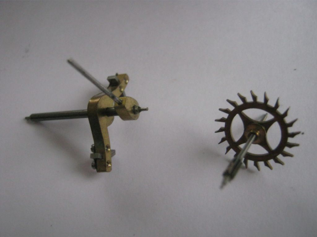

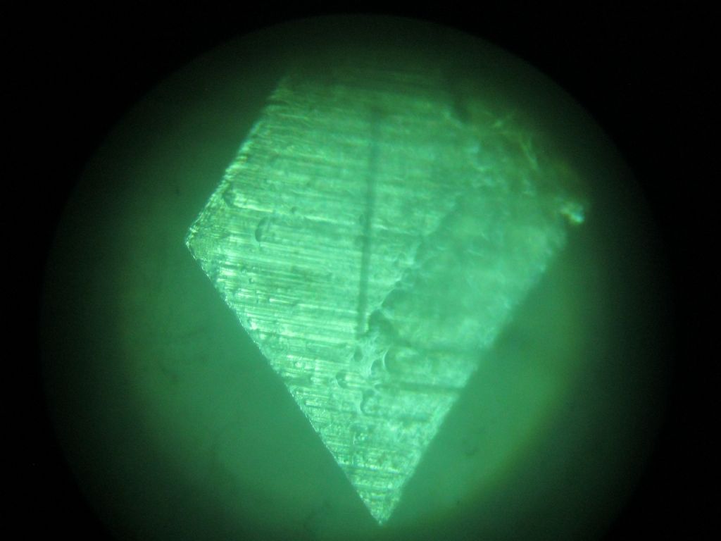

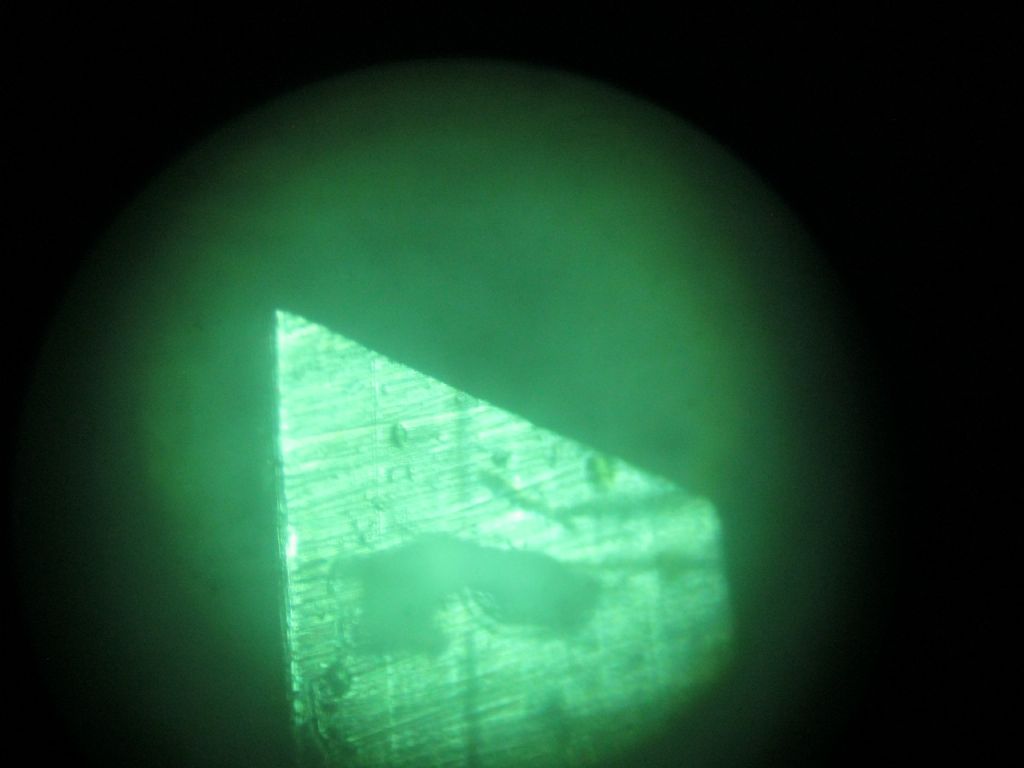

                            #323867
                            Jens Eirik Skogstad 1
                              @jenseirikskogstad1
                              These photo where i took inspection of worned escape wheel under microscope.The teeth on escape wheel is curved instead of straight teeth where the pallets are on contact. Some time the teeth is pressing the palett out of rest position ("in lock" position) and fluttering 6-8 teeth past the pallets periodically. (Escape wheel passes some teeth through the escapement) The Pallets seem ok.

                                #323905
                                  Adequate evidence that you need to buy/make a new wheel [unless you are extraordinarily good at bending the teeth back to their intended shape] … I can't say more, because I don't know if you have read my previous posts.
