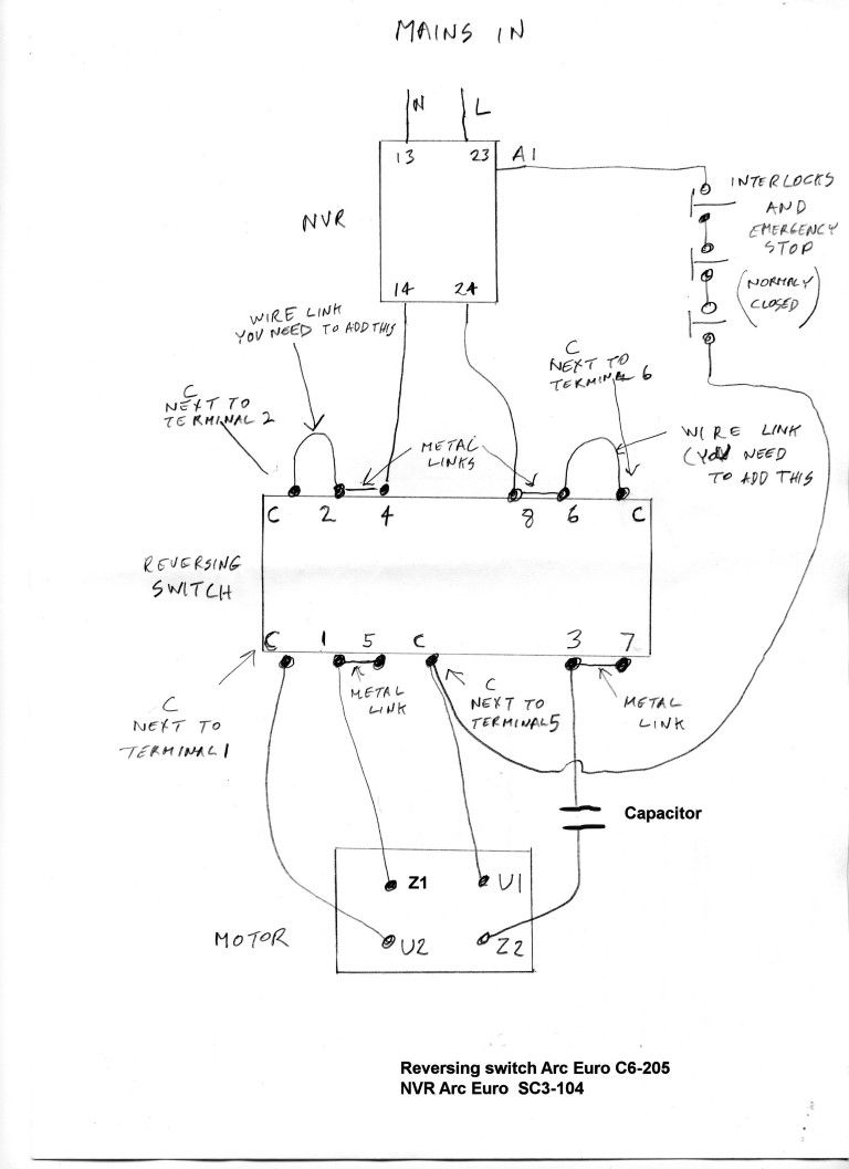

      Hi Graham,
      Here is a slightly modified version of a diagram I drew for another thread ("do i need reverse" 09/04/15)
      The reversing switch was bought from Arc Eurotrade and NVR can be bought from Arc Eurotrade or from ebay.
      If you mount the capacitor on the motor you will need another piece of connector block in the motor connection box.
      I am adding your picture to this post so it is easier to read in future.
      Les.

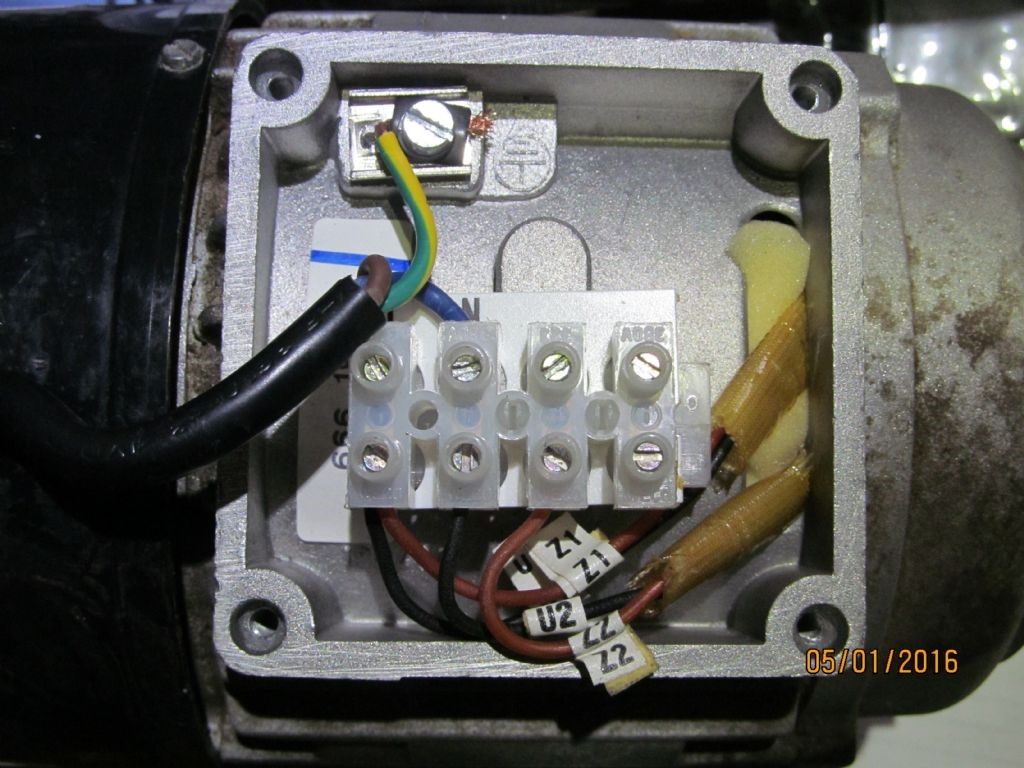

      #220468
      Phil Whitley
        @philwhitley94135
        Hi, Z1 and Z2 are the start winding, is that how you have it connected? The windings are almost always different, usually the start windins is more turns of thinner wire, and hence has a higher resistance than the run winding.

              Hi Les started to assemble it do i run the earth from the motor direct to the 3 pin plug and as i have not a interlock fitted run a wire from A1 toC.Thanks Graham
              #221713
              Les Jones 1
                @lesjones1
                Hi Graham,
                The mains lead will come into the box where the switches are mounted. The earth lead will need to earth that box (assuming it is metal.) , The frame of the machine and the motor. You will probably have to use a terminal block to connect all the wrth wires together. It is impossible to say what the best way is without seeing the machine construction. You are correct that you link A1 to the C terminal next to terminal 5. It is wired that way so that when the reversing switch passes through the off position it caused the NVR switch to drop out. This is to avoid going straight from forward into reverse.
