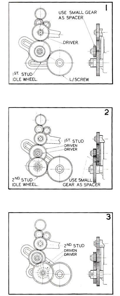

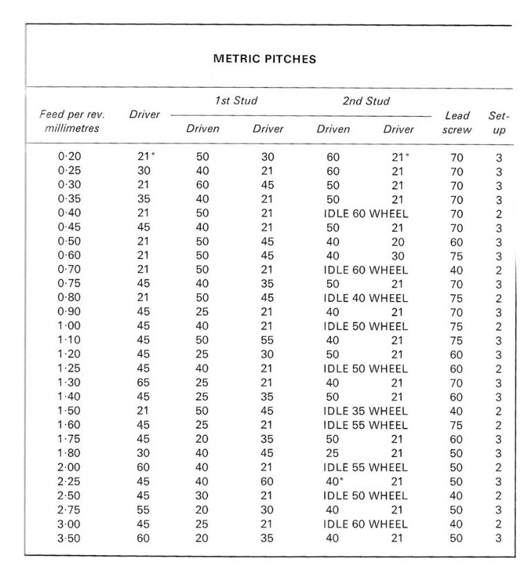

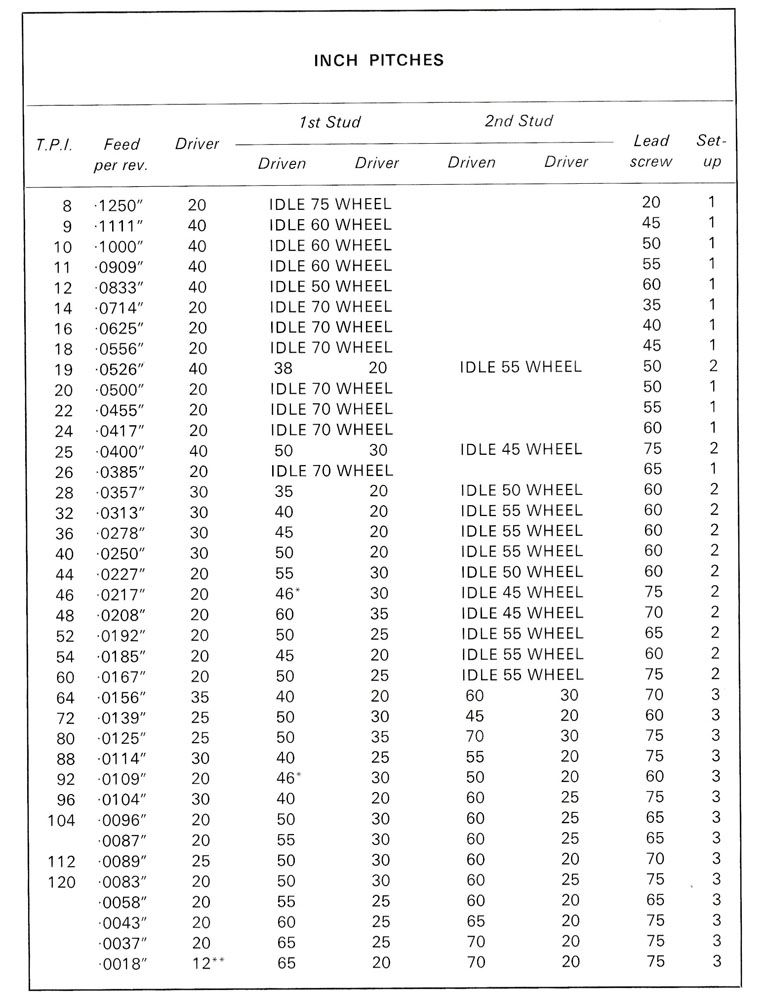

      Please forgive me if I've posted this in the wrong section, though it is in question form but, could someone suggest where I could look for a printable chart of screw cutting gear ratios for my Myford ML7 ? My machine didn't have a table on the inside of the guard as is usual practice. Trawls on'tinterweb have been fruitless

            Guy,
            These are from Bradley's Series 7 Manual:
            HTH,
            Rod
            Edit:  Forgot to add the setups
            Edited By Roderick Jenkins on 03/02/2019 13:08:04

                  I found that the chart in the gear cover was hard to read with the lighting in my shop so I printed it out 8 1/2 x 11, laminated it, and it hangs on the wall behind the lathe were I can read it while standing it front of the lathe.
                  I have it as a PDF file and can send it to you if you pm me your e-mail address. You can then print it out and laminate it.

                        I love the last line in the chart showing what you need for 569 TPI (!!!) Can't think of an immediate use for that..
                        Out of interest, what is the finest thread used on a practical object that is known of?
                        Norm
                        #394808
                        not done it yet
                          @notdoneityet
                          Only the last line? I reckon the last 15 lines are likely never used for threading! Anyone on here cutting threads of more than 60tpi?
                          Question might be: Is 1.8 thou per rev a small enough increment for all power feed uses? I would have though it would be – at least for most jobs.

                              The last half dozen or so lines on the inch chart are intended as fine feeds. I only added the TPI out of curiosity!  120 TPI is UNF 000 and 160 is 0000 but obviously a thread of 569 TPI is a little over the top and not much practical use, at least for the kind of work we do!

                                              Yes your tool will have to be very sharp. The theoretical tip radius for a 569 TPI Whitworth thread is only .000247" and the flat on a 60deg. tool for a UN thread is .000225" wide!    Good luck measuring that, at least with our normal measuring kit.   About all you could do is to sharpen it to as fine a point as you can and as the theoretical thread depth for a sharp Whitworth thread is only .00173' and a 60 deg. one is .0016 there wouldn't be much of a tip load!
