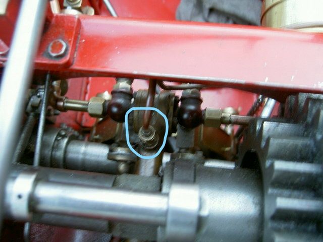

      I was wondering if there is a right or wrong way to plumb in the pressure gauge on my Garrett.
      The drawings indicated that I just tee into the steam supply from the block on the top of the boiler to the manifold that supplies the water feed valves.
      Someone told me (a good while ago) that this would result in an inaccurate readings depending upon the usage of the aforementioned valves.
      I suppose I could just tap into the boiler but I am unsure if this is wise and I am concerned how I would get a steam tight seal on a curved surface. The boiler is steel.
      Any guidance would be much appreciated.

          The measured pressure can be affected by the flow of fluid (gas or liquid) past the tapping point. It may be this that was being referred to. You need a tapping point where there is either no flow or constant flow past it to avoid this issue. Without knowing the system you are looking at I don't know if this is a valid reason to consider.

                  On the 3" scale Marshall traction engine the Pressure gauge feed is taken from the manifold on boiler top that supplies the injector and water lifter valves as in picture.

                    Many thanks to everyone for your comments.
                    I am going to plumb it into the manifold on the boiler top.
