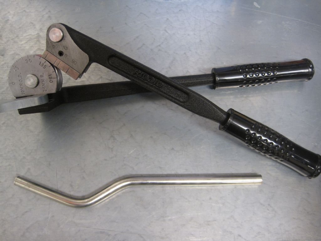

        I am looking at having to form two bends in a number of lengths of stainless tube, 10mm dia by 2mm wall. One or two is fine and easy using a pipe bender, but I have to produce 10+ all exactly the same. Any ideas on how I could do this? Some sort of jig?

          Not difficult to do, but without knowing what bender you are using, what angle the bend (or bends) are to be, how far the bends are from each other (and whether they are in the same plane it not possible to say how to do it. How much 'precision' does your application need?
          If it was something simple like a 90 degree bend just creating an 'L' shape then put the bend anywhere and trim the two legs to length.
          Ian P
          #172336
          Speedy Builder5
            @speedybuilder5
            You make the first bend and then place this against some form of a STOP before you make the second bend. If the second bend is not in the same plane as the first, then you may have to make a jig to hold the tube. You can't rely on pencil marks in my experience.

              Difficult to say but I think that the bends will need to be within 0.5 – 1 degree of each other. Both bends in the same plane. One of 30 degrees and then 35-40mm along second bend in opposite direction to the first, 15 degrees.

                  It is a Ridgid 400 series level instrument tube bender. Fairly bog standard tool in hydraulics work.
                  #172355
                  Carl Wilson 4
                    @carlwilson4
                    What I've been thinking is to set the bender up on the mill table, then have a series of stops to locate the length of tube. Further stops to indicate when the bends are complete.

                              Well, the pipe bender was easily able to bend the 10x2mm tube. Here is a rough example of what I'm going to do. Only another 30 or so to go…

                                I presume that the most critical/precision aspect of the part that you have to get right is the is the angle between the entry and exit straight sections? with the centre section length and its two angles only having to be visually similar.

                                  There must be some "wiggle" room on the final assembly to ensure the tube ends are in the correct position to each other for welding / brazing to the component(s) it attaches so it may be that the bend centres to each other are important and that in one plane, the pipe is flat (You already told us that)
                                  Instead of allowing the bender to "Float" it is after all a "Site" type bender (Two handles), fasten the side with the circular former down onto some for of fixed plate (Mill table is brutal to the mill) and after effecting first bend, turn pipe end for end to a fixed stop and clamp pipe to stop lateral rotation after ensuring the bend is flat and bend the second angle.
                                  DON'T try to bend it in your hand, fixing the bender down is the clue.
                                  Bet you only manage to waste ONE as a pattern. Don't get complacent when you're shelling them like peas.
                                  Regards Ian..
                                  EDIT. Forgot to mention, However many you have to bend, put one bend in the whole batch FIRST, then go for the second one rather than complete each one individually (Sorry if it's sucking eggs)

                                    Thanks Ian and Circlip for taking the time out to post. As I mentioned I always clamp one side of the tube bender in the vice. I can manage three shredded wheat, but I can't bend 10x2mm 316 tube freehand without a series of jerky movements, which are not conducive to neat, repeatable work!
                                    A good idea to do the first bend in the whole batch, then the second. Mill table would indeed be brutal; I have a table that I can mount stops etc on that I usually use for TIG welding.

                                      Pardon me for stating the obvious.
                                      Unless the stock is expensive…
                                      Since the part between the bends is the critical length..
                                      With bender bolted down to act on say horizontal plan .add board to behind and near said plane…add such blocks as to provide stops…for length and angle
                                      Do first bend…to required parts..plus a few…
                                      Add/ remove stops for next bend…..
                                      Do second bend…
                                      Trim in and out lengths as required….
                                      The latter allows extra length for ease of stops etc. .make from over long if needed to get stop out of swing area…

                                          And the important aspects are the similarity of the two angles and the distance between them.
