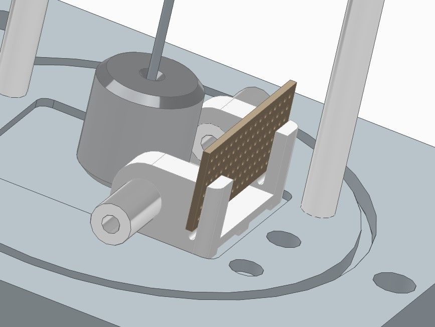

                                    I don't! This is the latest design:
                                    Scale: about 300mm tall, the bob is 25mm diameter, the base 140 x 140mm.

                                        Unless you are completely satisfied with whatever residual horizontal movement is in the hinge area, why not add some cross-bracing in the direction of the swing?
                                        #637402
                                          Posted by S K on 12/03/2023 18:17:03:
                                          Posted by SillyOldDuffer on 12/03/2023 18:06:31:
                                          I probably will, the pillars just need some small holes drilled in them to take wires I can tourniquet tight to cross-brace the verticals.

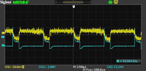

                                          On another tack, I've attempted to capture the shape of the magnetic pulse emitted by my electromagnet, which I expect is typical. Not brilliant because my Hall sensor (A1302) is deaf as a post but:
                                          The noisy yellow line is the strength of the magnetic field. The blue line is voltage across the magnet, which for the test is fed through a 220ohm resistor, so the blue curve is proportional to current.
                                          There's a sharp current spike when the pulse starts, and it drops rapidly as current flow is resisted by the magnet coil's inductance. When the pulse ends, the magnetic field collapses causing a negative going kickback, which, as can be seen, is clipped at about -0.6v by a protective diode across the coil.
                                          Field strength is proportional to the current flowing in the coil and how far away the bob is, and both change during the impulse. My maths is terrible, but should be possible to graph how the strength of the magnet field varies as the bob flies through it. My feeling is the two interact to soften the jolt, but I could be wrong!

                                              Some form of low-pass filtering could help with those sharp edges, which can't be that great for the pendulum's performance.
                                              I'm far from an analog guru, but I suspect John would be able to provide some guidance, perhaps even a step towards that proposed raised-cosine profile.

                                                    Great minds must think alike because I'm worrying about coil rigidity at the moment. In the Mk1 clock, the sensor and magnet carrier, which I'm now calling the 'chariot', was 3D-printed and hot-glued to the Aluminium base. The electromagnet is from a 5V miniature relay, of the type found in Arduino modules:
                                                    The Mk4 design is similar, except the chariot is going to carry the electromagnet, BME280 sensor, and IR beam electronics on a stripboard clipped at the back. The electromagnet is mounted side on to the bob, not underneath.
                                                    The chariot was going to be glued, but I think a screw into the base would be better. The chariot slides along the base to adjust the position of the beam relative to the bob, before being clamped so the chariot will have to be slotted to .
                                                    Of concern are two design changes:
                                                    • I've increased the size of the mild-steel bob to about 90g rather than 40g, requiring a more powerful impulse.
                                                    • The base is now cast-iron rather than Aluminium. In the Mk1 the only ferro-magnetic object near the coil was the bob, now the base is too!
                                                    So the chariot and stripboard have to resist a horizontal pull towards the bob, and a down pull towards the base. I think the stripboard is likely to flex unless I reinforce it, and the 3d printed chariot is none to solid either. On the other hand, the impulse required to swing a 90g bob is small.
                                                    Now if only I had a big block of Brass to make a non-magnetic base! Being a cheapskate, I have to make do with what I've got.
