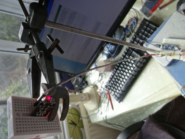

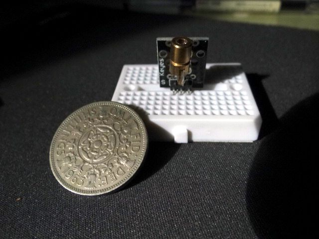

            Changing the subject slightly, I've been looking at a Keyes Laser module with a view to using it in a beam break sensor. The red beam is much sharper than an IR LED, and it's detected OK by an IR photo-transistor, but it's extremely bright, likely to cause trouble inside the pendulum case due to multiple reflections.

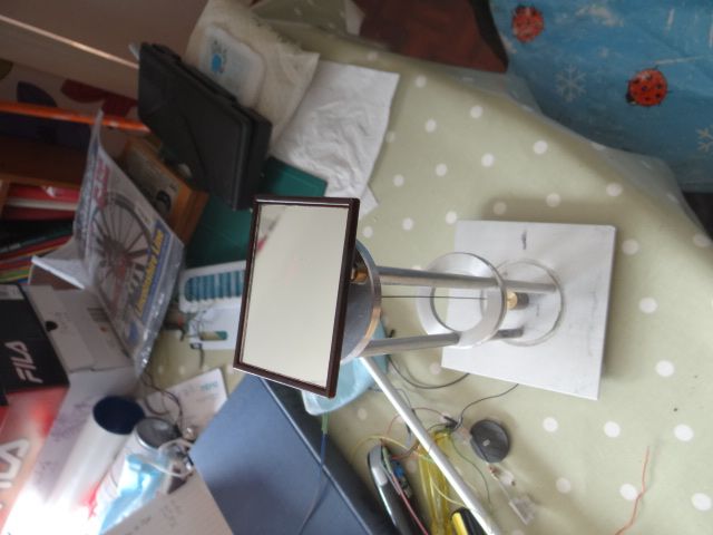

            Whilst it was powered up, I grabbed the opportunity to see if my Mk1 Pendulum tripod is vibrating by bouncing the laser beam off a mirror.
            The laser module was held in a chemical clamp-stand:
            And the beam arranged to bounce off a mirror laid on top of the tripod:
            So that the spot hits the ceiling about 6 metres away:
            Then the pendulum is set swinging about 15° and the spot examined. It could just be seen to move in time with the pendulum, about a millimetre. The test shows the tripod assembly, total weight 571g and on rubber feet, is moved slightly by a bob weighing 40g.
            Not much, but my tripod moves…

              Disappointing — Yes
              Surprising — No

                Dave, would reducing the length of the pendulum and the whole structure add to it's stability ?

                  It would, but the pendulum would speed up, a 50mm rod vibrating at about 0.45s
                  Interesting idea which I hadn't thought of at all – a short squat clock, about 80mm high beating at about 0.5s. Perhaps one of the experts will know, but I can't think of an obvious reason for insisting on a long rod.
                  In a mechanical clock, I guess there's practical advantage in a long slow pendulum, such as making it easier to set the period to exactly 1s. But my clock doesn't care what length the pendulum is, and could beat much faster.
                  I went for a pendulum rod of about 170mm because it was about the right size to fit into a 67mm pvc drainpipe without it being too tall. I went for a ratio of height to base diameter between 3 and 4 to 1, not very scientific!
                  Now I'm wondering how a short fast pendulum would perform as a precision time-keeper. Unless someone explains why it's a bad idea, I shall have to try it.

                    Every pendulum support will move (Newton had something to say about it). The only question is by how much. I presume you have set it up to amplify the motion? Have you calculated the amount of motion right at the pendulum, and for a more realistic amplitude?
