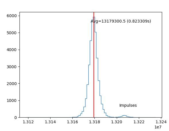

          Posted by John Haine on 01/03/2023 09:34:14:
          Posted by Mason Green on 28/02/2023 23:23:58:
          Posted by John Haine on 28/02/2023 10:27:08:
          Essentially over a long period of time the pendulum is self-correcting despite the random forces acting on it.
          –MG
          I'm not sure to what a pendulum clock can "self correct" over a long term. At any instant it has a state completely determined by its history and what happens next depends on that state and how its environment behaves.
          I understood Mason's comment to mean that pendulum period varies as it responds to changes in the environment, which can be compensated for, but also randomly, resulting in noise. A pendulum "self-corrects" in the the sense that many instabilities cancel out on average.
          A 1 second mechanical pendulum, no matter how well made, does not deliver exact 1 second periods. Periods are always slightly different, but cluster around a median, like this example from my clock. The vast majority of beats are near the median, but a proportion are distributed either side, with extreme variations becoming increasingly rare. The steeper the peak the better – high Q – but, even if the pendulum is fully compensated, there is always some variation, or noise. Any frequency that''s not exactly average is noisy.
          impulseca.jpg.
          On average, the pendulum keeps time, but the period of individual beats vary. Deviations to the right tend to balance out deviations to the left over time. A well-made pendulum delivers good long-term stability by averaging out noise, even though the pendulum's short-term stability could be relatively poor.
          Nonetheless, it's desirable to improve short-term stability as well. As I understand it Allan deviation measures and identifies the types of noise, so it might be possible to reduce or engineer them out. Worrying about noise is precision clock territory! An example: Invar is an Iron/Nickel alloy that doesn't change size as temperature varies. It's excellent for making pendulum rods. But looking closely at Invar rod clock performance shows Invar is far from perfect! When measured at high resolution, it turns out Invar is unstable at the molecular level, causing minute physical changes that change the pendulums period slightly. The instability can be reduced by heat ageing, but Invar isn't perfect, and maybe another material like quartz, might do better. But fundamentally, everything the clock is made of is a bit unstable.
          Therefore, I don't agree with John's: "At any instant it has a state completely determined by its history and what happens next depends on that state and how its environment behaves". However the difference of opinion is tiny, because my version is: "At any instant it has a state almost entirely determined by its history and what happens next depends on that state and how its environment behaves"
          Edited By SillyOldDuffer on 01/03/2023 11:35:05

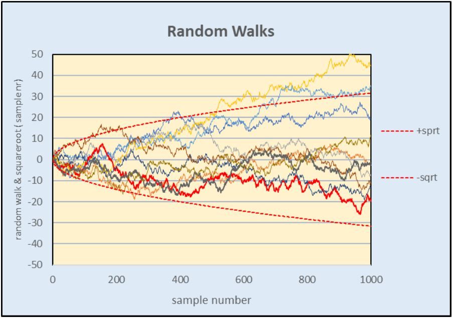

                      A very interesting article in the latest HSN included this plot.
                      Generated in a spreadsheet by having a small random variable that can be + or – added to a running sum in each row. 10 runs each with a different starting seed. If you look at any single run it may tend towards zero at some point but later will diverge away and may come back again. Over a long period if you look at the rms "error" from zero over all the runs it grows as the square root of the number of runs. Many clock errors are like this, there is no tendency to "cancel out" over a long period.

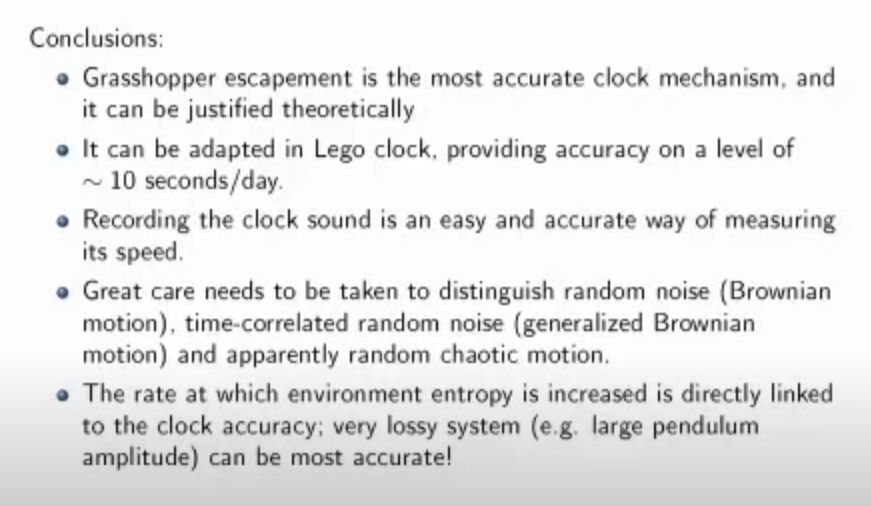

                                Posted by Mason Green on 01/03/2023 14:26:33:
                                From Ziemkiewicz's lecture on YouTube:
                                YouTube Link
                                His analysis reveals the pendulum period error is not a simple gaussian random walk, but rather follows a Maxwell-Boltzmann distribution:
                                YouTube Link
                                "Interestingly the error function is a fractal that resembles the trajectory of Brownian motion… further details reveal it is not pure Brownian motion, individual "jumps" are slightly correlated"
                                "pendulum has a memory"
                                His previous paper is also an interesting read:
                                "Numerical analysis of grasshopper escapement"
                                But, a wise man once told me to never waste my time trying to convince anyone of anything on an internet forum, lol.
                                Not really a question of conviction, more about me gripping the point and how the hypothesis might make a difference to what I'm doing. If I've learned anything from my experiments it's that clock stuff is hard to measure AND difficult to understand. Misled myself on many occasions, and am probably doing it now!
                                No disrespect to Professor Ziemkiewicz, but looking critically at his conclusions:
                                • 'Grasshopper escapement is the most accurate clock mechanism'. Maybe the most accurate mechanical mechanism, but not proven its the most accurate, yet! Harrison's fiendishly clever ideas look excellent to me, but no one pursued them. None of the world's best pendulum clocks used the system, though it' true recent examples have done well. I emboldened mechanical because it's not necessary for a pendulum to have an escapement at all, and there's a strong case that no escapement is best.
                                • The Lego clock is impressive in it's way, but it's full of noisy mechanical imperfections. Although indicative, they may be confusing the conclusions.
                                • 'Recording the clock sound is an easy and accurate way of measuring it's speed'. Up to a point, but the pendulum itself is silent. The acoustics are generated by the escapement, which isn't exactly synchronised with the pendulum. (I don't believe the pendulum was measured relative to the noises off.)
                                • 'Great care needs to be taken…' Absolutely! For example I could claim my graph evidences a Maxwell-Bolzmann distribution and have a few even more convincing examples. Only problem is, I'm pretty sure my skewed graphs are due to over-impulsing. The curves look Brownian, but aren't. Looking at other data reveals my clock has a correlation between the degree of skew and impulse power.
                                • 'The rate at which environment entropy is increased is directly linked to the clock accuracy; very lossy system (e.g. large pendulum amplitude) can be the most accurate.' An interesting observation, but again 'not proven' I think. For example, on my clock, over-impulsing can do horrible things to the pendulum without damaging the time-keeping in the long-run. The reason I suspect is large amplitudes work provided they're consistent, not just because they're big. Small consistent amplitudes work too.
                                Certainly not saying the whole idea is hopelessly wrong, far from it, but to be convinced it's proven, I think we need more evidence that all the other possibilities have been eliminated?
