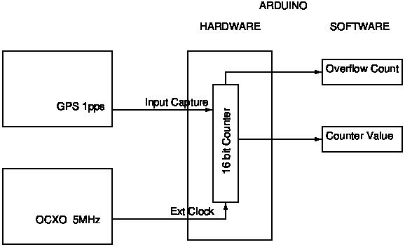

                            Should have provided a diagram! The set-up is intended to measure the frequency of a 10MHz OCXO, actually divided by 2 so the output is 5MHz.
                            Works like this:
                            A 5MHz square wave is fed from the OCXO into the external clock input of an Arduino counter timer. The counter is a hardware peripheral built into the microcontroller.
                            The GPS, outputting 1 second pulses is connected to the Counter's Input Capture Pin. Nothing happens until the GPS outputs a RISING edge, at which point the counter is incremented each time the OCXO pulses.
                            This continues until either:
                            • The counter overflows after 65535 pulses. When this happens, the counter resets to zero without stopping and sends an interrupt. The interrupt is detected by my program, which increments a variable. The variable counts overflows, and these occur every 0.0131072s at 5MHz.
                            • The GPS sends a second RISING edge. This copies the counter to a register and sends a different interrupt to my program. When received, the program knows a GPS second has passed, how many 5MHz pulses have been counted since the last overflow, and how many times the counter overflowed. So pulses received in 1 second = 65535 * overflows + last counter value
                            The reference is standard GPS seconds, and the OCXO's output is counted as an integer. The program actually counts 10 seconds worth of pulses, hence 4999991211, most of the time, sometimes varying by a single digit, rarely 2.
                            No pendulums involved, standard 1 second GPS pulses, and no floating point arithmetic.
                            Explaining it has given me an idea – watch this space!
                            #634836
                              Posted by SillyOldDuffer on 24/02/2023 21:22:49:
                              How embarrassing is that. Looks like I made a silly mistake in the maths.
                              I said: pulses received in 1 second = 65535 * overflows + last counter value
                              Should be: pulses received in 1 second = 65536 * overflows + last counter value
                              Now the Arduino counts 49,999,907 pulses in 10 seconds from the OCXO, which is much closer – wrong by 0.93Hz
                              Dare I touch the trimmer?

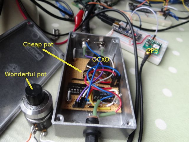

                                    #634862
                                      Disaster! I turned the pot slightly last night and the OCXO jumped to it's lowest frequency and stuck. I guess the wiper arm has come off the track. The pot is an un-shrouded crimped paxolin construction of the cheapest sort, and I shouldn't have used it in the first place.
                                      As the closest frequency to 5MHz was produced at full travel, I might get away with hard wiring the OCXO trim pin to 5V.
                                      The temperature behaviour of the OCXO is mildly interesting. Switched on from cold, the oven powers up and the case becomes hot to touch. The unit briefly outputs rubbish, then a frequency close to 10MHz appears. The datasheet says allow to settle for at least 30 minutes before trusting it.
                                      I have the OCXO mounted inside a die-cast metal box, which I expected to warm slightly as the air inside insulated the OCXO. In practice, the outer die-cast box gets distinctly warm during start-up, but cools down after the OCXO has been running for 15 minutes or so.
                                      I thought the oven would simply heat the crystal to operating temperature, when a simple thermostat would cut or apply power to the oven as necessary to keep the temperature stable. Like a domestic immersion heater. I guess the OCXO actually starts by heating beyond operating point for some time to thoroughly warm the crystal, case, and immediate surrounds before stabilising at operating temperature.
                                      Nothing about precision pendula is easy!

                                          #634890
                                            Posted by duncan webster on 25/02/2023 10:23:36:
                                            Why does the exact frequency matter? As long as you know what it is, and it is stable, you can allow for it in the sums. The astronomical guys used to do this I think.
                                            I've got loads of those little 10k pots which look like they have a worm drive, if you want one shout.
                                            Yes please to a little worm-drive trimmer – one of them will go inside the box with no bother, whereas fitting the nice pot requires major surgery.
                                            The exact frequency matters because the OCXO is intended to be a reference standard, against which lesser clocks will be measured. Makes life easier it's accurately on frequency.
                                            Michael raised the problem of how to know what the OCXO frequency actually is. Yes indeed! Done by comparing the OCXO with a more accurate time standard. The two methods I've attempted are:
                                            • By dividing the OCXO output by two, and then counting how many pulses it emits in 10 GPS seconds. This assumes that the divide by 2 is always correct, which it probably is; that the Arduino counter never misses a pulse or miscounts due to glitches; and that the PPS output of my GPS module is more accurate than the OCXO. I believe it is, but note John's comments above. There's a version of the GPS chip I'm using that's optimised for time measurement, the M8T, but I couldn't find one mounted on a breakout board. I don't have the technology or skills needed to solder sub-miniature devices.
                                            • Comparing the 10MHz signal directly with the WWV time signal broadcast on 10MHz shortwave. One way is to beat the two signals together to get an audible tone, and then tune for zero beat. Doesn't work well, partly because my human ear struggles to detect below about 30Hz, even if the communication receiver's audio system wasn't chopping off below about 300Hz, making it difficult to use an oscilloscope to detect zero beat. Not tried yet, but a better way seems to be to feed the audio beat into a FFT analyser, which shows very small frequency differences visually. A major problem with WWV is the signal fades in and out and is always weak. Although the frequency is rock solid, it's hard to use.
                                            All this is analogous to workshop, tool-room and calibration accuracy. To check a workshop micrometer, one needs a 10x better standard, which a tool-room typically works to. In turn, the tool-room works relative to calibration standards, which are 10x better again. And they're derived from even more precise metrology standards… Going up the hierarchy, achieving an appropriate level of accuracy gets exponentially harder. Not difficult I find to fashion metal within a thou, whilst getting tenths accuracy takes much more care, and considerable uncertainty about the results because they are hard to measure accurately and reliability.
                                            Some aspects of what I'm doing with my toy pendulum are taking me into the time equivalent of tool-room territory. I admit it's as much out of interest as necessity!
