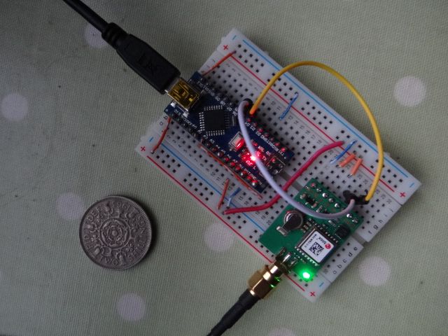

                    This post is overflow from my experimental pendulum thread where Joe Noci recommended using a ublox GPS module as a high accuracy signal source. Many GPS modules, not all, provide a one pulse per second output that can be used to calibrate a pendulum. Many of the ublox range go a step further by allowing the user to set the pulse output to any period. This is very handy, for example I need an accurate 10MHz signal, and other frequencies.
                    For hobby work it's convenient to avoid sub-miniature soldering by buying GPS module already mounted on a breakout board. Mine is a Uputronics uBLOX MAX-M8Q Breakout for Active Antennas – 5V from Pi-Hut, because I shall mainly use it with 5V Arduinos. The 3.3V version is better for microcomputers that run at that voltage. Level converters are cheap.  If the 5V version is bought, the EN pin should be jumpered to 5V.

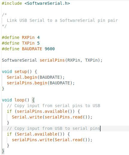

                    Photo shows the GPS module connected to an Arduino Nano programmed to convert TTL serial output to USB: a converter cable does the same job. The Arduino program is simple:
                    When the Arduino is plugged into a computer it registers as a serial device that can be read by any suitable program.
                    Change frequency, I downloaded u-center 22.07 from ublox. Installed OK on my Windows 10 laptop but not my Windows 10 workstation. I understand the problem, MSCVR202.DLL is missing, but haven't managed to fix it yet.
                    u-center is intimidating! However, frequency is changed by selecting 'Configure', then 'CFG', then 'TP'. This opens a dialogue allowing frequency to be changed. It's a bit quirky: tick 'active', then change frequencyPeriod AND frequencyPeriodLock. Press the send button. It may be necessary to toggle the active tick box to get the change to take effect. Apologies if the configure instructions are misleading, I experimented briefly and may be doing it wrong!
                    Manuals:
                    M8 Receiver Description including Protocol Specification
                    MAX M8 Series
                    Will write a program to simplify frequency changing so watch this space.

                      Dave, is u-centre a "suitable program" or does one need to have a terminal program running too please?
                      Edited By John Haine on 18/02/2023 20:28:26
                      #634053
                      Joseph Noci 1
                        @josephnoci1
                        You only need U-Centerand a serial or usb to serial to the GPS, is all. If your GPS is one with Flash, you can write the setup to it and it will be sticky and come up like that on power up.
                        #634056
                        John Haine
                          @johnhaine32865
                          Thanks!
                          #634059
                          Joseph Noci 1
                            @josephnoci1
                            Select the correct port, and baudrate ( usually 90600) ( 2nd line from top. left of screen).
                            The select VIEW, then CONFIGURATION VIEW, the scroll down on the left to TP or TP2 to set up the Frequency on the pps pin. Then lower left of that screen, make sure the yellow lock is unlocked, and click on SEND…
                            #634069
                              u-center is the easiest way of I've found so far. There's also ubxtool on Linux which works with the gpsd daemon.
                              NMEA output is in ASCII and can be read with a terminal emulator. However, UBX, used to send and read configuration data, is binary. It needs a program like u-center to encode and decode it, not a terminal emulator.
                              I'm writing a program to simply send change frequency commands and have hit a problem. It's that I can't get the UBX-CFG-TP5 specification on page 272 of the "u-blox 8 / u-blox M8 Receiver description including protocol specification" to exactly match the hex dump from u-center. I think the spec says rfGroupDelay is a 2 byte integer when it's actually a 4 byte integer. Or I'm reading it wrong! Any experience of this Joe?
                              When I get it right, sending the magic hex incantation:
                              B5 62 06 31 20 00 00 01 00 00 32 00 00 00 80 96 98 00 80 96 98 00 00 00 00 80 00 00 00 80 00 00 00 00 6F 00 00 00 55 7A
                              to the chip should set the M8Q to 10MHz with a 50% duty cycle. 10000000 is the little-endian sequence 0x00, 0x80, 0x96, 0x98
