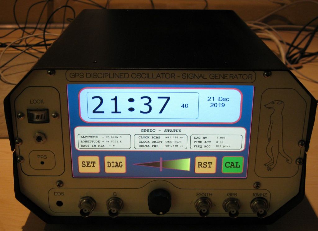

                  The GPSDO 10MHz disciplined oscillator output is gated with a signal from a counter that divides said 10MHz down to a 0.5Hz pulse. The pendulum pulse , a rising edge every 2sec , enables that counter array.
                  So, on the first pendulum rising edge, that counter counts down 2sec, which then enables the gate above. That gate feeds another counter array which also generates a 0.5hz train. That train feeds the TDC START. The pendulum 0.5Hz 'train' feeds the TDC STOP. at this point, the two 0.5Hz trains are 'almost' coincident and within TDC mode 2

                    Oh, I see, you have a GPS disciplined oscillator? Nice! Can you provide a link to it? Thank you.

                      No link I fear, as both of mine are home made…One using an osc from a defunct HP Cesium Beam reference, the other a new, very good OCXO from Golledge in the UK.
                      Can only give you photos and circuits…but we must do so on another topic or email, etc…
                      Here's one..
                      #657379
                      S K
                        @sk20060
                        Very nice indeed! 🙂

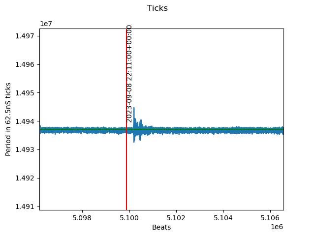

                                                  Posted by S K on 09/09/2023 16:17:06:
                                                  …That's not very good news, actually, as it speaks to a pronounced negative impact of the environment on a non-enclosed pendulum.
                                                  Isolating a pendulum from the environment is difficult. This graph is from my clock's log just after the severe earthquake in Morocco at 2023-09-08 22:11Z. The epicentre is about 2400km from me. Might be a coincidence, but I think it caused my house to wobble.
                                                  #659765
                                                  S K
                                                    @sk20060
                                                    Yes, that's quite likely due to that very serious and tragic earthquake.
                                                    If someone else here has similarly-good reference timing, you might even triangulate it.
                                                    #659785
