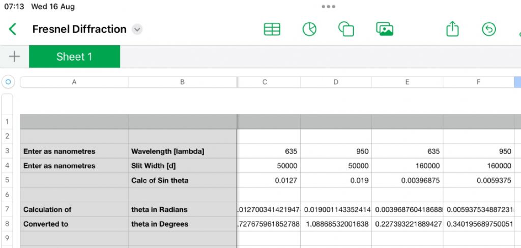

                There is a useful and reasonably ‘accessible’ explanation of Single Slit Optical Diffractions by Olympus, here: **LINK**
                https://www.olympus-lifescience.com/en/microscope-resource/primer/lightandcolor/diffraction/
                The formula given there is, I believe, a practical simplification of some ‘hard sums’ …
                Edited By Michael Gilligan on 16/08/2023 06:41:15

                    Regarding the slits … Could some kind soul please check my homework ?

                        That Olympus web site makes a false, or at least over-simplified, claim or two. It's not the case that if a slit is wider than the wavelength of light then the light passes without any diffraction. Every photographer, with their macroscopic irises, sees this in practice. In fact, even one edge (no "slit" at all) will cause diffraction.
                        #656741
                          Posted by S K on 16/08/2023 13:09:09:
                          … Which is basically what I had in mind when I suggested that your ‘slits’ might be too wide to be acting as slits angel
                          The big difficulty is choosing exactly the right few words, on a lively forum, to succinctly convey what one is thinking.

                            I haven't explicitly checked your math, but the results look reasonable (and of course it shows that diffraction is occurring).
                            #656750
                              Thanks
                              I will proceed with what I was hoping to do … and only sulk if the maths proves to be wrong after all wink

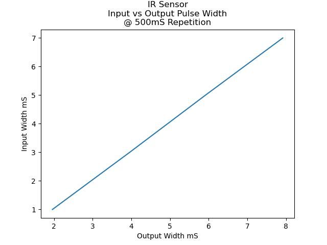

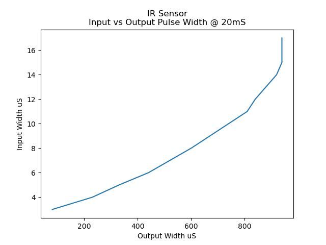

                              #657269
                                I set up an experiment to test the performance of the Arduino Infra-red Obstable detector I'm using to measure the period of my pendulum. One of these modules, with the photodiode and IR LED extended on leads:
                                The test set-up is a 100MHz oscilloscope and a 60MHz Function Generator. The Function Generator is set in pulse mode, and it's output was connected to an MPSA06 transistor used to switch the IR LED on and off. To keep light out the IR LED and IR sensor were mounted inside a brass tube made on my lathe. (It's not all electronics!_
                                The arrangement lets me pulse the IR LED over a wide range of pulse widths and repetition rates and to measure how accurately the comparator responds to the detected signal.
                                Results are more complicated than expected.
                                The shortest input pulse that can be detected depends on the repetition rate, this graph is for input pulses repeating every 20mS:
                                Although the comparator switches on quickly, 9.4uS after the transistor base is switched, it can take a long time to turn off after the input pulse ends. Next graph for slower millisecond pulses repeating every half second:
                                Good news, no no sign of noise being introduced by the IR beam. Next step is to break the beam with a real bob and look for noise due to diffraction as the bob flies slowly through the beam. And to buy a Sharp opto to see how that fares.
                                Bad news, that the comparator stretches pulses means my relative amplitude calculation must be off because the sum is based on the length of time the beam is broken. Probably harmless because relative amplitude is only used to detect an arbitrary trigger point.
                                In doing the experiment I noticed yet again that sunshine causes real trouble.
                                Conclusion: the beam sensor is flawed, but not badly enough for me to rush to upgrade it. The way the beam sensor misbehaves when pulsed electronically doesn't explain why my clock rate wanders. I don't expect diffraction to explain it either, because surely any error diffraction causes must be constant?
                                I may take even more radical steps to keep sunshine out of my clock.
