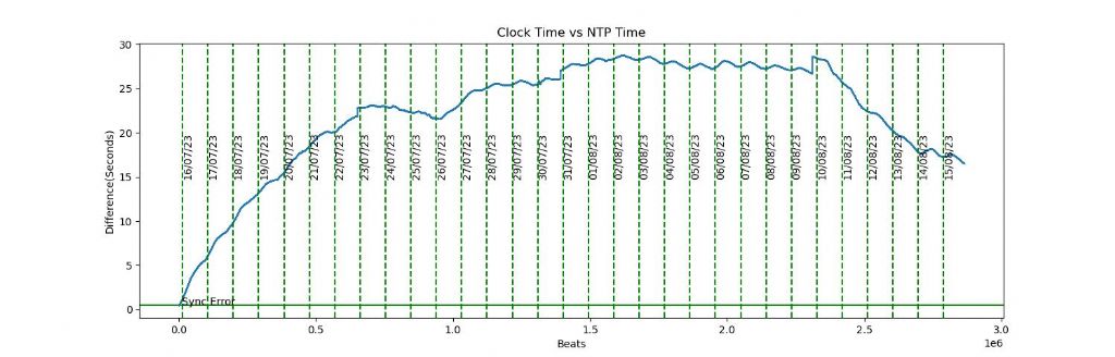

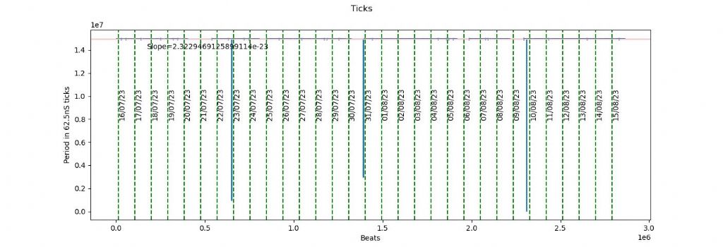

                    • Some time back I posted here (different thread that I can't find) some results I measured on repeatability of the Sharp opto interrupters. I measured these using the CNC mill to make small slow movements and using the opto output to drive the probe input of the controller. A little macro to take repeated measurements which were exported for analysis. Basically I was getting a standard deviation of less than 0.2 microns on repeated approaches to the same position, in the dark and with constant supply voltage.
                    • I referred earlier in this thread that Bateman's clock achieves better than 1 second of arc precision in swing amplitude, using "home made" optos. For a ~1metre pendulum this amounts to a precision of ~5 microns in estimating the peak. Noting that the velocity of the pendulum is going through zero at the maximum deflection and so the waveform seen by the detector will have very slow edges, this isn't bad at all.
                    Yes, the opto sensor is affected by ambient light and voltage variation but I think these results give some sort of scale to what we are trying to achieve.
                    Given that the sensor in an opto is in a sense a "one pixel camera" then perhaps some experiments with a webcam lens and a conventional photodiode would be useful?

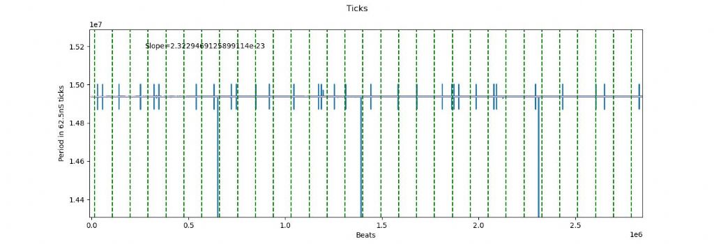

                                  I have read it twice this evening, John … and I remain astonished
                                  The biggest ‘take-away’ for me is that the Sharp opto is seriously compromised by ambient light,
                                  [quote] It quickly became apparent though that even ambient daylight has a large effect on precision, so it is best to assume that the sensor should be shaded as well as possible. [/quote]
                                  Left to its own devices [so to speak] the performance is quite amazing; and this, of course, is using a simple IR LED that provides ‘flood-lighting’ !!
                                  All the clever stuff must therefore be credited to the sensor itself … Mmm !!

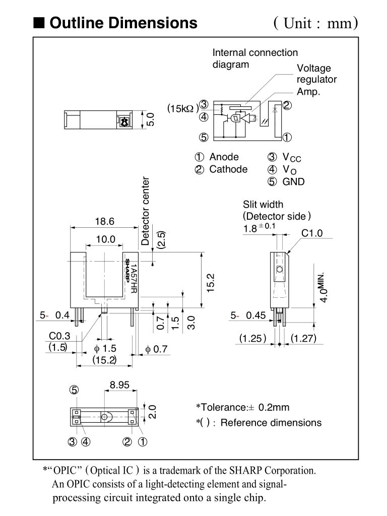

                                  I have the package drawing, and have purchased a small quantity of these devices to play with study
                                  … in due course [which may be a while yet] I will try to better understand the optics.
                                  #656570
                                    Package drawing:
                                    I think at least one of these will need careful dissection dont know
                                    … the slit width doesn’t look anything special.

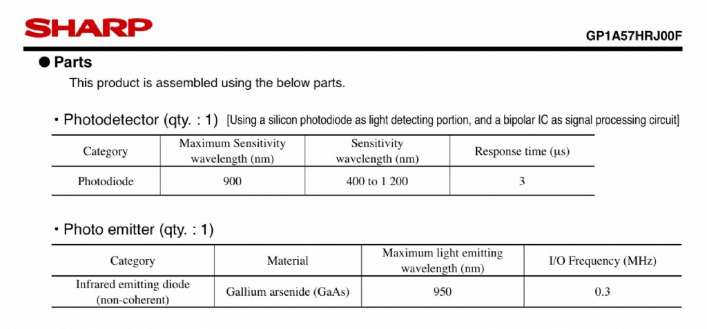

                                                [ UPDATE ]
                                                I have just located this … which may be important for future tinkering:
                                                The IR diode of course [by the nature of these things] is essentially a single wavelength emitter [950nm]
                                                BUT
                                                The silicon photodiode is sensitive from 400 to 1200 nm surprise
                                                Therefore … Stray light problems might be considerably reduced by inserting a suitable narrow-band-pass filter in the beam path.
                                                Edit: __ the word silicon has been struck through, in deference to S K
                                                Edit: __ HOWEVER … please see the words in Sharp’s text, which can be dowloaded here:
                                                https://proto-pic.co.uk/content/GP1A57HRJ00F.pdf
                                                Edit: __ for technical reference
                                                https://opticalfiltershop.com/shop/bandpass-filter/nir-bandpass-700nm-to-1100nm/nir-bandpass-filter-950nm-fwhm-100nm/

                                                  My next step will be to retry the laser with the Sharp receiver. I will probably use a pinhole instead of a slit this time, to reduce the net light exposure a little further, while still presumably being stronger than the IR transmitter.

                                                    Arguable that Fedchenko's transistor circuit is a very simple computer, but all it does is keep the pendulum swinging, it doesn't monitor or control amplitude and it tells you nothing about period.
                                                    Dave, don't get me wrong . I'm not against computers, but I wonder whether the sometimes spurious results thrown up might over say a 1-year run, ruin your clocks performance. I doubt that Fedchenko's simple single transistor circuit would suffer from this too much. …
                                                    Spurious sensor readings are causing my pronblems rather than the computer as can be seen in this graph, where 3 giant errors cause the clock to jump:
                                                    I don't know what caused them. May be a coincidence they all occur just before midnight.
                                                    Zooming in on the data shows thirty odd more much smaller anomalies:
                                                    Although the smaller glitches balance out, they shouldn't be there. Best thing would be to find and fix the cause, but I've thought of filtering them out in software. Hard to find the cause of only 40 apparently random errors in 2.9 million readings, so it's tempting!
                                                    I can't get away from using a computer because I'm experimenting with a statistical clock. In this experiment the actual pendulum period doesn't matter provided all swings are normally distributed. Instead, detecting a swing causes the microcontroller to calculate and count what the period should be after compensating for temperature and pressure.  The period calculating formula is derived from statistical analysis of a long pendulum run during which the pendulum is compared with a much better clock. (Bog standard NTP at present but I can also use GPS).
                                                    Despite progress, I'm not getting the precision I long for!
                                                    On the graph above the straight green line shows what the clock should be doing, i.e tracking NTP within about 100mS. The blue line shows my clock is wandering, and other graphs show the rate changes are not temperature or pressure related. The wandering blue line is bad news – straight lines are easy to compensate, random wandering is a horrible mystery. Roughly:
                                                    • Gained 23 seconds in 7 days, then
                                                    • Lost 2 seconds in 2 days, then
                                                    • Gained 8 seconds in 9 days, then
                                                    • Lost 1 second in 8 days, then
                                                    • Gained 1 second due to a sensor error, then
                                                    • Lost 14 seconds in 6 days.
                                                    After a month, never been more than 29 seconds wrong, and is currently only 17 seconds fast, not awful except I'm hoping for milliseconds per year, not half a minute per month! In theory my clock is working brilliantly: in practice it's below average. Unfortunately the experiment requires I persist with the computer!
                                                    sad

                                                      Dave: I don't know about the glitches, but the clock vs. NTP time plot looks a lot like a typical random walk due to the accumulation of minor random errors. My suggestion is to direct your attention to improving the period measurements. Get a few of the Sharp optos, maybe. They are pretty good and may improve things a lot.
