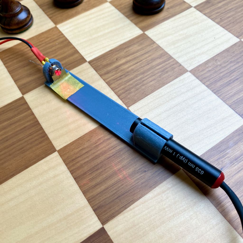

                          I have some results – mostly anecdotal thus far – from testing a laser and photodiode combination. The setup is seen below.
                          The photodiode (Thor Labs FDS010) is silicon, and was selected for its small active area of 0.8mm^2 (1mm diameter). The small area means a small capacitance and hence high speed (quoted 1ns rise/fall time, presumably with a 50 Ohm load), plus a flag should spend less time traversing the surface during a pendulum swing.
                          The laser is a Thor Labs PO204, 635nm, Class 2 (<=1mW), with a lens and a round beam of about 3mm across. This wavelength is somewhat close to the photodiode's peak wavelenth sensitivity of 730nm. A Class 2 laser is generally safe, and is as bright as likely needed for this application, as it is indeed very bright: absolutely do not stare into the beam (with your remaining good eye)!
                          I have mounted a slit, made from two razor blade shards, vertically in front of the photodiode (the mount is very cheesy, but it works for now), with explanation below.
                          The photodiode is being run with a 5V reverse bias purely for convenience (10-20V would be better). A 380 Ohm load resistor is used to provide a detectable voltage while still maintaining a fast speed of operation.
                          I used my gravity pendulum as a test vehicle, and an oscilloscope to observe the output. The combined capacitance of the photodiode and the scope probe is slightly under 20pF. In combination with the 380 Ohm load resistor, this should be a very fast sensor.
                          But, without the slit, the rise and fall times were about 50 ms! This is very long, and at first I was confused (also by the linear slewing that was observed), but the reason is simple: it takes about that long for the pendulum to sweep across the ~1mm detector. I predicted this effect notionally (hence the small detector), but my mistake was not calculating how bad it would be!
                          Using the slit (not measured, but it's pretty small) reduced this to ~7ms, which I still consider to be very slow. And since it blocks a lot of the light, it also reduces the signal amplitude considerably:
                          There's a fair amount of noise in the signal, which I should track down.
                          Here's the dilemma: Pendulums are just too slow for good timing! Even with a narrow slit, the rise and fall times are much slower than I was hoping. The problem is that the slope of the rise/fall times is slow enough for noise to cause a fair amount of jitter in a comparator's output.
                          At this point, I am not at all surprised at the ~5us RMS noise in the Sharp sensor's output, and it's not clear to me that much better can be achieved without trickery. For now, I don't recommend that people spend the money on the above sort of combination. But for those using the Sharp opto-interrupter, a slit in front of the photodiode may help. Also, it's best to detect the swing at BDC, where it's moving the fastest.
                          To be continued after I spend some time in thought. Some way to optically amplify the speed of the pendulum is needed. Any ideas?

                                    I don't need a comparator yet. For now I'm looking at the analog output straight from the photodiode. What I want to know is what the photodiode's own signal is doing so I gain an understanding of what an op-amp, etc., would have to work with. (The photodiode is definitely not close to saturating.)
                                    So: I increased the load resistor to 10k, which significantly increased the I-to-V gain, in order to compensate for the reduced illumination through the slit. I also narrowed the slit a little more. I think I could go narrower still with some care.
                                    The net result at present is roughly 80 mV signal and about a 3 ms rise/fall time. The rise and fall times are currently dominated by the speed of the flag, which causes the voltage to rise as more of the photodiode is illuminated or fall as more is covered.
                                    I tried to use my counter to compute an RMS value for the period, but it would not work reliably with this signal level, so an op-amp will be needed to make more progress. Adding a comparator, Schmitt trigger, etc., can speed up the edges almost arbitrarily, but while that looks good, it says basically nothing about timing resolution of everything that came before.
                                    If the slit technique is the best improvement that can be made, I could buy a precise one. These are available down to 3um and probably lower, but they are quite expensive. With a very narrow slit, a more powerful laser might help too.

                                                    • The trigger is reliable (Voltage regulate the comparator reference)
                                                    • After triggering. the response must be fast, or at least with known delay, and the output as close to a square wave as possible (A comparator or Schmitt Trigger does this, ideally a type chosen to suit this application.)
                                                    Sharpening the shape of the sensor's output with slits, shielding, and collimation helps by improving rise time. Be interesting to set up a test rig and measure how much varying slit width moves the detection window of a comparator.
                                                    For what it's worth, not much, my efforts with slits were aimed at improving reliability. Beam systems are vulnerable to sunshine and reflections causing the apparent slope to vary, for example sunshine falling on the back of an IR sensor alters its sensitivity to IR entering properly through the front lens.
                                                    I'm looking forward to SK's next move. He's questioning things I've assumed which is always good. Entirely possible I've overestimated the performance of my beam system, and not noticed because bigger errors mask the problem. I went cheap and convenient rather than sophisticated, therefore likely better is needed. Not proven it needs fixing yet though.
                                                    Edited By SillyOldDuffer on 11/08/2023 10:00:25
                                                    #656067
                                                    duncan webster 1
                                                      @duncanwebster1
                                                      Back to the flat mirror. Bouncing the beam off a mirror doubles the angular deflection, so if the mirror was fixed to the top of the pendulum and the laser and sensor were at the bottom it would double the deflection. However I wasn't being entirely hence reference to a deep hole. Something tells me that having a long optical path isn't good. The idea came from memories of ballistic galvanometer we were allowed to play with in physics lessons at school, and that's a long time ago.
