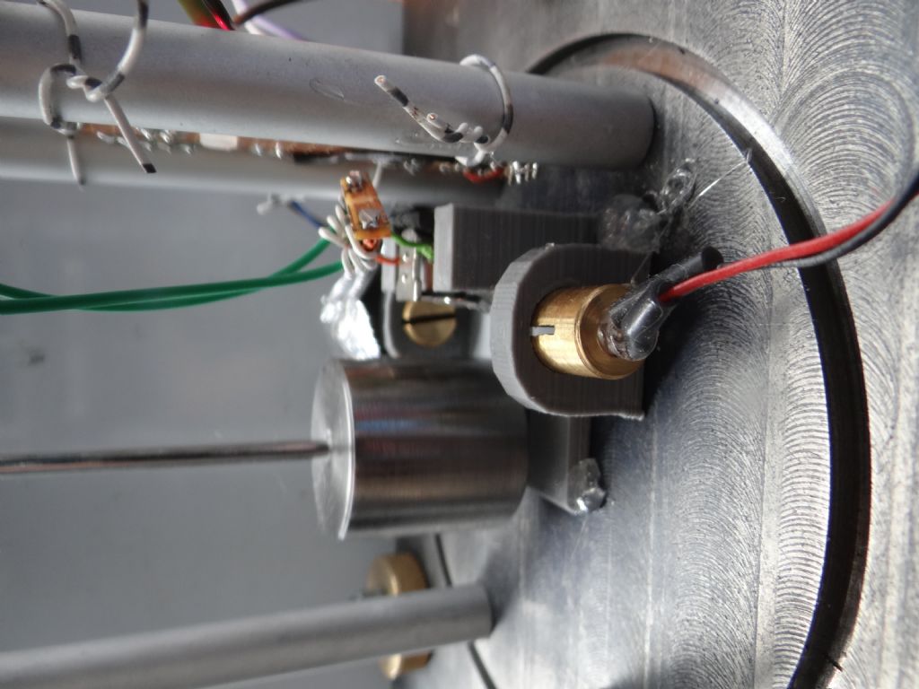

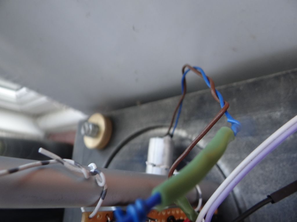

              You've probably done similar already, but I found it helped to position the receiver with its back to the sun, protected with a blob of plasticine.
              The big improvement, I won't claim bomb proof, was putting sender and receiver in sealed Brass tubes with slotted ends acting as a sort of collimator:
              The dark side Brass tube above contains the sender, not shielded at the back.
              However, the receiver Brass tube, with its back to the sun, is shrouded with a length of Aluminium tube blocked with black plasticine. The only way IR can get in, I hope, is through the collimator slot, which is aligned with the sender.
              In my build the collimator is important because IR bounces off all the internal metal work, including the moving bob. I had multiple problems with unshielded IR sender and receiver. Sun shining on the receiver alters its apparent sensitivity, whilst IR from the sender or sun reflecting off the bob and structure causes false triggering. Even though my pendulum should be immune when it's working in a light-proof container, I will retain the shield and collimator, and will probably blacken the shiny metal internals.
              At this stage of the game, IR management is more important to me than fitting the fastest possible receiver. The very basic circuit and devices I'm using are good enough to detect that my pendulum period varies distinctly beat by beat (microseconds). Plenty of other problems to fix before I need to improve the IR system.

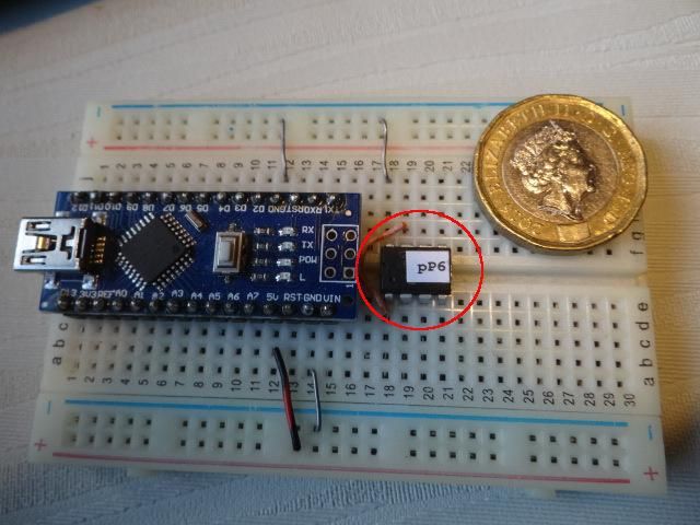

                                        Agree, I think the PicPET chips are brilliant. For anyone interested, here's a PiCPET and Arduino Nano side by side.
                                        The PICPET is ringed in red. There are only 8 pins, 3 of which aren't used. The main complication on a modern computer is the output is RS232 serial at 9600baud. In the good old days all computers had RS232, but this has been replaced by USB. To connect it to a new PC or Apple, it's necessary to spend a few pounds on an RS232 to USB converter. Also needed, a stable accurate 10MHz signal, ideally an OCXO. If you want to change what the chip does, PICPET is coded in PIC Assembler. Delightfully cheap and simple plus top performance.
                                        In contrast, the Nano has 30 pins, and the chip has more memory and capabilities than the little PIC. USB is built in, and so is a 16MHz oscillator, unfortunately not very stable! Programmed in C from the Arduino IDE, and there are a multitude of plug-in modules, with software, available to simplify the electronics. You don't have to design and build your own Motor controller, Real Time Clock, Accelerometer and Sensor boards etc as well as write code. Precision Event Timing can be incorporated into a larger system. In my experimental pendulum, the same Arduino:
                                        • runs two PETs, one measuring pendulum period, the other crystal frequency
                                        • drives the pendulum, controlling when the impulse occurs
                                        • reads temperature, pressure and humidity,
                                        • counts pendulum time in seconds and microseconds, compensating for environmental changes s required
                                        • displays Day/Month/Year/HH:MMS locally
                                        • logs the all data to a remote PC and
                                        • responds to commands sent from the PC, such as set current time
                                        All this is more complicated and not so cheap. Also, I haven't got an Arduino PET to measure events as accurately as a PICPET.
                                        Like everything else, the worst shortcoming of the PICPET is what it doesn't do. Monitoring a pendulum clock it's useful to log temperature, pressure and humidity as well as period because they can all influence the pendulum, and PICPET doesn't do that.
                                        Back to obsessing about pendulum precision, after applying temperature compensation, a close look shows air-pressure needs attention too. Maybe humidity as well, certainly if the rod is made of wood. Anyone know what happens to a pendulum's period when water condenses on to a metal bob and rod? I guess it would shift the centre of mass slightly, causing a serious disturbance if condensed water collected on the bob base and then dripped off!
                                        #655245

                                          Dave, you could surely use software serial with the pP and get the Nano to gather data from a BME280 via I2C? It would then have much less time-critical software to run.

                                              Great minds think alike! That's where the photo of a Nano and PP6 on the same breadboard came from. The pP6 sent software serial to the Nano, which read a BME280 and added environmental data to the pP6 string, before sending the whole via USB to a PC (actually a Pi)
                                              At that point I discovered I could do PET and collect environmental data with the Arduino alone, advantage being it eliminates a serial hop, and moved on, missing a trick. At the time I didn't have an OCXO, and it's only just occurred to me after reading your post that an OCXO/pP6/Nano combination is a winning combination!
                                              Clearly my claim to have a 'Great Mind' is flawed.
                                              sad
                                              Life dominated by a family crisis at the moment but I should be able to build one later. Not difficult to program and I could use it to measure how good my GPS + ordinary oscillator technique really is.
