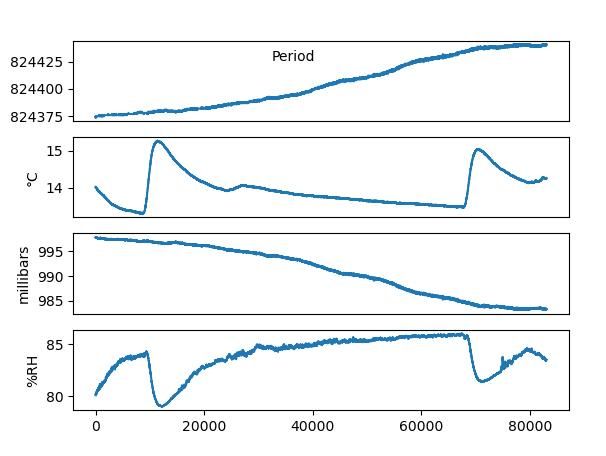

                      I don't think there has been any mention of humidity, perhaps ignored because bad weather goes along with low pressure, but does anyone try to seal their case and put desiccant into it? Perhaps the effect is too small to matter.

                          Posted by Bazyle on 25/03/2023 17:22:30:
                          Duncan Webster was going to try and calculate how much humidity changes air density. Might cause an error by altering the bob's buoyancy. He's not reported back, so maybe the maths is horrible. None of my books worry about humidity, but they all agree removing air is a good thing.
                          Wooden pendulum rods are sometimes used because they don't change length much with temperature. Although wood is humidity sensitive, I've not seen it mentioned directly, through Grimthorpe recommends keeping church tower pendulums well ventilated, not boxed in.
                          When I used carbon-fibre as a combined spring/pendulum, it was markedly sensitive to humidity. However, the effect disappeared when I fitted a steel spring. I'm pretty sure humidity affected the spring of the plastic matrix, but not the length of the rod, which is controlled by the carbon fibre innards. Same might happen to wooden-rods, which run with the grain, where humidity might alter diameter much more than length. Changing the diameter of a pendulum rod wouldn't make much difference to the period.
                          As far as I know, what humidity does to pendula is still mysterious, but any effect on metal rods must be tiny.
                          #639107

                            Well if you increase the water molecule content of air it becomes less dense so buoyancy will decrease. How the viscosity changes is another question.

                              I had a look at this recently though haven't worked it out thoroughly. Water vapour does reduce air density and given the RH, pressure and temperature one can compute the density, and hence make allowance for the effect on drag though neglecting viscosity. But IIRC when Tom Van Baak analysed the Clock B results there was no obvious correlation of rate with RH.

                                Posted by Martin Kyte on 25/03/2023 18:24:07:
                                Well if you increase the water molecule content of air it becomes less dense so buoyancy will decrease. …
                                regards Martin
                                What exactly happens to buoyancy is complicated because relative humidity varies with temperature, and less obviously with pressure. Do humidity and temperature cancel out or add? One of my graphs captured temperature and RH% marching nicely together but in the opposite sense:
                                But notice the curves aren't an exact match, and other examples are more jumbled. I think this example is unusually close because air-pressure happened to be falling steadily at the time, no jerks. I don't know what a graph of air density or viscosity would look like!
                                PS.  Any american's reading this?   In the UK 'buoy' is pronounced 'boy', whereas the US say  'boo-ee'.  How is 'buoyancy' pronounced in the USA?  'boo-ee-ancy' sounds very odd to me!

                                Martin Kyte
                                  @martinkyte99762
                                  Hi Dave it’s absolute humidity that determines the density. Basically molecule counting. As a water molecule is less massive than an O2 or an N2. Using the ideal gas law with temperature and pressure constant for the same number of mixed molecules the density reduces. It also reduces with increasing temperature with increasing divergence at higher temperatures with different absolute humidities. Temperature variations seem to be the bigger factor in density than humidity.
                                  regards Martin

                                    I recall, from my time in the ‘Environmental Engineering’ test-house, that Humidity is one of the trickier things to monitor/measure/control … many commercial devices are of questionable accuracy.
                                    Whilst pondering this, I’ve just found some interesting notes, here: **LINK**
                                    https://www.processsensing.com/en-us/blog/effect-of-temperature-and-pressure-on-rh%20.htm

                                    Martin Kyte
                                      @martinkyte99762
                                      **LINK**
                                      The above link may be useful and there are references to viscosity too.
                                      The graphs are in terms of relative humidity and temperature but I guess that’s because it’s a far easier thing to measure.
                                      regards Martin
