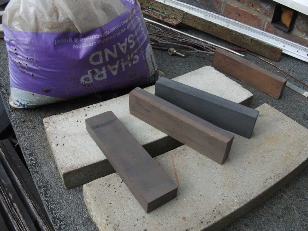

                                    John P
                                      @johnp77052
                                      Here are some flat stones that made some time ago ,as Brian Wood has
                                      said they can be easily formed by rubbing in three's to eventually get to
                                      a flat condition, two of these three i already had but were badly hollowed
                                      the third i bought from a second hand shop in much the same condition.
                                      Using two concrete slabs that are fairly flat to start with and some sharp sand
                                      they can be conditioned to bring them to a flat surface and from
                                      there on the oil stones can be flattened to take out the dips,it is a long
                                      process and best done in short sessions,Final finish using wet and dry
                                      paper on a surface plate with paraffin as a lubricant and then lapping them
                                      together.
                                      You can not get to the same finished edges as described in
                                      Robin Renzetti's video here
                                      but they work well enough on just plain flat surfaces, not worth doing
                                      if you don't have a surface grinder to finish work in the first place.
