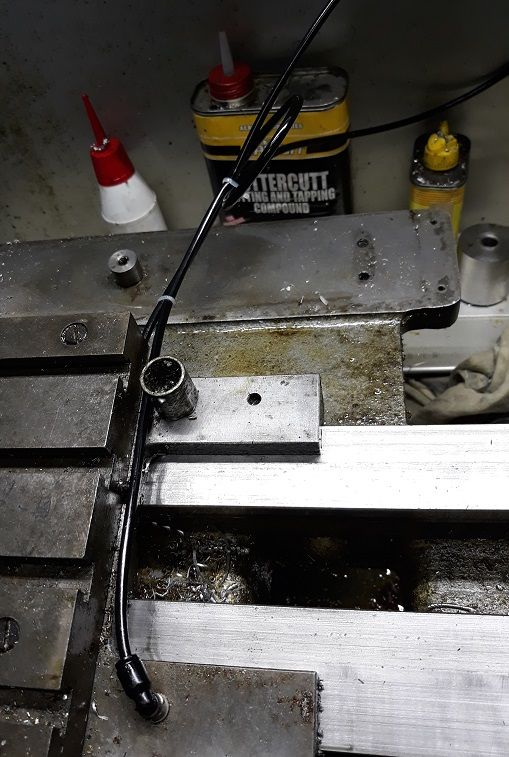

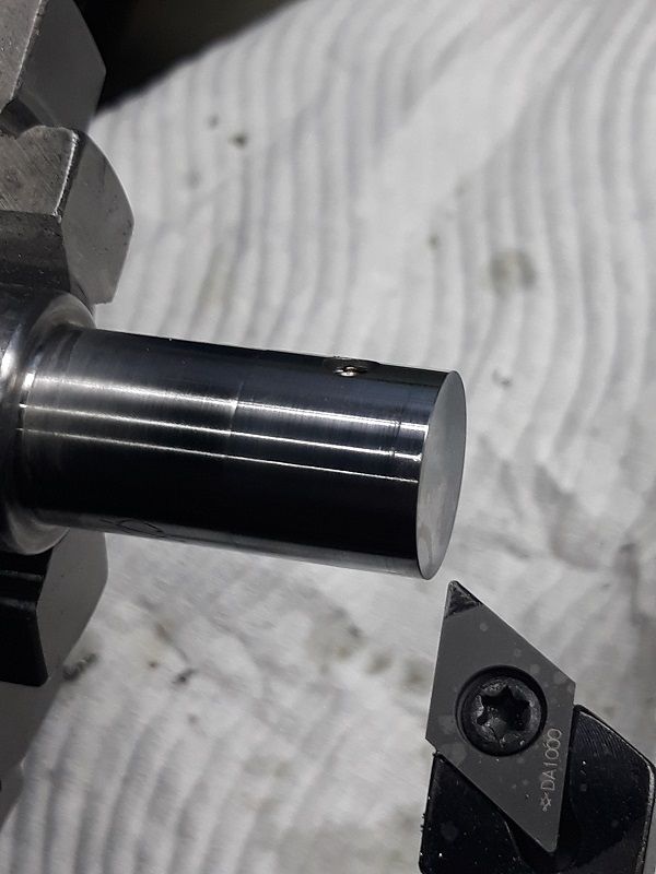

            An update on piston trimming and taking very fine cuts. So, since I got this postitive geometry PCD insert, I can now a make and fit the pistons for the F2C Diesel race engines. This cutter allows me to trim the piston dry, get a really good finish, and allows for less than 1um cuts on a piston. Cutting dry is a big time saver as they need to be clean and dry to get an idea of the fit point in the liner. I also added a continuous drip oil feed to the saddle to keep the bed wet with oil all the time. Makes it very consistent on the saddle movement.
            Saddle oiler
