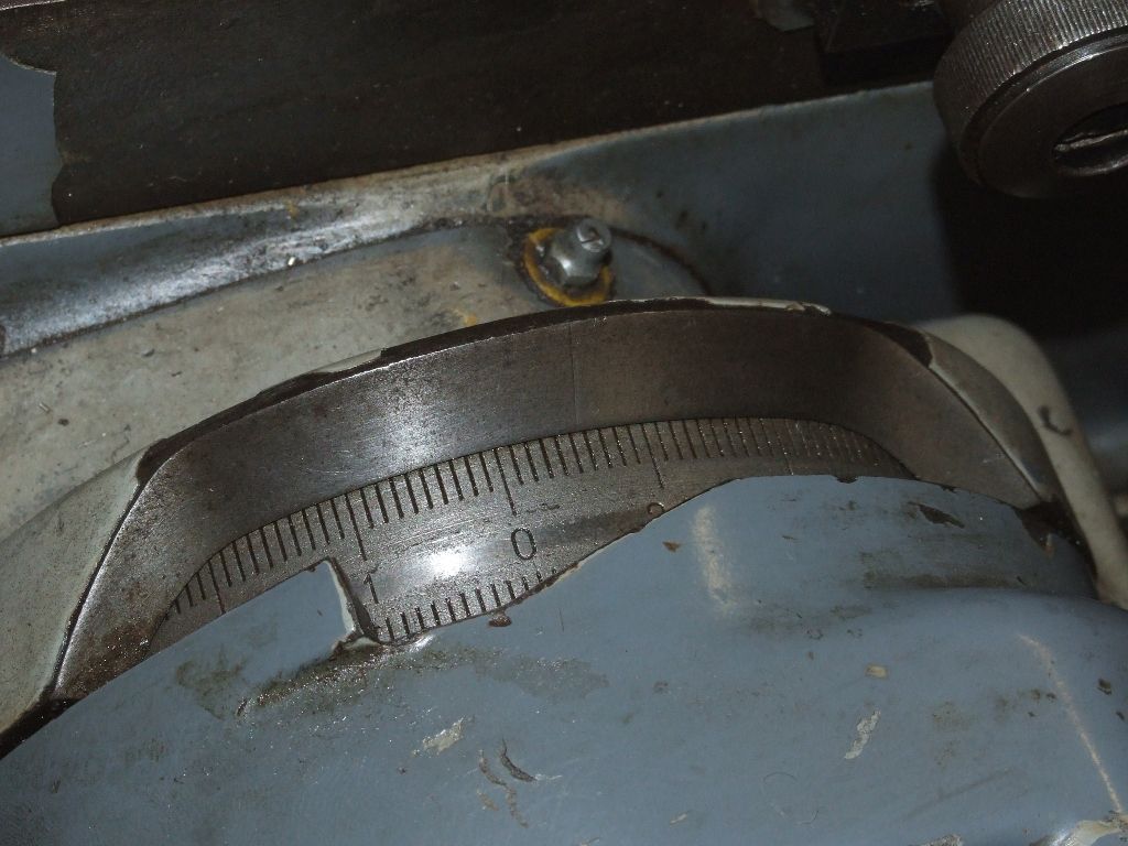

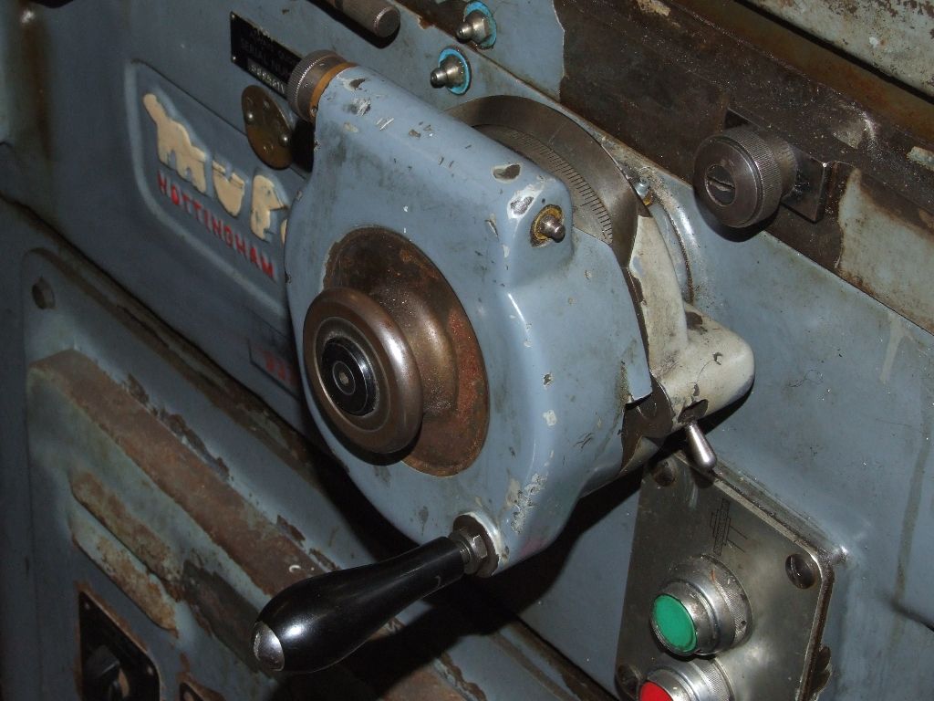

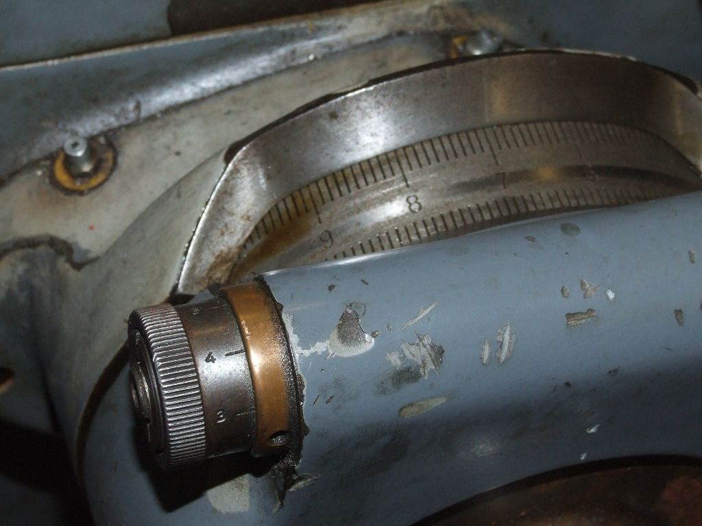

                                        On my small cylindrical grinder the wheelhead feedscrew is geared to be effectively 40tpi at the hand wheel, ie, 25 thou per rev. Here are the basic controls:
                                        The main handwheel drives the wheelhead screw via a reduction gear. The small lever above the green electrical switch operates a stop for the handle. On top of the handwheel is a fine feed worm drive. The knob top right is for fine adjsutment of the table swivel. Here are the graduations on the main hand wheel:
                                        Each major division is 1 thou, each small division a tenth of a thou. These are direct reading, ie, the diameter reduces by twice the value. The worm drive allows a fine feed against the stop:
                                        Each division is 25 micro inches, ie, half of one tenth on the diameter.
                                        Everything is designed with known, and repeatable, allowances for backlash. For instance the wheelhead feedscrew has a large (100lb+) counterweight on the back:
                                        The machine itself is pretty heavy 1300lbs. There is also an art to grinding, sparkout is important for obtaining consistent sizing.
