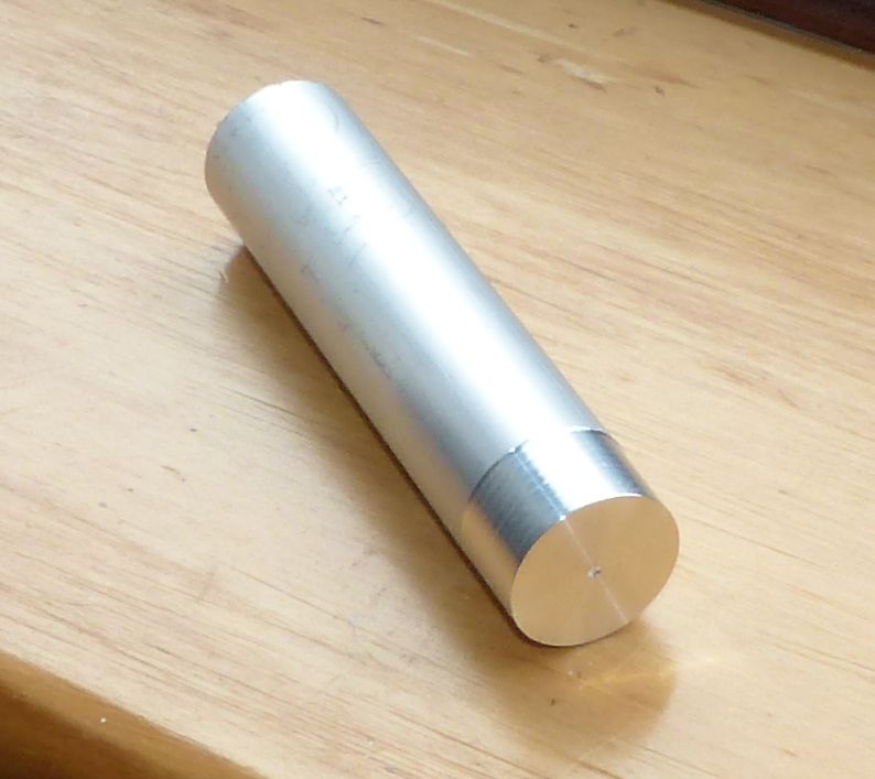

          Colin LLoyd
            @colinlloyd53450
            You guys are brilliant – everything you say makes sense to this novice – even if it doesn't necessarily apply to my situation. And it's true that you learn most through getting things wrong.
            Nick – yes everybody suggest that if you replace the bearing – use taper replacements – and I would have done if there weren't so many adjustments and alterations that need to be made to fit these – especially for someone who didn't even know what the inside of a lathe headstock looked like – or whether this was going to be a descending path into chaos. I know better now and should I need to replace the bearings again – I will go for taper bearings.
            Anyway, I took the back-gear off the lathe, again, to the point where I could look at the movement of the spindle and the individual bearings (I can nearly do this part in my sleep now). And at that point I could move the spindle, by hand back and forth by a few 10ths of a mm. And this movement was all on the inner ring of the angular bearing at the drive end – which tends to say that despite my efforts I had failed to apply any preload originally. May have been a similar movement at the Mandrel end but difficult to ascertain what was happening there as the mandrel shoulder covers the inner race and part of the sealing rubber skirt – but luckily (or most probably by design) not the outer ring – otherwise you couldn't apply pre-load to the mandrel end bearing.
            But I think the initial problem was using one of the old bearings as a "pusher" item so that the bearing went in straight and to protect the new bearing from the steel pipe that was used with the leather hammer to drift the new bearing on (unfortunately several Youtube videos showed this was how you did it). Once the outer race was seated fully in its recess, no more pressure would move the inner race further along the spindle. And no amount of what I deemed to be reasonable tightening on the spindle through the C-nuts would cause the inner ring to move on the spindle to create pre-load.
            While I appreciate that there should have been sufficient "give" on the spindle to allow the C-nuts to adjust the Pre-load – I'm loath to take the bearings off the spindle and start again – as I have found that these angular bearings, through their design, are prone to come apart in one direction if not the other. Again I realise that this is due to the very tight fit on the spindle – but again as a novice I thought this tightness was normal – will do better next time.
            I made up a press along the lines that Neil suggested (thank you Neil) and gradually tightened the inner ring along the spindle – all the time making certain that the spindle would still turn easily – and I have got rid of any apparent play in the spindle. I will get a clock on the mandrel face and see what movement there is still left through hand action – not very scientific but at least a start.
            I realise I'm actually applying preload – that will not come off when I release the pressure (because of the tight fit again) – and that this is therefore possibly a one-way action. Neil – you mentioned somewhere else applying pre-load by tightening up the C-nut by hand and then by another amount defined by an angle. Is there a torque load that I could apply that essentially does the same thing? Anybody?

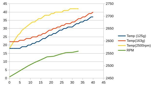

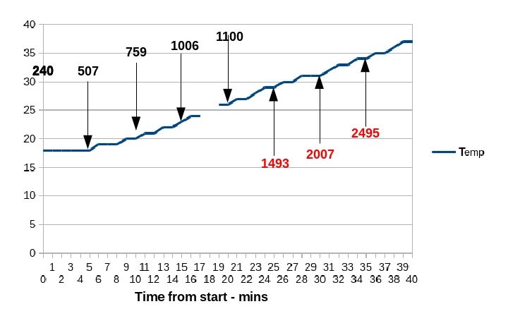

                            Colin LLoyd
                              @colinlloyd53450
                              Being an ex-scientist, I thought I'd do a series of experiments to ensure I don't "burn-out" my new bearings. The initial test was for a pre-load that seemed to take out all the free-play in the longitudinal and radial axes of my lathe spindle. The amount of preload was such that a mass of 125g acting vertically downward from a chord wrapped around my 100mm chuck was sufficient to just begin to rotate the spindle – not a lot of preload I guess. A 2.5mm hole was drilled into the top surface of the headstock box over the centre of the rear bearing to a depth of 7mm – so not right through to the outer bearing surface. Computer CPU thermal paste provided the thermal contact between a K-type thermocouple and the metal surface at the bottom of the hole.
                              Over a period of 40 minutes, the lathe was run at increasing speeds at 5 minute intervals and the temperature of the thermocouple recorded every minute – the result is shown in the graph below. The initial temperature was 18 deg C and initial rotational speed was 240 rpm. The arrowed figures show the increasing rpms (black is low range, red is high range). At the end of the 40 minutes, the headstock recorded 37 deg C while a contact measurement on the inner ring of the rear bearing recorded 45 deg C.
                              I shall now increase the preload by a fixed amount as judged by my rotational mass method and repeat the experiment. I need to find some figures for maximum operational bearing temperature and also some torque figures for preload that I can convert to my simple rotational mass method.
                              Eventually this may be of use to other mini-lathe owners.initial temp curve.jpg

                                  Colin LLoyd
                                    @colinlloyd53450
                                    Experimental Update: See above for 1st test (result labelled Temp(125g) on graph below. Increased the pre-load on the bearings – it now takes 163g mass to rotate the 100mm chuck. Did the same test again – increasing the rpm at 5 minute intervals and recording the temperature every minute. At the end of the 40 minutes, the end bearing inner ring recorded 47 deg C. Results shown as Temp (163g) on graph. Then did a complete run at max revs (nominally 2500) and recorded temperature until it plateaued at 42 deg C when the bearing inner ring recorded 48 deg C. This is labelled Temp (2500rpm) on graph. During this run it was noticed that the revs increased from 2455 at start to 2559 at finish (labelled RPM on graph- right hand scale). Not sure if this was due to bedding in of the bearings or lower friction through heating. Difference between Bearing inner ring temperature at start and end = 30 deg C which seems to be at the top end of Ketan's range. From this, I'm guessing I'm about there with pre-load but prepared to be told otherwise. Will reassemble rest of lathe and do some test cuts.3 temp rpm curves.jpg
                                    #318410
                                      Nice work, Colin
                                      #318646
                                      Ketan Swali
                                        @ketanswali79440
                                        Posted by Colin LLoyd on 24/09/2017 15:38:28:
                                        Great experiments, and a great log Colin. Your guess is probably right for the pre-load. Do post your results for the test cuts.
                                        I know that others in future will refer to this thread for guidance. So, I would just like to mentions some words of caution for them:
                                        1. Always avoid over-tightening. When one over-tightens the nuts, it means that the motor has to work harder, drawing in more power at times through the control board. In turn, this could have adverse (negative) effects on the motor, as well as the control board.So, be careful.
                                        2. Brushed DC motors work a little differently from Brushless motors. the principal is the same when it comes to pre-load, but the behaviour of the motor and moreover the control boards will be different. So again, don't just depend on one factor/variable to make judgements and conclusions.
                                        3. load on the spindle with an 80mm chuck will be different from the load on the spindle fitted with a 100mm chuck. So, again, keep this in mind.
                                        4. Temperature on the front end (working end) – where the chuck is mounted is likely to be greater than the temperature at the rear end, due to the load of the chuck at this end. It is my understanding that the temperatures observed on Colins chart are at the rear-end. So, avoid prolonged 'running' at top speed at the top end temperatures. If it looks like the temperature is likely to continue to increase, stop the machine, let is cool down, start again. if same happens again, loosen off on the pre-load.
                                        5. Colins process of bedding-in should be regarding as the starting point. It will take further time for the bearings to really bed in, based on use.
                                        6. The process Colin carried out with pre-load applies to AC and TR bearings only. Please avoid using this guidance for deep groove ball bearings, as in real terms – deep groove ball bearings are not really designed to accept 'proper' pre-load. Although I am aware that some people ignore this comment, it really is not good for deep groove ball bearings.
                                        Over the years I have seen a small amount of bearing/motor/control board failures resulting from 'overdoing' things. So, one should keep these points in mind, as whatever you do, experiment, you do so at your own risk. Comments made on here are for general guidance, and each machine behaves differently.
                                        Ketan at ARC.
