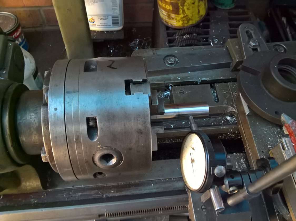

      One of my lathes, a Holbrook, came to me in the 1980’s with a 5″ griptru chuck, I rarely use the lathe these days so decided to fit the chuck on another lathe I use all the time which has a 4″ chuck.  I made the backplate etc and noticed when fitted that a test bar in the jaws didn’t run quite true. I refitted it back on the Holbrook and see the same thing there.
      So I set up a DTI and it looked way out. I began adjusting the 3 Allen keys while turning the headstock slowly and it began to improve. I got it almost spot on and then released the test bar and retightened it and it had lost some of its previous setting. I did this twice with the same result so what is the best technique to adjust these?chuck

      Clive Brown 1
        @clivebrown1
        The technique should be on-line somewhere.Turning an adjustment screw clock-wise moves the chuck body outwards  from the spindle centre-line. It’s important to release the other two screws say a turn or two before you do this to allow some”slack” to enable this movement. Also, the 3 screws at the back of the chuck should be firm but not overtight otherwise that movement will be difficult.

          It says online to start by slacking off all 3 of the adjustment screws which l did, when you mention 3 screws on the back of the chuck then maybe that’s causing my problem, l’ll take the b plate off and see if l can loosen them and then retighhten

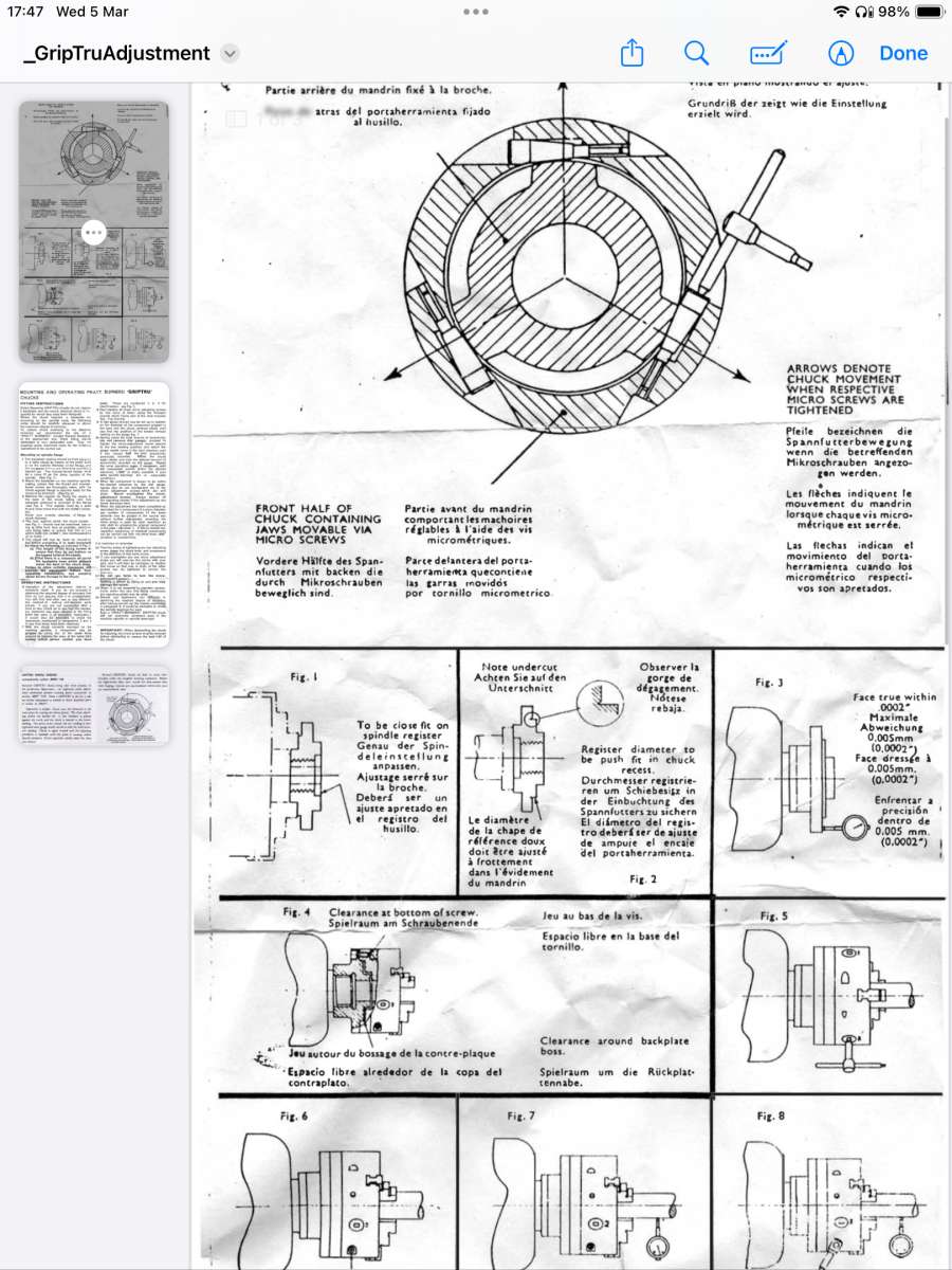

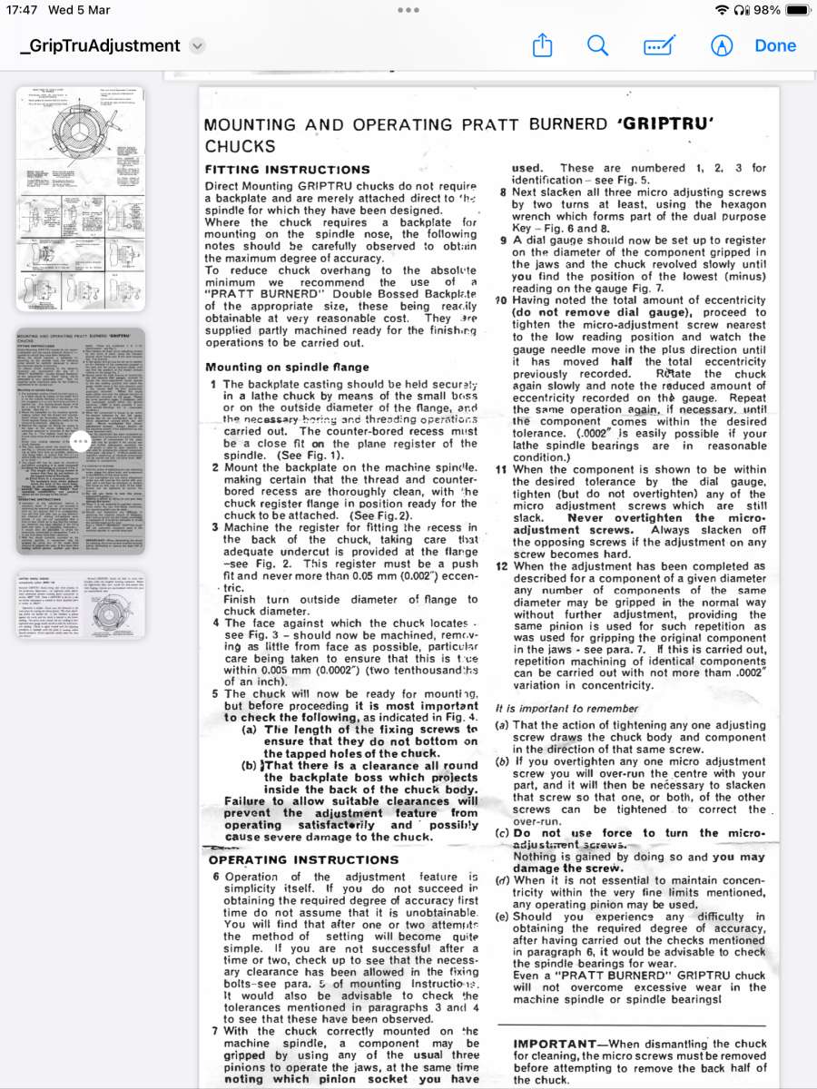

            IMG_3524IMG_3523

              Did you use the same chuck key pinion both times? You should always select a master pinion and stick to it.

                  Thank you all for advice and Dell for the scan of the original instructions. I will take it all apart and start again tomorrow and see how I get on
