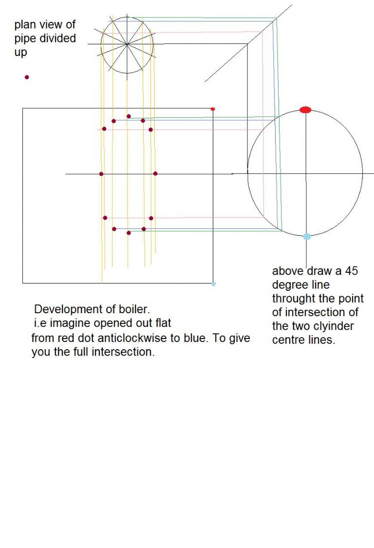

      Hi everyone,
      I’ve started on my first loco and have just finished flanging all the boiler plates, and I’m quite pleased with the results. Anyway on looking at the dome bush I can’t for the life of me figure out how to project the cylinder diameter of the bush, ( a circle of course) down onto the boiler barrel. Simply scribing a circle on the barrel with a compass will of course distort the circle. How do people approach this (what appears to be simple) but for me baffling problem?
      thanks

                      There are two ways of doing it.>>
                      on the centre line of the boiler where you want the flange to go mark the true OD of the flange on the line.>>
                      Then using a circular object or hole and a very stong light project a shaddow onto the line on the boiler, at 90 degrees to the line on the boiler. Adjust the distance of the object untill its shaddow touches both of your marked points on the centre line. Then draw in the rest of the shaddow out line and that is the development of you pipe projected onto the boiler.>>
                      If you want a paper template to follow have a look at the attached diagram. It should be easy to see how the pipe has been divided up into sections and then those lines are projected in two directions to get points of intersection on the boiler, the brown dots in the diargam.>>
                      Link the dots and that is your outline.>>
                      The diagram is basic so you dont get a good set of points to join up. Easily solved just add more lines and intersections to fill in the blank bits.>>
                      I hope that helps regards Clive

                          Hi Vincent,
                                             its been bugging me all day that my diagram may NOT correct. As its 30 odd years since i last did this sort of thing I have missed a bit out.
                          So I think if you use this method you need to test it out on something unimportant like a toilet role core.
                          So what have i done wrong?   the red dot blue dot on the circle is the boiler diameter but when you develop that out into the flat it becomes half the circumference i.e 3.142 times longer.
                          Some how there needs to be an intersect line intersposed between the boiler circle and boiler development such that as you transfer the lines across they correct the positioning by a factor of Pi  but at the moment I can not remember how.
                          Not sure if I have made that better or worse but it gives you a starting point for a net search.
                          If you give me diameters and aproximate location I will try and get some time to do it properly but with work at the moment i can not promise.
                          Regards Clive

                              Clive, what your projection produces is the view of what the tube would look like while it is round. If you want to develop the shape of the tube as it would be if flattened out you have to do more work. You could draw radial division in the circle on the right, then project them across your developed shape. The radial lines would be getting closer together there as you get further from the centre. You then draw a similar grid of lines, but with the horizontal lines at a constant spacing, equal to the circumferential distance between each radial line. Transfer the sizes from the original set to the new set, and it will stretch the shape at the ends by the right amount.
                              However, unless the plan is to cut the hole and then roll the tube shape, which I would not advise, that approach should not be needed. The problem is not to find what shape the hole would be if the tube were flattened, it is to make a hole which is reasonably close to round in the actual tube
                              The other thing is your smaller tube seems to be meeting the larger tube at a tangent. The original problem was for a dome bush, which would mean that the centre lines of the two tubes (extended) would meet. I did a tube like yours once for a model water tube boiler, of a simple Babcock and Wilcox type. Simple because it only had one bank of tubes, which used a cross tube across the drum for a header. I made the semi elliptical cutout by just filing until I had a good fit…

                                John and All as stated I realised my  original drawing was not the full story.
                                And yes it does look like a tangent application but it was the only way i could get the template profile that would need to laid over , curved round the boiler to scibe a line that when cut would be the circular hole required.
                                Rather than fiddle about and misslead some more i had a quick look on the web and came up witht he following link.
                                about half way through it does the intersection of two cyinders.  That is what i was trying to convey but failed to do so correctly.     I was close though
