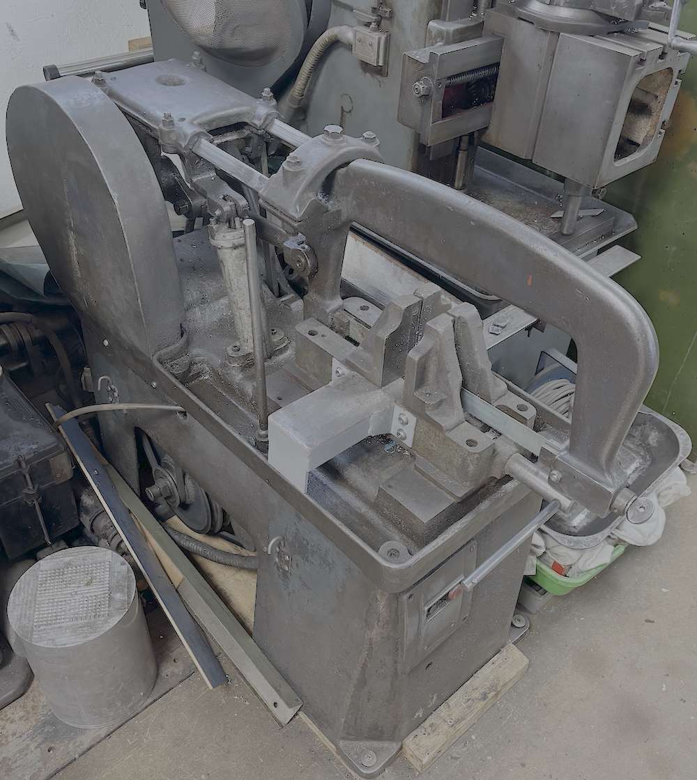

                            Hi Clive. yes my blade is in the correct way, and the saw works very well as it should, over the 20 years that I’ve had it, but it doesn’t have any adjustment on the dashpot, like others have said. Mine is the Manchester Light Duty one with a mechanical disengagement to the saw drive.
                            Rapidor
                            Regards Nick.

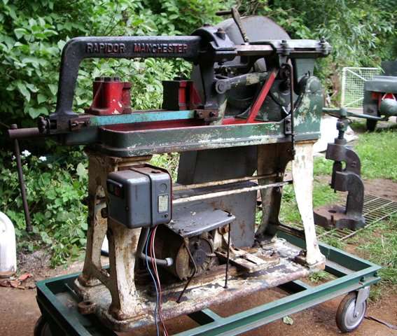

                              Rapidor
                              Came with an angle iron work support around 18″ long on the right side looking at the saw. Added another on teh other side. Between them a great help in balancing longer stock. Green cabinet is on wheels so with that out of the way I’ve around 6 ft clearance to the Bridgeport. 15 ft the other way yet I’ve still had bars hanging out of the door! One of Mr LiDLs fold up axel stands made a great basis for a long stock support. Foilds up to hang on the wall out of the way.
                              About a fortnight before being offered that one for £50, my wallet came out smoking, I’d picked up one similar to yours in needs a scrub and oil restoration condition. Came out of the weirdest workshop I’ve ever seen. Basically a long, house width, conservatory with an under drive shaft for the machines running in a gully down the floor. In front of the machines with a scattering of drain covers as a nod to safety. Clearly disused for some years everything was buried in dried leaves. Only the bow and half the flywheel of the saw were visible. Like yours that one has a fixed dashpot, fast and loose pulleys with mechanical clutch and a swivelling vice. Plain bow with no letters cast in.
                              Clive

                                  Hi Clive, yours looks similar to the Major medium duty one, but I’ve never seen one, or seen illustrations/photos with the vice arrangement like the one you have, maybe it was a special build. Lathes have a fairly good writeup about these machines Rapidor Saws I’m guessing mine is an early model, as the adds say it has an adjustable dashpot, and as I have an old tool catalogue from around the late 30’s, that advertises the “New Manchester” one, which looks the same. When I first started work after leaving school, the shop I worked in had one like mine, but it was powered by overhead line shafting.
