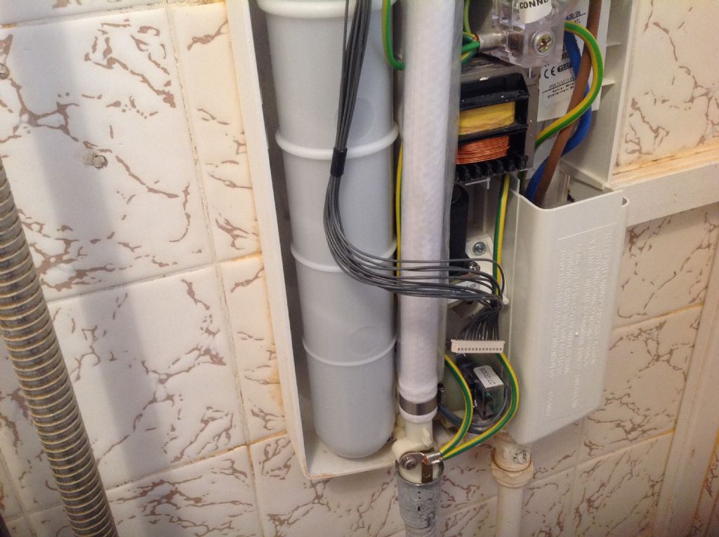

                The CB is protecting the cable, probably worth checking cable size is correct if your changing the shower
                Also, where does the other earth cable come from at the Electric input, there seems to be two earths coming in with the cable before it gets to the feed cable terminations?
                Can you post a picture if possible please?

                              Photo as requested:
                              Mira electric shower unit
                              All connections are tight.

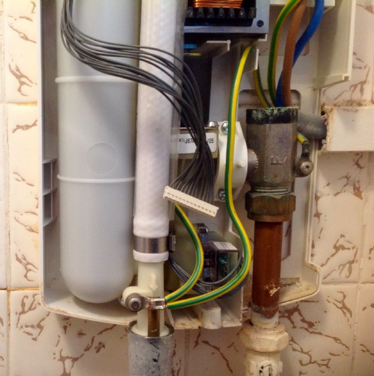

                                            On the outlet for the shower head, there are two earth wires crimped, one of the goes back to the electricity inlet, what does this one connect to?

                                                Chris,
                                                Earth goes to the cold water pipe as required.
                                                Didn't mention at first, but the unit started playing up with fluctuations in the heat of the water on two occasions prior to tripping the CB.
                                                No idea why I didn't mention this.
