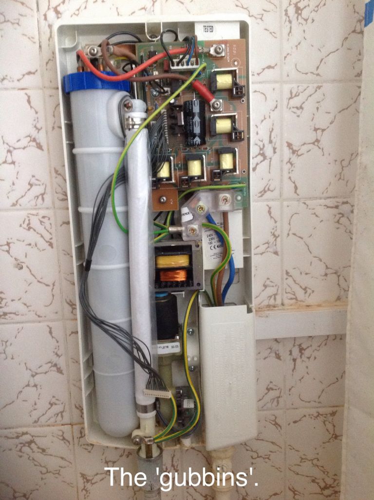

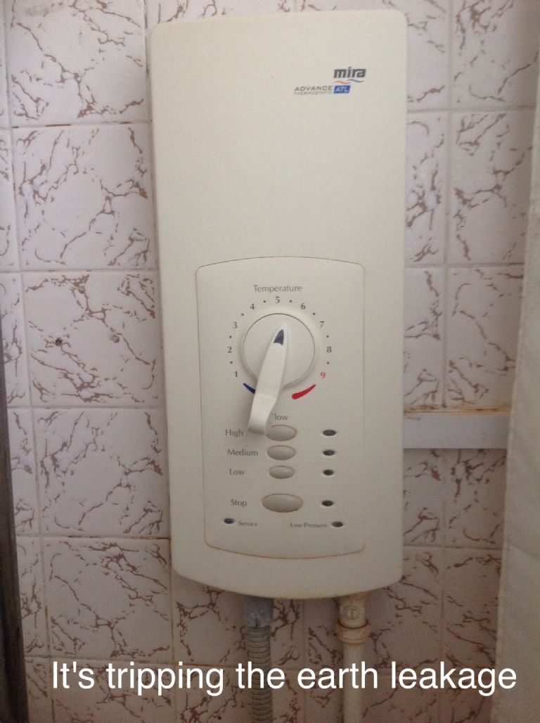

      OuBallie
        @ouballie
        I'm fine with 'normal' electric, but just add a single diode into the mix and I run screaming "Witches, Devil" etc.
        My complete lack of knowledge means I don't even know where or even how to test the internals to find what is causing the RCCB to trip, so hoping the extensive knowledge on this Forum will be able to come to my assistance.

            Ideally I would isolate the heater side from the electronics as a first, see if that helps….if the fault doesnt occur again, then its quite possible the heater is leaky….obviously if it trips with the heater isolated, then there's an issue with the electronics..

              Hi Geoff- where did you find it, in the science museum? It looks like its time to get a new one fitted. Water and electricity don't mix too well, the stain on the front cover looks ominous. Perhaps strip the relays off the board before you junk it – may be useful on the Ruby?

                I would suspect the heating element.
                Isolate the shower at the consumer unit and the double pole isolator switch. (Possibly a ceiling pull switch.)
                With an insulation tester (Megger) set to the 500 volt setting if the voltage is selectable check the insulation between both brown wires and the red wire and the neutral wire and earth. (If all three elements in the heater are intact just one of these tests would be OK as the resistance of the elements is only a few tens of ohms.) It would be safer to remove the brown wires, the red wire and the neutral wire from the screw terminals (Making a note of where they connect to.) on the PCB just in case there are any capacitors or VDRs that could be damaged with the 500 volts from the insulation tester. The insulation readings should be more than 10 meg ohms.

                  What I would probably do is disconnect the leads to the heating element – the rather large ones – being very careful with what I did with them – whoops – easy to be careful on this one, undo the screws on the board as that is where the power is coming from to the heater. Then see if it still trips the breaker. If it doesn't the problem is with the heater which looks to be replaceable. Search make type spares. It probably will still trip but a spare board may be available.
                  Have to say though that I have made assumptions about what I can see in the photo.

                      Having worked on these a couple of years or so ago I found a recurring fault was a sensor on the bottom of the unit. There are two sensors connected to the board with two flexible wires each. If I remember correctly these were coloured blue for one and red for another. If you unplug these one at a time you may find the fault. The heater is another possibility. Unfortunately the sensors are not available as spares or were not when I looked into this.

                        When all else fails, read the manual It includes a circuit diagram and identification of parts. The maker's policy is that they won't supply spares unless you know what you're doing. For the rest of us they have a customer support service, which would be my first port of call unless the thing is so old that you decide to replace it.
                        In the absence of obvious water damage, the most likely cause is a dodgy heating element – as others have suggested. The fix for that is to replace the whole "Tank Assembly"
