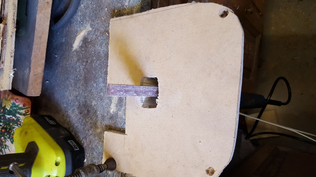

                                        I bought one of the cheap Silverline sanders from Amazon for a little under £30.00 and rigged it up temporarily to use as a light-weight linisher to find out whether it would be worth the effort of making something more durable and presentable. I used a couple of pieces of scrap MDF, a piece of 1 1/2"by 1" wood and a couple of cable ties, clamping the lot to the bench with a g-clamp.
                                        I have to say that I am really pleased with how it has turned out: it works really well and allows me to shape thin pieces of copper accurately and cleanly. In time, I shall make something stronger, with a quick release clamp for the tool and an adjustable table for the work piece.

                                          Oh dear, I'll probably end up getting one of these "bandfiles" next time they are in stock at LIDL. There's no law against it and as you know, you can't have too many tools…

                                              We all know it (Don't we), but getting anything in your eyes is not good, get some brass or copper in your eye can lead to loss of sight. Just treat these machines with a bit of respect, wear some eye protection and you should be OK.

                                                    So is copper worse than other metals in this respect?
                                                    #311589
                                                    ega
                                                      @ega
                                                      "So is copper worse than other metals in this respect?"
                                                      Can't be pulled out with a magnet?
