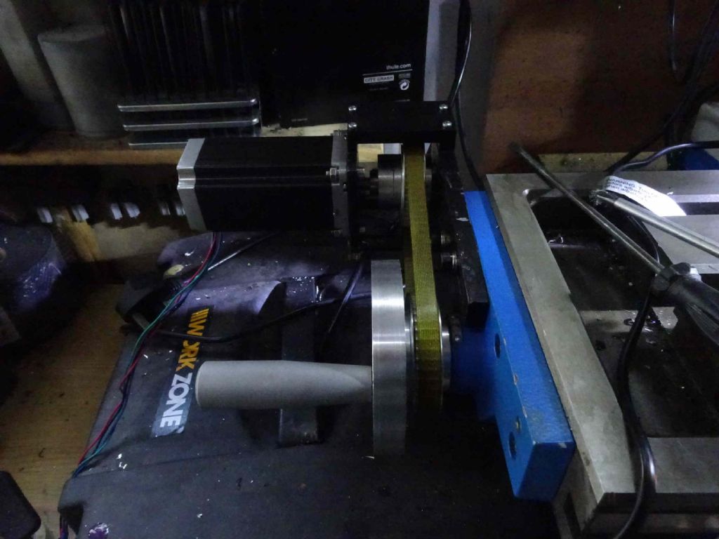

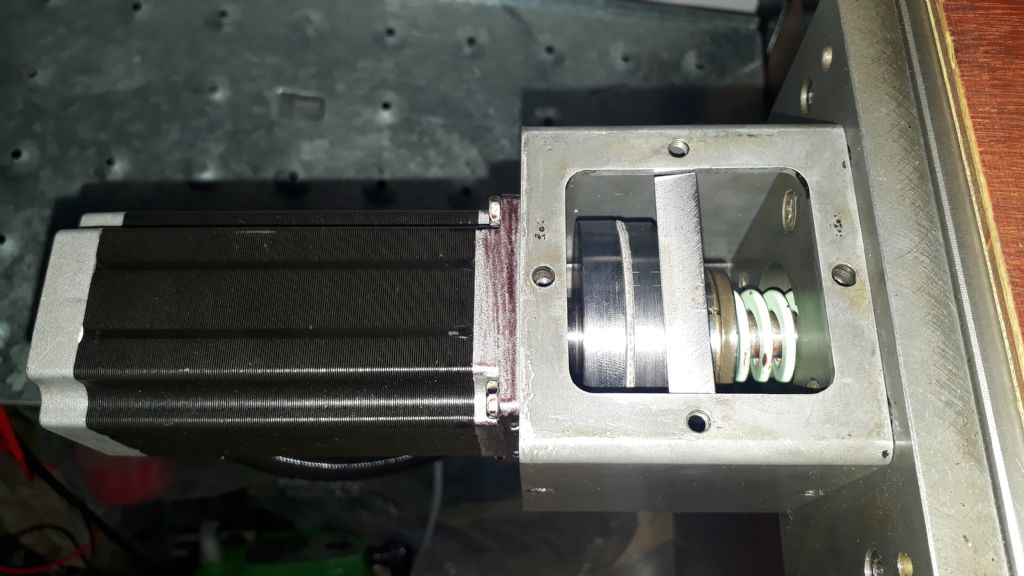

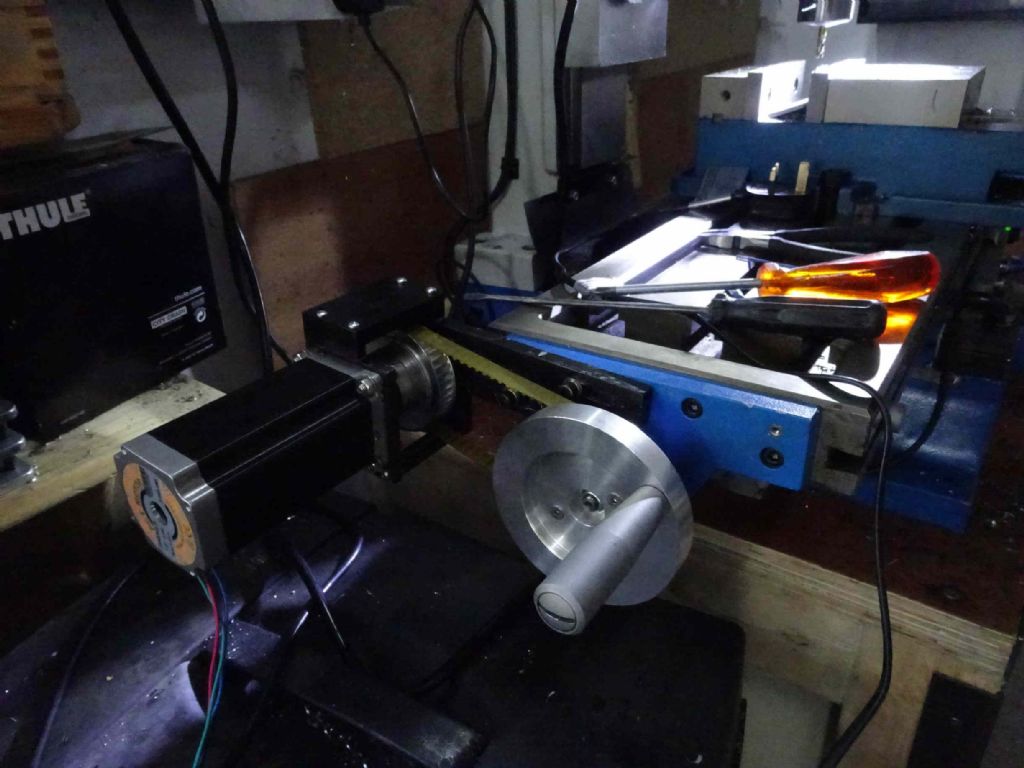

        At last! It's done! Well… nearly
        I've run this up with my test program and can get about 8mm/sec with 8x microstepping. I'm planning to try lower levels of microstepping and check how that affects quality and performance.
        Now, I say it's done, but I'm lying. My control program is still being worked on. I decided after some red herrings to put the UI for the control on an Arduino, so I'm working on that at the moment.
        Also I want to have end stops working before I use it in anger and that needs a bit more metalwork and electronics – and software.

                                    CLUTCH
                                    The dog clutch I made mainly works, but it's awkward to engage and disengage. I have to undo a grub screw and force the moving dog along the motor spindle. The keyway seems to want to choke up so I have to lever the dog back and fore. Not a good design.
                                    I will almost certainly be reworking this. In fact I will consider buying a commercial drive. It's fun to muck around, but I've probably spent a comparable amount to a commercial drive – ignoring the many hours of time I've put in!
