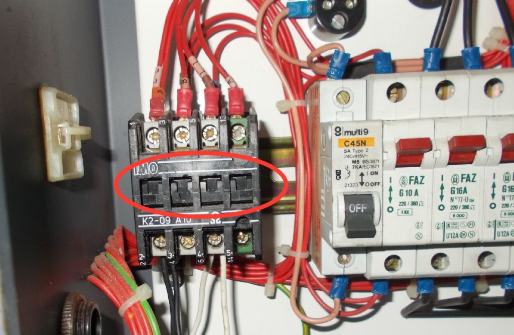

      I was using the power feed on a job taking medium cuts and all was fine with no issues. I then went to proceed with another cut and nothing ! I wasn't using the power feed to the Y axis but this also now has no power.
      Opening the Mains power box shows the ( MCB ) ? has tripped. I can reset this and it remains set but still no power. Looking at the contactor to the left hand side it appears seized . The other contractors allow movement of the part circled in the photo ie spring back when pushed ( Not whilst plugged in I may add ) I don't mess in there under power. I can also see and hear the other contactor move when the on switch of the mill is pressed. The power feed contactor does nothing and as I say appears solid. Is it likely that the contactor is the problem or am I just being very hopeful.
      I have found the same contactor on line or at least one looking identical with the same code K2-A9 A10. Am I to assume if this if required it will be the same voltage etc. Or will there be variants of this. I am NO electrician.

            You will need to check the coil voltage of the contactor as many options are fitted. DC versions can have a flywheel diode fitted, sometimes it is a separate module as it is not required in all applications. The code on the top of the contactor probably isn’t the full part number, this is usually on a label on the side. The coil voltage may be located on the coil or on part of the coil assembly. A close examination of the contactor should reveal all the details you need for a replacement. Most manufacturers will make an equivalent device but be sure you match the normally open and normally closed contact arrangement.

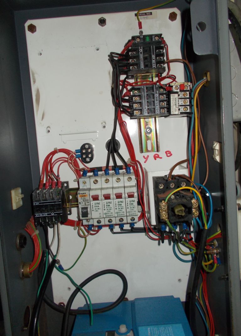

                  Do you have a wiring diagram ? This may be a big help in tracing whats what. What model of Bridgeport is it ? Is the fault in the contactor ? has the wiring to the contactor failed, is it the coil, is it the switch to the coil , is it the contacts? IF its the coil you may be able to buy just the coil. Has the 110v transformer gone ? IMO are a common maker so a replacement should be simple matter but make sure you get the right coil voltage – the coil may be supplied seperately. Good luck. Noel

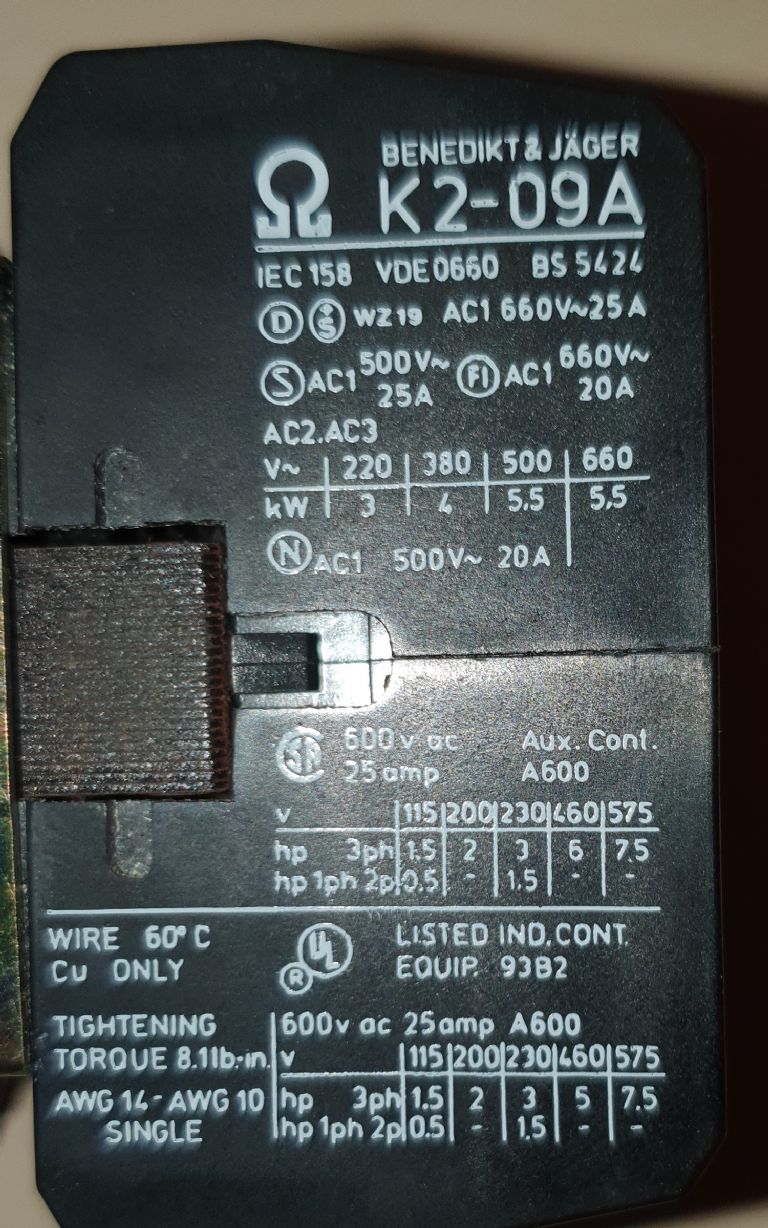

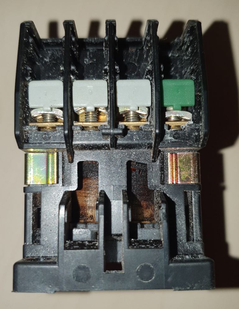

                        I have tonight removed the contactor and to my untrained eye the coil appears to be damaged / burnt. Luckily all the information on the unit is still readable if I need to replace with similar from somewhere / somehow. I wouldn't know where to start looking.
                        I have added photos of the contactor and overall wiring which will hopefully make sense to somebody a lot smarter than me.
                        I don't have a wiring diagram.
                        Thankyou to all that have replied with advice and information, it is very gratefully received.20211012_193552.jpgdscn2548.jpg20211012_193939.jpg

                          I can't tell if the auxiliary contact is Normally Open (NO) or Normally Closed (NC). This is the green terminals at the end. Can you check with a meter?
                          If they are NO (same as main contacts) this one will do the job:
                          https://uk.farnell.com/imo-precision-controls/mc10n-s-10110ac/contactor-4kw-10a-110vac/dp/9940472
                          The coil failure may just be random or the VFD waveform may have been the last straw. Either way replace the contactor and either wait and see if it is OK. Cheking the voltage across the coil.would be a good precaution.
                          Personally I'd wire the 110V transformer directly to the mans bypasing the VFD. The transformer may have a suitable 240V winding.
                          Robert G8RPI.

                            If you dismantle the contactor you may just need a new coil, you mentioned the contactor is jammed and this often happens when the coil overheats and the armature sticks in the coil bobbin that distorts with the heat. The contactor does look a bit past it’s best though so maybe a replacement would be best.
                            Mike
