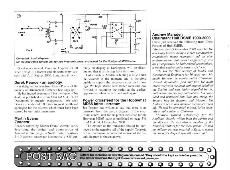

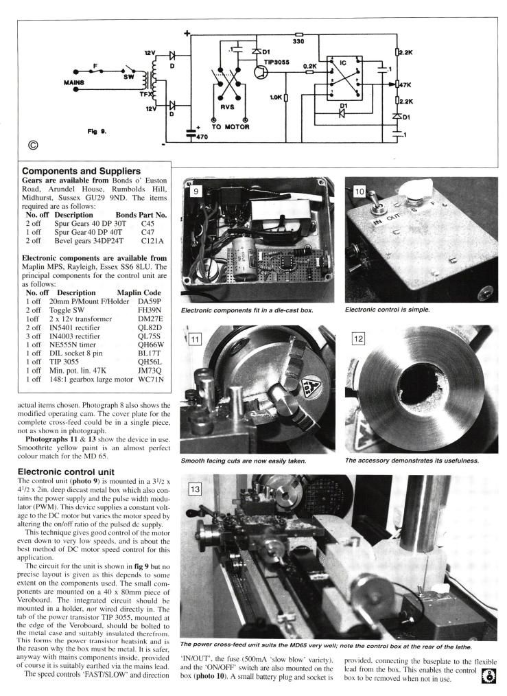

        A previous article in ME December 2000 pages 544-546, Yes that long ago! , I was constructing the electronic control from the circuit design and parts lists .
        After 2 completely new attempts, ie new components and boards, I could not get the motor to work. After checking(I am not an electrical engineer) I found that I had 14volts after the diodes but no further volts from thereon in.
        Has anybody used this design and can offer any ideas as to why it does not work, apart from the obvious that that I am at fault in some respect, and offer any suggestions for a possible commercial speed controller for a complete beginner that is easy to wire up
        any advice welcomed
        #284311
        John Purdy
          @johnpurdy78347
          Ian
          I have not built the circuit but looking at the schematic there appears to be two errors that would prevent it from working.
          The emitter lead of the 2n3055 transistor is not connected to anything, it should be connected to the minus power supply line at the bottom of the schematic.
          The diode (D1) at the collector of the 2n3055 appears to connected backwards. As shown it will not pass the plus voltage to the transistor. ( this would explain why you are not reading a voltage here.)

              Hmm – not sure about that aspect. Looks to me as though the current goes around the diode via the motor then the power transistor to reach negative rail (via the missing connection?). Replacing the diode the 'correct' way round would lead to release of magic smoke I fear.

                The only error with the schematic is that the emitter of the 3055 should be connected to the negative supply rail, the bottom line under the transistor. The diode connected to the collector of the 3055 is a catch diode which with the parallel capacitor serves to protect the transistor from back EMF transients generated by the switching due to the PWM signal applied to the transistor base.
                #284354
                Graham Flavell
                  @grahamflavell13482
                  I agree with David. The diode D1 is there to protect the circuitry from back emfs generated by switching an inductive load (the motor) in the collector of the transistor. Connecting the emitter of the 2N3055 to the negative rail should do the trick. Presumably since this is a major omission a search of the following editions of ME would turn up a correction. It might be worth a look if you have them just in case there are other problems with the published circuit.

                    #284442
                    Graham Flavell
                      @grahamflavell13482
                      Ian
                      Issue 4138 Page 64 carries the corrections. I don't have immediate access to my copy but someone else on the forum may have a better data retrieval system than mine!

                          I fully agree with assessment that the diode is correct as published. After I wrote that I had second thoughts about my reasoning, as soon as the transistor was turned on there would be nothing to limit the current except the diode and transistor, and as David said probably accompanied by "magic smoke". Sorry about that.
