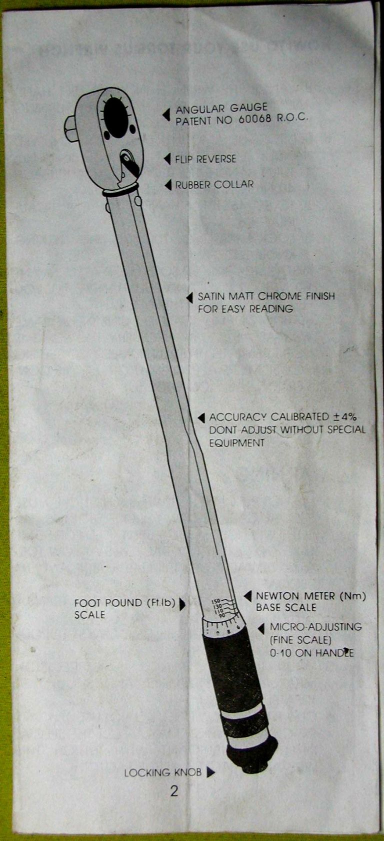

            Nicholas Farr
              @nicholasfarr14254
              Hi, I have a good quality Torque wrench and on the illustration leaflet it is stated that the imprerial scale is foot pound.
              Torque Wrench
              However, quoting from my dictionary,
              " Torque; 1. The moment of a force, a measure of its tendency to produce torsion and rotation about an axis, equal to the vector product of the radius vector from the axis of rotation to the point of application of the force by the force applied. 2. Broadly a turning or twisting force. [ Latin torquére, to twist ]"
              To my understanding of reading this I have come to the conclusion that the term, ft.lbs. is the correct one, the moment equalling feet and the force equalling pounds, although I understand its meaning either way.
              The OP's original concern is the use of the forward slash, which I understand as being divisonal in this context.
              Regards Nick.
              Edited By Nicholas Farr on 02/03/2015 19:11:40
