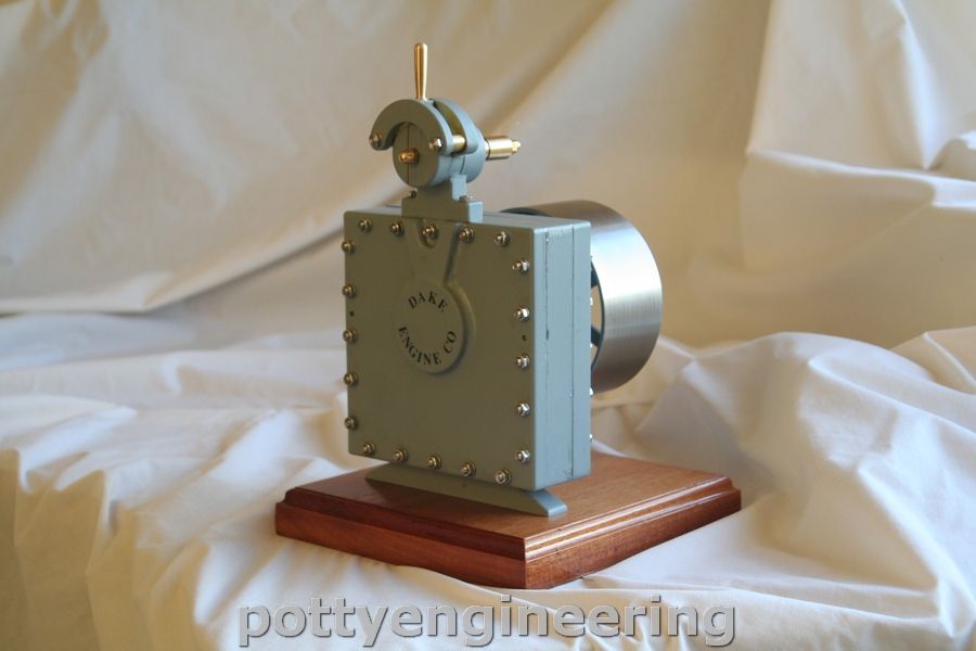

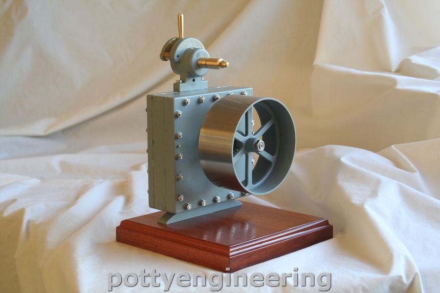

      Stewart Hart
        @stewarthart90345
        Thanks David
        The engine is now complete.
        And the video of the completed engine running showing the reversing valve in operation
        Stew

          Ian P
            @ianp
            That's very impressive and looks beautifully made and finished.
            As you say it does respond quickly but unlike some *engines* it does not have a heavy crankshaft.
            This is not a criticism in any way, however its not really an engine but is a motor. Self starting is pretty much a given with motors too.
            Presumably on ships steering this motor would use hydraulic oil? It would be more power efficient on hydraulics compared to pneumatics (all else being equal).
            I like it a lot.
            Ian

                      Stewart Hart
                        @stewarthart90345
                        Posted by Ian Phillips on 10/12/2012 16:49:07:
                        Yes Ian I think that does help and the fact that it is a none dead centre engine speeds up the resonce time
                        Engine or Motor it doesn't realy matter:- as the man said you can call me what you want as long as you don't call me late for dinner smiley
                        I havn't been able to find any reference of it running on oil, but what I do know was that it was used extensivly in mining and was powered by air piped down from the surface, hence you'd got a none sparking motor
                        I keep turning up examples of this engine being used a a very wide range of aplications thanks to its compact design and flexibility, it wasn't very economical in the use of steam, but in aplications where this didn't realy matter its advantages more than made up for this.
                        I was wondering if they used the exhaust steam from the low presure cylinders on a marine engines to use it for ship stearing ?. perhaps someone could comment on the vesibility of this.
                        Thanks again for your interest
                        Stew

                        Ed Wishart
                          @edwishart95571
                          Make the back out of transparent material so we can see the unusual motion inside??
