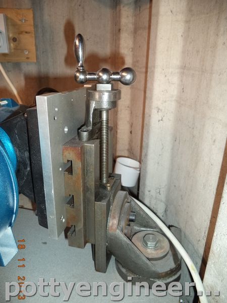

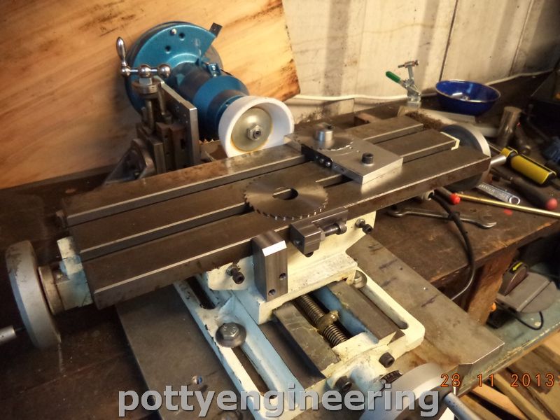

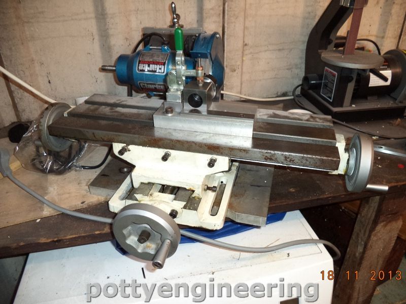

      The fertiliser for this came from a number of sources:- John Stevenson's cross vice use, and Harold Hall's book: tool and cutter sharpening from the workshop practice series.
      Its basically a compilation of commercially available parts, that consist of:-
      Myford vertical slide.
      Bench Grinder
      Mill Table
      Stevenson's ER32 index blocks
      The parts are all bolted down on a thick chunk of ally plate, The grinders motor wiring was rerouted to allow is to be mounted direct to the vertical slide. The mill table is one supplied by axminster that I bought second hand, but there are other types available from other suppliers that could be used just as well. The grinding fixtures from Harold Halls book can easily used with this set up, the mill table makes their use a lot easier and more positive.

        Mark P.
          @markp
          Oh yes we like this,keep it simple.

              #136679
              Thor 🇳🇴
                @thor
                Nice looking grinder Stewart, and as said very simple to make. I too use a small milling table and grinding wheels on an Emco Unimat to grind my blunt slot drills.
                Thor

                  #136706
                  Stewart Hart
                    @stewarthart90345

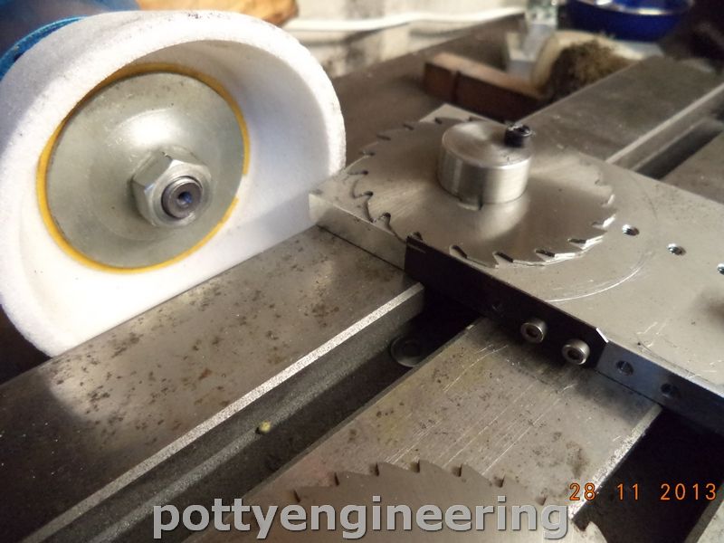

                    Thanks for your interest Guys.
                    This is very much a work in progress I've stripped it down to do some modifications:- secure the wiring: fit a guard for the cup wheel : fit a y stop: and fit some dust covers and felt oilers to the ways.
                    The Axminster x-y table is a little on the big side a smaller table would be more in keeping but it came my way at the right price.
                    As Neal said it has possibilities for other applications, that's something I plan to explore in the future that and other a cutter grinder uses.
                    Neal:- I seem to remember that paraffin was used as a coolant on diamond wheels when I worked in the tool room.
                    Stew

                          #136776
                          Stewart Hart
                            @stewarthart90345
                            I don't think it's developed enough for an article yet Danny, I keep seeing things that can be improved.
                            I'm going to add a riser block under the myford swivel slide this will speed up the set up time and allow the wheel to be tilted this will open up other possibilities.
                            I'd like to add a Y stop but I'm struggling to see the best way this could be done, still having a good think on that one frown.
                            Cheers beer
                            Stew

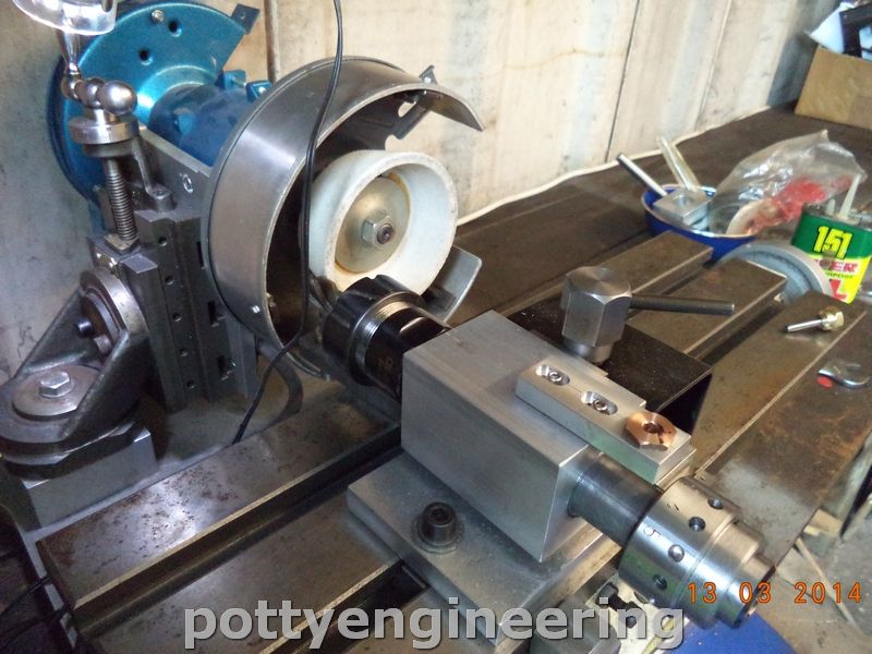

                            #147306
                            Stewart Hart
                              @stewarthart90345

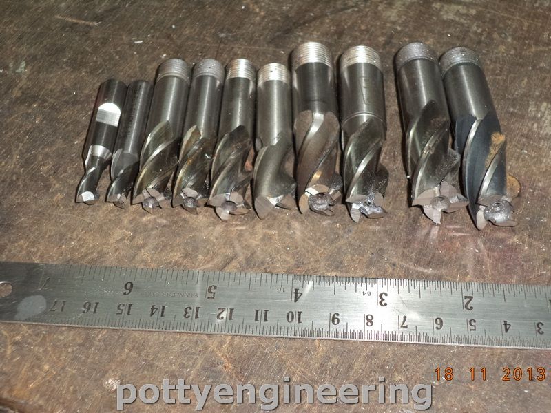

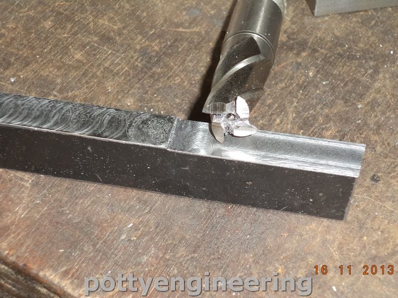

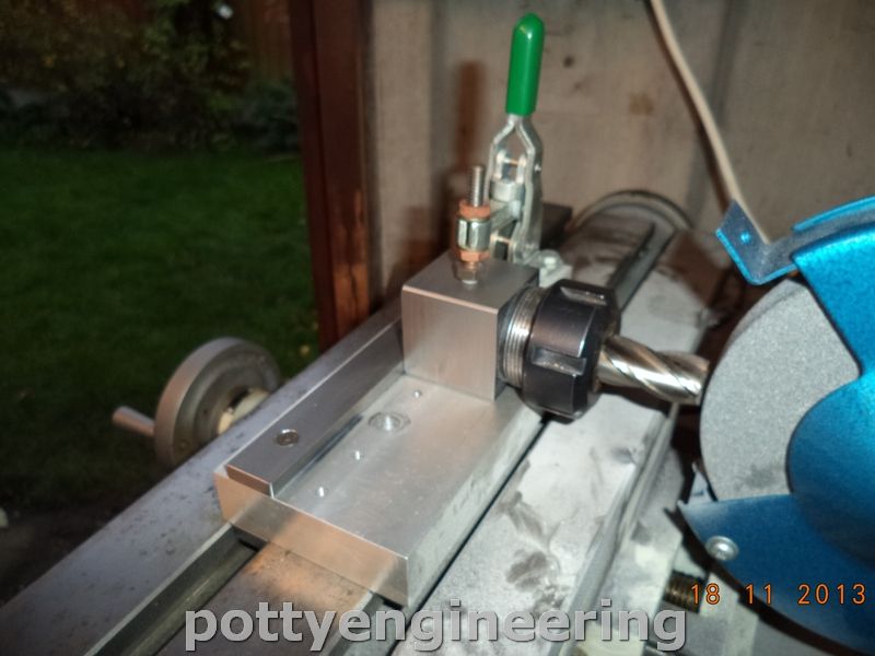

                              Made an end mill sharpening fixture for the grinder its a bit of a mixture of ideas that I've seen plus a few of my own, its base round a ER32 straight shank collet holder with a cam operated block for grinding down the flutes plus am index ring so that the one fixture will deal with the complete sharpening of an end mill.
                              This video should give you an idea how it works.
                              Stew
                              #147317
                              _Paul_
                                @_paul_
                                Very nice, if you didn't want to manufacture the ER32 end mill holder I imagine you could integrate one of John Stevenson's end mill sharpening fixtures which already has suitable angles required for end mill sharpening.
                                Paul
                                #147321
                                Stewart Hart
                                  @stewarthart90345
                                  That's a good idea Paul, especially if you mounted it horizontally on my home brew cutter grinder.
                                  Stew
                                  #147324
                                  _Paul_
                                    @_paul_
                                    John's fixture is quite robust and would easily stand having the base drilled and tapped, attach to your homebrew grinders compound table with a sturdy ribbed angle plate perhaps.
                                    You could take this a stage further if all you wanted to do was sharpen end mill lips attach John's fixture (or similar) to your lathe cross slide with a similar arrangement and mount your stone/diamond wheel in a collet.
                                    Mount the fixture on your lathe topslide and if your slide permits enough rotation you then have the facility to crudely sharpen ball end mills.
                                    Paul

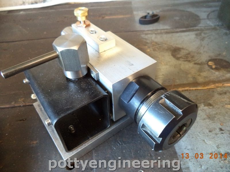

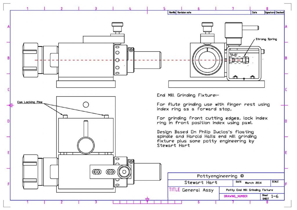

                                    #147662
                                    Stewart Hart
                                      @stewarthart90345
                                      Bin struggling with man flue its kept me out of the shed
                                      (yes its that bad) kulou
                                      So kept myself busy drawing the fixture up.
                                      #147742
                                      Rod Ashton
                                        @rodashton53132
                                        Stewart
                                        Thank you for your timely design.
                                        Have acquired 60% of a Stent and cobbled it to a redundant saddle grinder. Just ordered an ER 32 spindle when you posted this.
                                        May I ask if there are any bearings in your spindle block? Would like to request a little more detail on the cam locking if possible and the way the spindle block is dowelled to the square section for sliding squarely.
                                        Rod
                                        #147743
                                        Stewart Hart
                                          @stewarthart90345
                                          Hi Rod
                                          There are no bearings in the spindle block its just a good sliding fit the ER32 holder has a fine ground finish so thing move very slick.
                                          The cam is just a flat machined on the lever, the block is spring loaded an pivots on two 1/4" ball bearings.
                                          If you send me a private message through the forum with you email address I'll email you a full set of drawings.
                                          The design is a compilation of ideas I got from Philip Duclos shop wisdom book and Harold Halls Book No 38 in the workshop practice series plus a few ideas of my own.
                                          Stew
                                          #147748
                                          dcosta
                                            @dcosta
                                            Hello Stewart, good morning.
                                            After my Harold Hall's grinding rest suffered deep rust from a fire, I'm interested in to rebuild part of it.
                                            Your draw suggests me a good replacement for the end mill sharpening fixture.
                                            Will you, please, be so kind as to let me use your drawings drawings?
                                            Thanks in advance
                                            Dias Costa
                                            #147749
                                            Stewart Hart
                                              @stewarthart90345
                                              Hi
                                              If you send me a personal message through the forum with your email address I’ll post the drawings to you
                                              Stew
