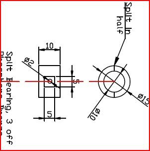

        Couple of things that don’t look right on the ME drawings when compared to the originals.
        Fig 19 Crankshaft Bearings, the 5mm dimensions are shown but not the machined square flat they refer to.
        Part 42 Eccentric Sheaves, Shown with 10mm bore as original drawings but crankshaft is shown as 12mm dia
        Part 21 Outer Guide bar bearing, size of holes not shown
        Part 23 Crankshaft, No length for the reduced dia and or unreduced dia at each end shown. Probably better to show the length of the bearing surface.
        J

              #76577
                Part 19 on your drawing shows a 5mmx5mm flat machined on the top of the bearing, I assume the oiler bears against this to stop rotation. In ME the two 5mm dimensions are given but the square is not shown.
                Part 21 I think is different anyway but the 4 holes are not sized
                Part 23 Can’t find a pdf for that but it could do with teh added dimension.
                Also on the big end caps one view shows a central 3mm hole but its not shown from the opposite end or as hidden detail from the side. Is this meant to be the dowel hole in the conrod?
                Oh and the wrong photo has been used in pic 43.
                While I’m on it reads as though you bore the bigend hole in the conrod and then saw off the cap, is that correct as I’ve always split the part first before boring as that way there is no risk od squashing the bearing when tightening the bigend.
                J

                  Q1:- Part 19 on your drawing shows a 5mmx5mm flat machined on the top of the bearing, I assume the oiler bears against this to stop rotation. In ME the two 5mm dimensions are given but the square is not shown.
                  A1:- Part 19 are the crank shaft bearing, they don’t have this flat. The split big end bearing has this flat. don’t know why this is shown on part 19 its not on the origonal.

                  #76598
                    This is the part, shows flats, the ME one has the 5mm dims but no flat
                    Don’t know why you say the big end bearings have flats, would have thought they just needed a hole for the dowel pin but will wait for the next issue.

                      Quote:- Don’t know why you say the big end bearings have flats, would have thought they just needed a hole for the dowel pin but will wait for the next issue.
                      Quaote:-
                      Reply:- It acts like a key to stop the bearing turning, we use to have some Taylor and Challen draw presses that used this system on the main crank shaft bearings, so I used the method her.
                      Stew
                      #76607
                        Ah are you saying the dowel pin bears against the flat to stop the bearing rotating? I can see that working.
                        Though I have usually seen a hole in the bearing to take a fixed pin or if the hole is at the top then the wick tube from the oiler is taken through the cap and into this hole so preventing the bearing from turning.
                        J
                        #76608
                        Stewart Hart
                          @stewarthart90345
                          Thats correct.
                          I’ve seen the other methods also, don’t know what advantage the flat on the bearing would have i just remembered it and decided to use it.
                          Taylor and Challen didn’t use it on all their presses, we had about ten of this type and they were all the same.
                          Stew

                                two things cleared up here…the 5 mm flats on crank bearings..I was stumped as to what the 5mm dimension was as 2mm hole on my drawings did'nts show square around lube hole…I did note the change from 10 to 12 crank but I did wonder if I was missing something.
