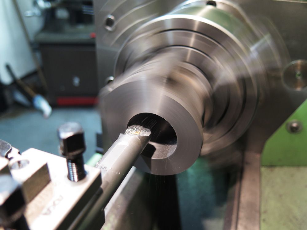

        Hi Nick
        Nice work to date; intrigued by the boring bar in one of your pics… any details, where from, size etc ?

                Ello George,
                It's an iscar one that I nabbed on ebay as 'new old stock'
                The info stamped on the side says it's this one **LINK** Except it does not look like that one. Only similar.
                Nick

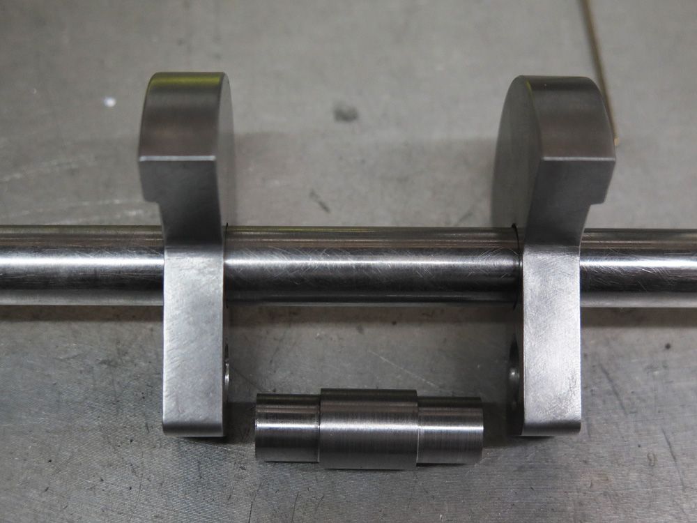

                      Posted by JasonB on 22/11/2015 10:59:40:
                      Nick if you have not silver soldered before then do a few test joints on some scrap, you have a lot of time invested in the crankshaft parts and it would be a shame to have a muck up with them.
                      Did a test joint using the off cut surplus of the crankshaft I had turned and the waste from the parting off from making one of the webs.
                      Once done I but the crankshaft scrap stub in the lathe and made a few facing cuts. Then took some cuts off the diameter of 40 thou with 8 thou per rev feed to test it's strength. As you can see it held. Then rubbed on some emery to see the joint better.
                      These are the bits waiting for the flux that Jason recommended to arrive. As said I have taken quite a bit of time with these parts so if I make a dogs danglers of it I am going to dress in drag, joint the WI and take up jam making and flower arranging. laughwink

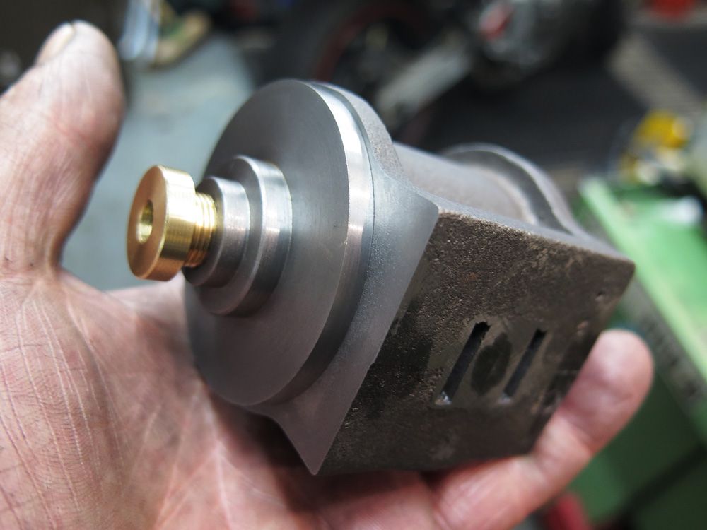

                          #214564
                          Nick_G
                            @nick_g
                            Just so you all know I have not been slacking. wink
                            Still need to dress and finish the webs properly. If I cannot get a decent finish on them I will cheat and paint them. blush
                            Nick

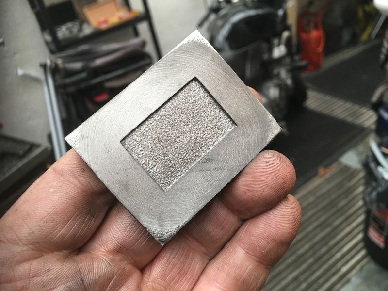

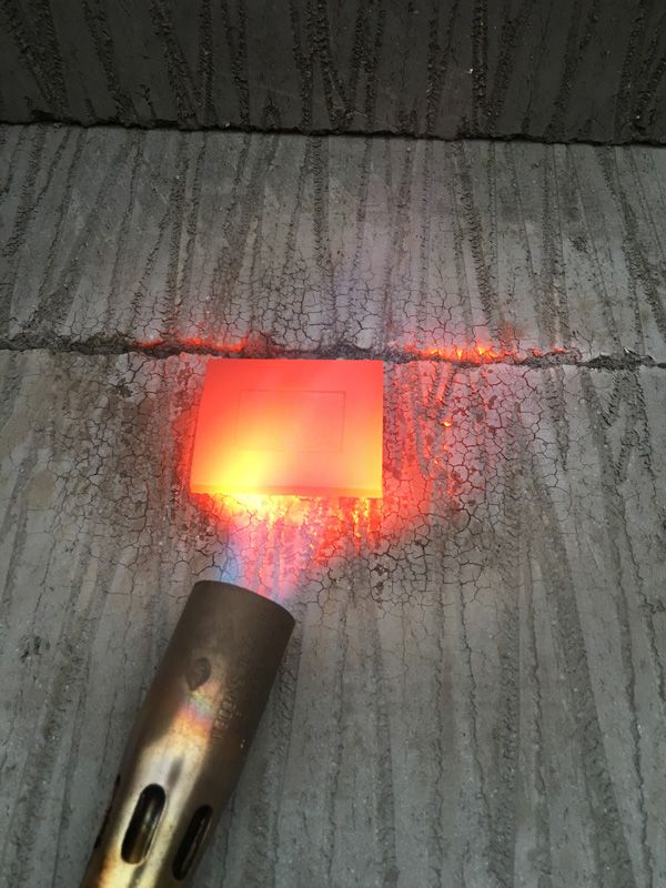

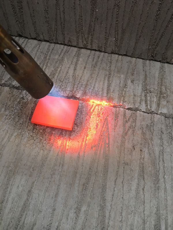

                                  Is this a chilled casting.???
                                  Nothing will put a cut onto the outer corners. Crobalt tool or carbide inserts just get wrecked. indecision
                                  Cheers, Nick
                                  Edited By Nick_G on 06/12/2015 13:05:49
                                  #215301
                                    Yes
                                    Get your blowlamp out and heat it to bright red and hold it there for about 15mins then allow to cool as slowly as possible. Should then be able to machine it. I would mill with indexable carbide if you have it but the holes should be OK with a HSS drill as they are in from the corners.
                                    Alternative if you have an open fire or woodburner put it in there for the night (you will need a lit fire) and leave to cool in the ashes overnight.
                                    J
                                    #215307
                                    Nick_G
                                      @nick_g
                                      Cheers Jason. It's cooling.
                                      I will try again in a bit.

                                      #215327
                                      Steve Sharman
                                        @stevesharman33815
                                        This is where a pair of night store heater bricks come in handy because they retain heat. Warm up one brick, cook your part on the other brick then place the first brick on top. Your Celcon-style brick won't retain the heat and you may still end up with chilled edges.
                                        Regards, Steve
                                        #215372
                                        Exmoor309
                                          @exmoor309
                                          I had to do something similar with a brake shaft bracket that I couldn't machine. I heated it up to bright red, held it for a while then wrapped it in some ceramic insulation – It was still cooling down about 8 hours later, but it machined lovely the next day!
                                          Edited By Exmoor309 on 06/12/2015 23:15:54

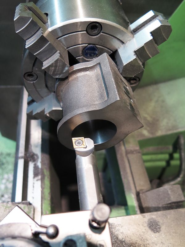

                                          Nick_G
                                            @nick_g

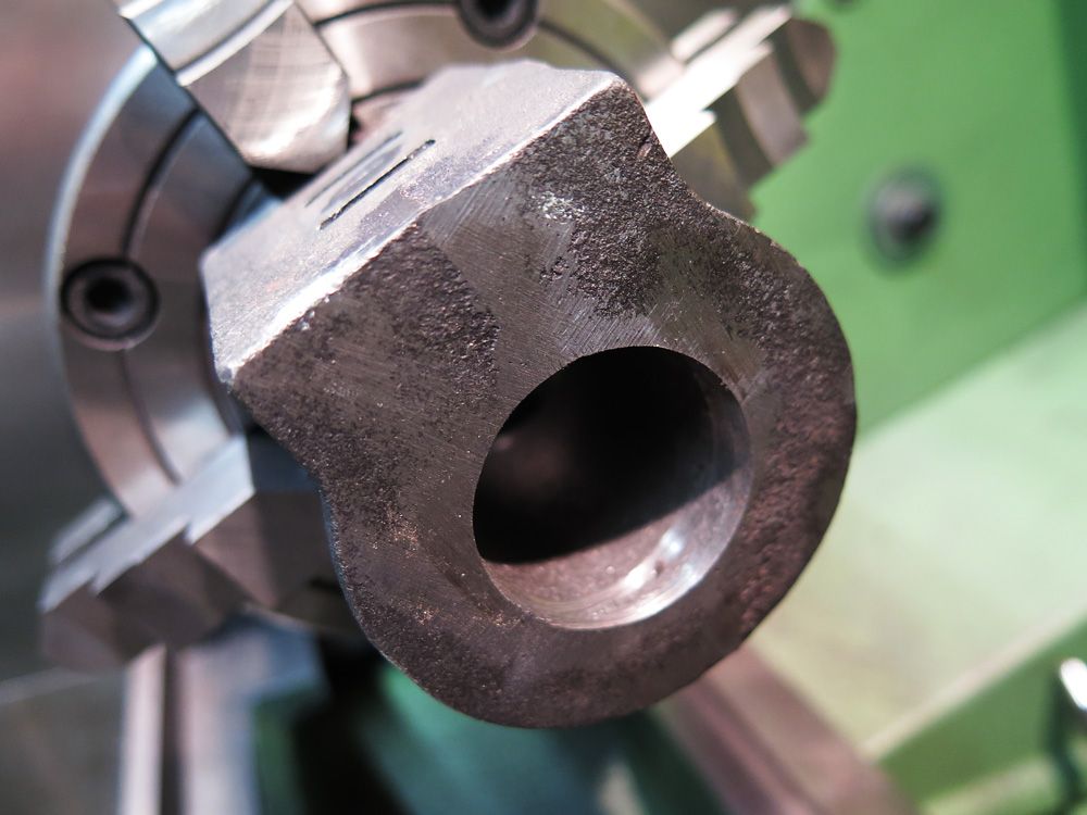

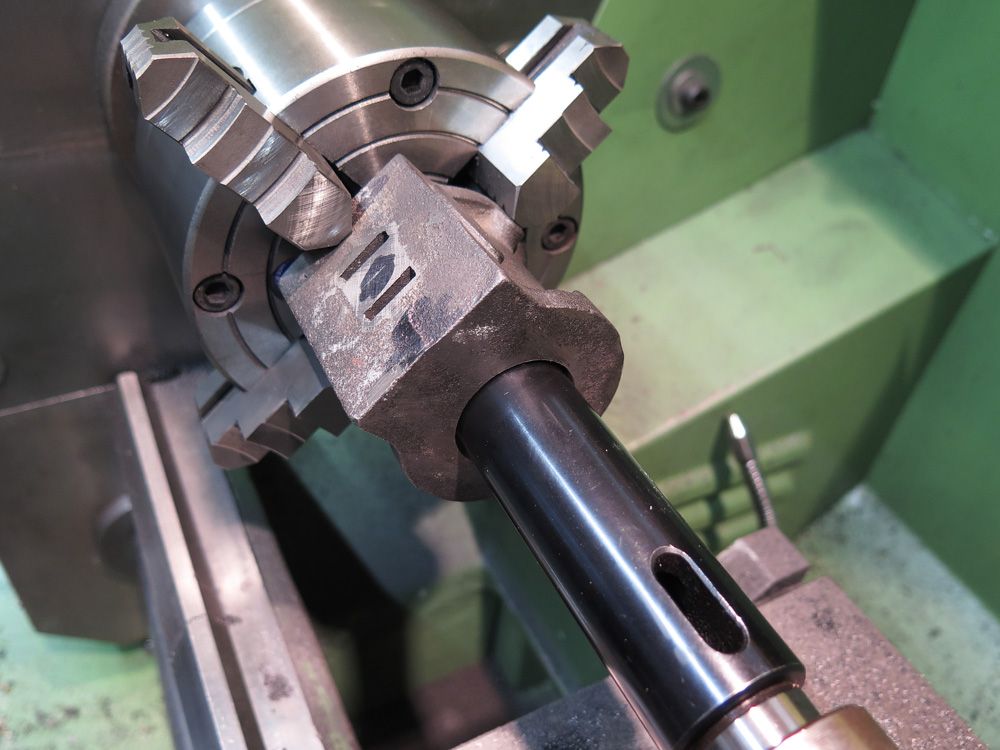

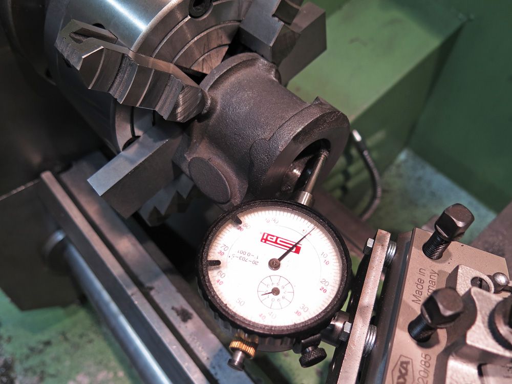

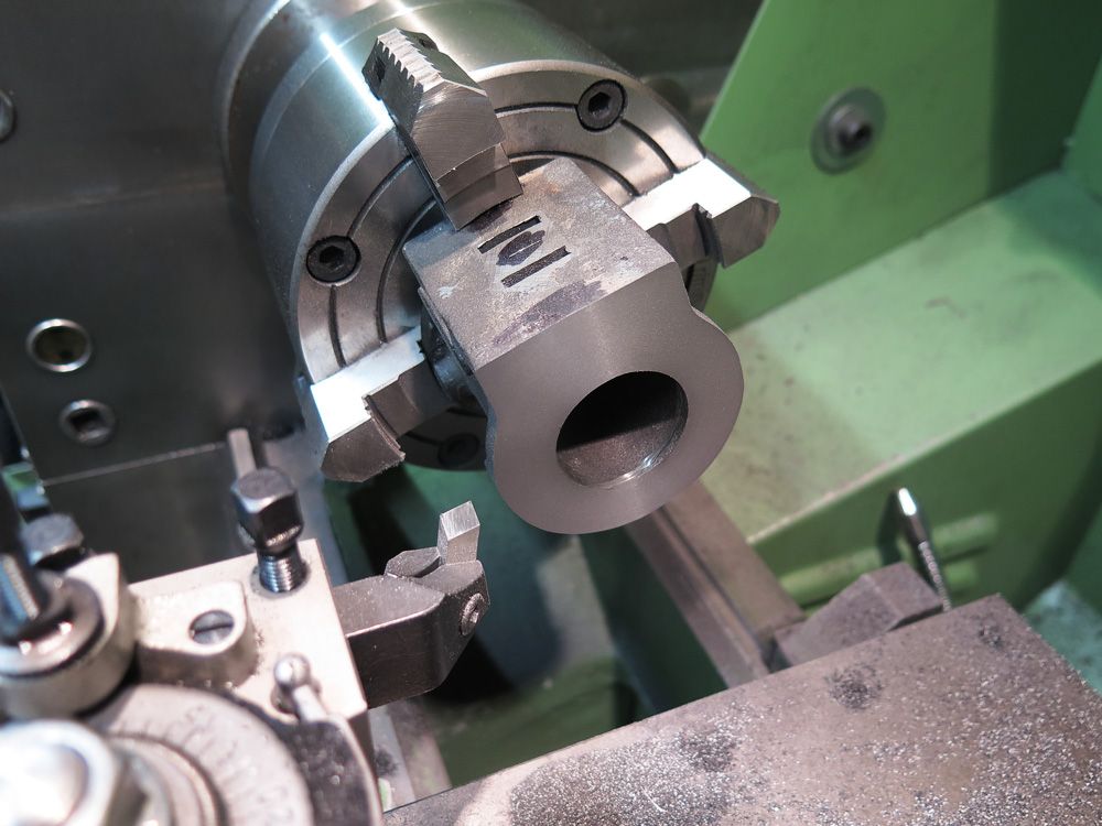

                                            About time I made the engine taller, so onto the cylinder.
                                            I know there are several ways to do a cylinder but chose to use a 4 jaw. So after checking overall 'trueness' I set up the best aproximation to the bore.
                                            Then faced off using the distance between the cast inlet ports as a long center. A compromise had to be taken as this would have left the point of inlet into the cylinder uneven due to the steam passage casting to being even.
                                            Casting was reversed and reset with a parallel behind the already machined face and the chuck face. The bar and a dial indicator was used for best guesstimate of the bore center.
                                            Machining to the other face and the bore proceeded.
                                            Short clip of video.
                                            I am happy with the result.

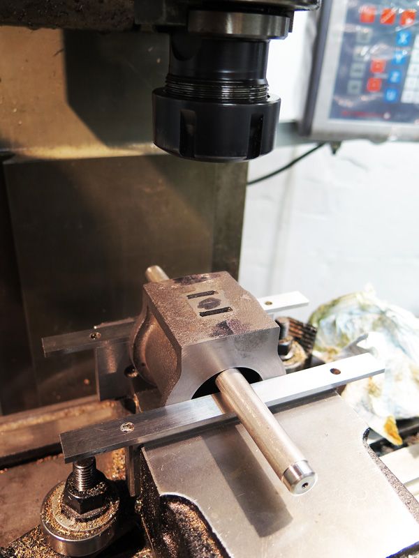

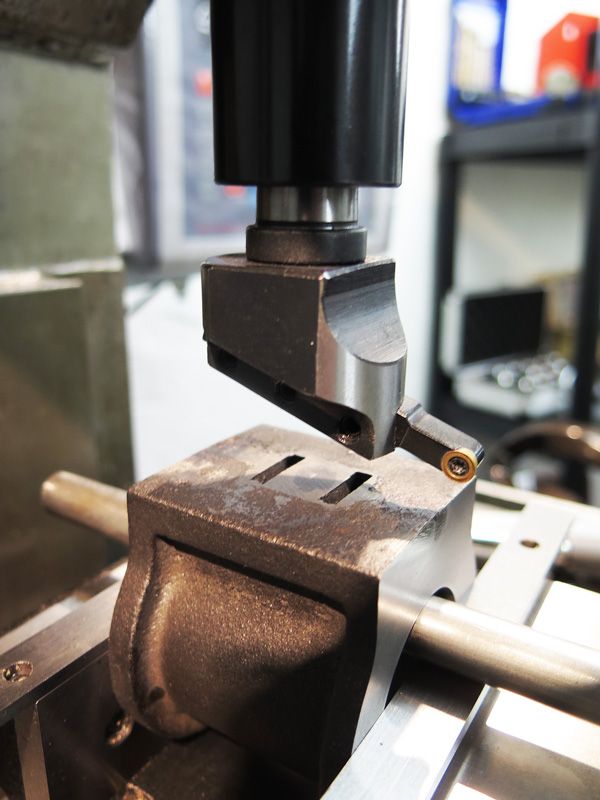

                                            Then over to the mill to face off the ports.
                                            Used the 'button' tool in the fly cutter again to do this.
                                            Last time I used this tool in the mill it caused some interest to how it performed. So here is a short video of some quick roughing cuts. (forgive the wobble as I am holding camera with one hand and cranking with the other.)
                                            Nick
                                            #215677
                                            Martin Connelly
                                              @martinconnelly55370
                                              I have used a 6mm button tool in the same way for long parts in stainless steel where possible wear of a HSS tool would have been unacceptable. The part was curved but with an average width of about 30mm and had six Ø20 holes in it. the button tool worked well and had no issues with the interrupted cutting required.
                                              Martin
                                              #215680
                                              Emgee
                                                @emgee
                                                The sound from that fly-cutter tells you it's working a treat, typical of cast iron.
                                                Emgee
                                                #215696
                                                MM57
                                                  @mm57
                                                  Neat fly cutting! Any ideas about who sells the tool and inserts?
                                                  #215711
                                                  Nick_G
                                                    @nick_g
                                                    Posted by MM57 on 09/12/2015 17:20:10:
                                                    I got it (I think) from Chronos. **LINK** The one I have is a Glanze listed as XC40 due to the fly cutter taking an 8mm toolbit. Yours may of course be a different size.
                                                    When the insert loses it's edge, just rotate it a few degrees and you have a different new cutting edge. They seem to last quite a while.
                                                    Hope this helps, Nick
                                                    Edited By Nick_G on 09/12/2015 19:21:57

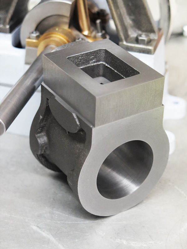

                                                    #215734
                                                    Nick_G
                                                      @nick_g

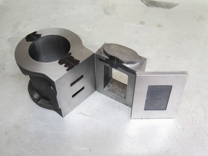

                                                      Progressing on with the valve chest.
                                                      Nick
