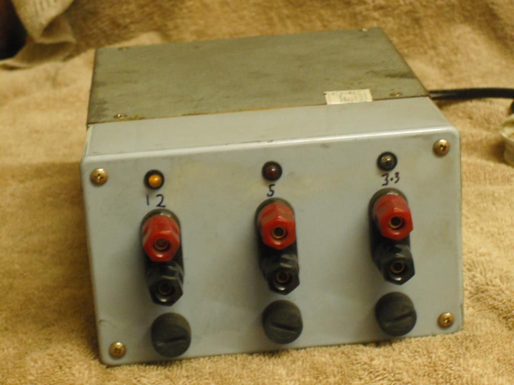

                                            As Anthony above suggests a computer power supply together with some coloured terminals make a good bench power supply. Also a more versatile one can be made out of an old type battery charger, fit a double pole change over switch, one way battery charger the other PSU. Fit a capacitor across the PSU output as a bit of smoothing, then a 5 amp three terminal adjustable regulator, break the positive output lead and insert an ammeter and you have a very useful workshop gadget. If you can get hold of disable buggy battery charge they are even bigger and better, 10 amp transformer, good case and ammeter. John.
