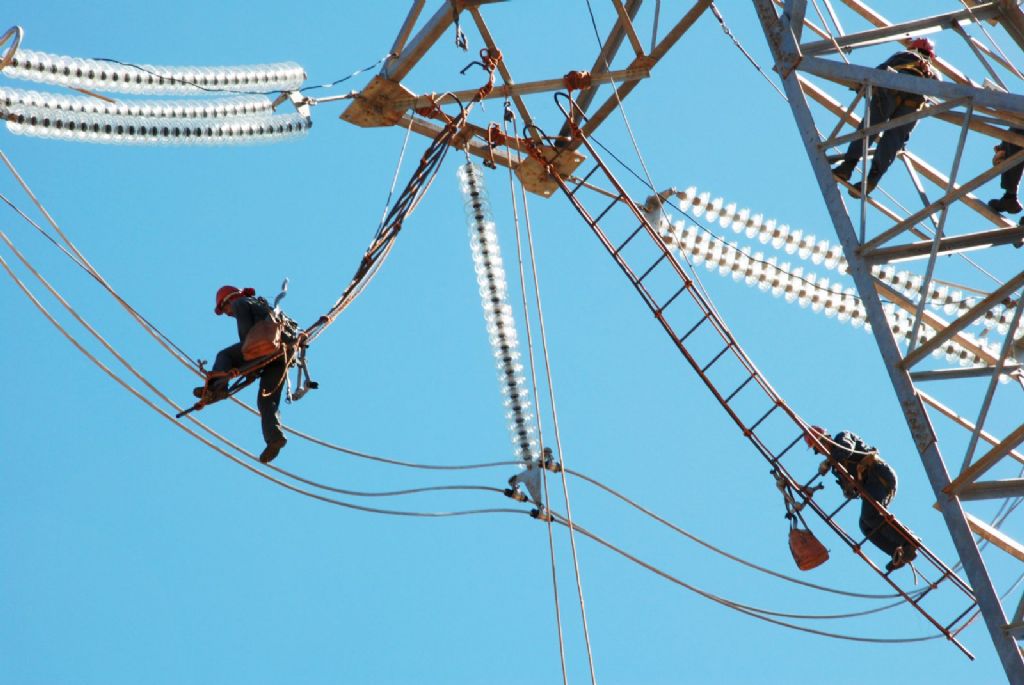

      An extreme example but I'm sure these guys would not appreciate being anywhere near anything that was earthed.
