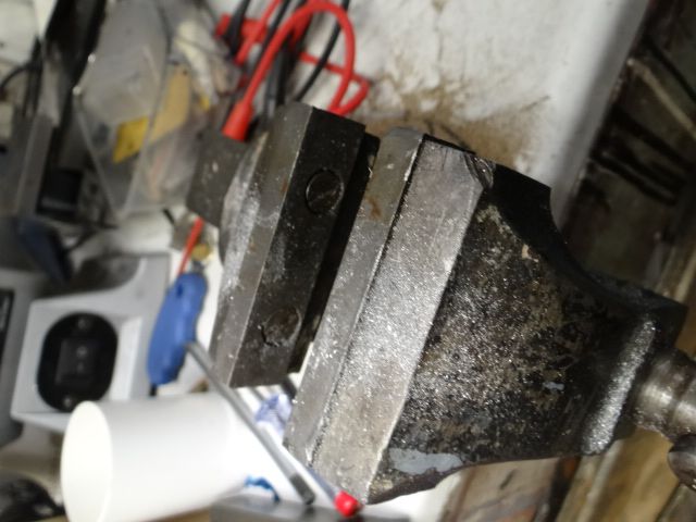

                                #542273
                                  Posted by John Smith 47 on 29/04/2021 16:47:04:
                                  …. it's a shame than nobody seems to have invented a method for attaching/removing vice jaws without putting two dirty great holes through the middle of the blades! Like I say mostly I would want smooth not serrated blades.
                                  Not aware fixing holes are a problem, and if they are it's odd this deeply notched vice is John's potential winner:
                                  The hardened steel jaws supplied by Record are too aggressive for my taste so I replaced them with smooth mild-steel, home-made.
                                  Mild-steel is softer than hardened jaws but tougher than Record's expensive fibre alternative. Occasionally, I avoid marking softer work by popping on a pair of home-made Aluminium jaw covers, which also cover any holes or serrations:
                                  One of the advantages of owning a metal workshop is being able to make and modify tools. It's often easier to adapt than run complicated searches for perfect answers, especially if the Requirement is mostly guesswork. Nothing challenging about making jaw covers: one of those shown is little more than a length of sawn off Ali angle, the other is made from a bit of soft plate bent with a hammer to stay on the jaw. When they get too tatty, or I need something different, I shall make more.
                                  PS.  No prizes for noticing I don't have an immaculate workshop.   Worse than it looks – the bench was tidied to take those photos…
                                  blush
                                  Edited By SillyOldDuffer on 29/04/2021 17:29:42
                                  Edited By SillyOldDuffer on 29/04/2021 17:33:07
