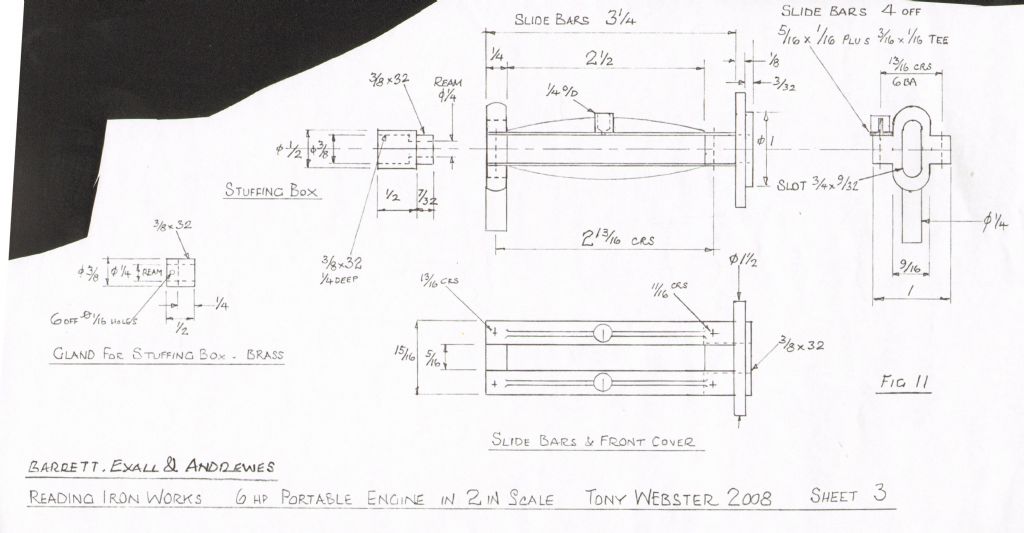

        On page 2, you have transposed the 3/8 and 5/16 dimensions.
        5/16 + 5/16 for the slide bars + 5/16 for the slot = 15/16 which is correct.
        If you make the right hand diameter 1 inch when it is cut away to take the slidebars it will probably be about 15/16 at the edges.
        The centres of the slide bars should be 11/16 inch, not 13/16 as drawn. (The screw centres are still 11/16 and 13/16 respectivley.

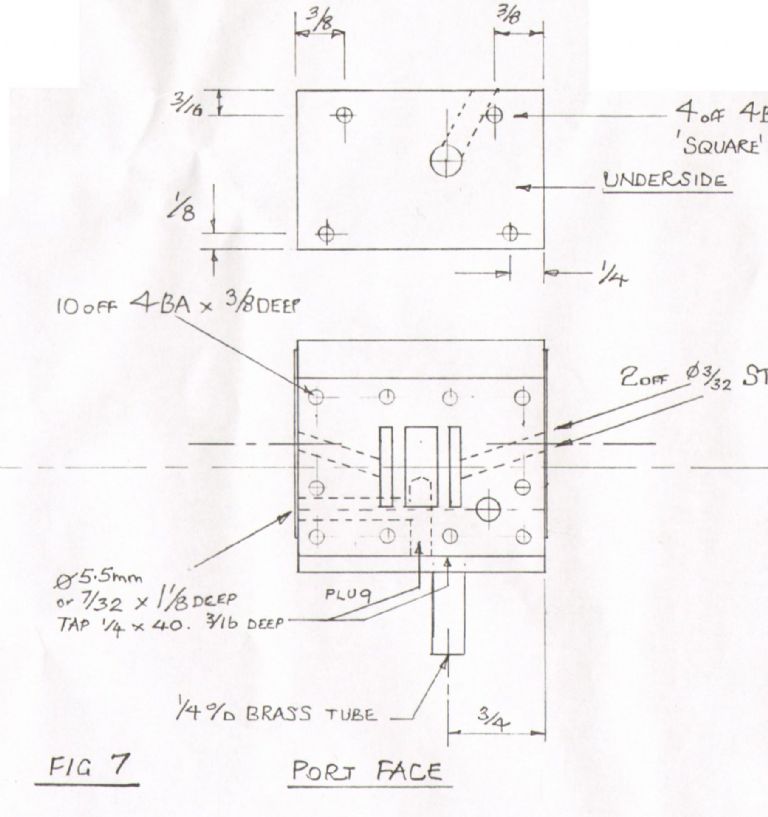

            JQ. There is no depth for the steam port slots.
            T.A They must not break into the cylinder bore.
            J Or the exhaust passage drilling which is nearer the surface

            J. NO this will not fit the bar spacing it should be 5/16 to match the flat on the end of the cylinder cover as described on page 502
            Slide bar drawing
            J Basically my hand drawn one is correct so David you may use this if you want in the mag but see last few items at teh bottom

            J.Q. Is this the actual view of a developed shape of the curved part.
            J.Q. The 1/8in. dimension at the bottom left is wrong, it should probably be ¼ inch.
            J.Q. The two 9/32 inch dimensions on the left seem wrong as the hole will break through the edge, 11/32 inch would be nearer what is right.
            J. I feel this drawing is wrong, the reason being that the position of the 1/4 inch steam feed hole and two of the four mounting holes are dimensioned at 3/4 inch and 3/8 inch in from the edge respectively. They also have the same dimension in from the end of the inverted cylinder plan that was in issue 4426. The problem is that the base of the cylinder is only 1 15/16 inch long but the saddle is 2 inches long so no allowance has been made for the 1/32 inch difference at this end but it has at the other because the holes are shown at 9/32 inch which is the 1/4 inch + 1/32 inch. See also my drawing in a previous post and wrong items in red

            T.On page 2, you have transposed the 3/8 and 5/16 dimensions.
            T.5/16 + 5/16 for the slide bars + 5/16 for the slot = 15/16 which is correct.
            J. No the 5/16 is mentioned in the text as the size to machine the flat on the cylinder cover, this sets the vertical gap at 5/16” you yourself said you went out to the shed and measured the width as 3/8
            T.The centres of the slide bars should be 11/16 inch, not 13/16 as drawn. (The screw centres are still 11/16 and 13/16 respectivley.
            J. This just contradicts what you said above if the bars are spaced on 11/16” cts then the overall width will be 1” not 15/16” (11/16 + twice half of 5/16 = 16/16 )
            T.If you make the right hand diameter 1 inch when it is cut away to take the slidebars it will probably be about 15/16 at the edges.
            J. Outer edge of slide bars should be 1” as two reasons above so to give the bars full support the spigot on the end of the cylinder cover should be 1.048” as shown on my version of the drawing

                          Q. For the cylinder drawing the text says machine the valve face back to lines 1 and 2 but drawing shows it at least 1/32 inch away from them. A. Machine to the line as the text says.
                          Q. The length of cylinder and protrusion of end faces are not shown on the drawing?
                          A. They can be found in the text.
                          A. They must not break into the cylinder bore or any of the steam holes.
                          Q. Width of valve chest given as 3/8 inch?
                          A. This should be 1 3/8 inches.

                            Slide bar drawing
                            Q. The plan view gives width over the outside of the bars and bracket as 15/16 inch.
                            A. This is correct.
                            Q. The plan view gives one end of the bars drilled at 13/16 inch centres and the other end at 11/16 inch centres?
                            A. This is correct; you will have to relieve the slide bars at the left-hand end, as drawn, to clear the oval section. The view shows the slidebars at 13/16 centres when they should be 11/16 centres. At the 13/16 inch end the bolts are offset outwards from the slidebar centreline.
                            Q. The end elevation gives the bracket as 1 inch wide and the slide bars project beyond the bracket.
                            A. The slide bars should not project outside the 1 inch dimension, they are 15/16 inch overall width.
                            Q. The oil cup does not show the hole carried through the slidebar. A. It goes right through the top slidebar.

                            Saddle and cylinder
                            Q. Is it correct that the cylinder does not sit centrally on the curved flange front to back?
                            A. The saddle should be made first and the cylinder clamped to it centrally back to front, i.e. 2 inch and 1 15/16 inch dimensions. It is not central the other way, or not until the Valve chest and cover are fitted. The 1 1/4 dim. is to clear the stud holes for the VC otherwise it would be the same as the other side at 1 7/16 centres. Use the saddle to drill the cylinder. If all saddle holes are first drilled tapping size, it will be easy to the saddle as a drilling jig.
                            After drilling the cylinder, remove the saddle and clamp the saddle to the curved top part of the horn plates. The 1/4 x 40 steam intake hole should line up with the centre of the large bush (other regulator bush) but make sure that the valve face is VERTICAL. The cylinder is not on the centre line of the boiler. It rarely was on portables or traction engines.
                                A. This is correct.
                                J. Two things are said to be "correct" but they contradict each other, I will do a sketch as its easier to see the error.
                                The valve chest
                                The blind valve end is shown with a 3/16 x 40 male thread, if you look back at issue 4427 the valve chest that this is meant to screw into is shown with a plain 3/16 inch hole at each end. One end of the steam chest should be threaded 3/16×40 for the bush to screw into. If you have already made the valve chest, the blind valve end could be tapped 7/32 x 40 and the thread made to suit.
                                J. Fair enough but any answer on the other end of the chest, there is no gland shown for the 3/16" end of the valve rod.
                                J.So in other words the dimensions on the saddle are wrong as I said, A corrected drawing should be issued and the cylinder drawing altered so that it reads that the 5 holes read "locate from saddle"
                                J. While we are talking about teh cylinder I think a passage way has been missed off the drawing as there is no way steam can get from the 1/4" brass pipe into thevalve chest, I could be making assumptions but there is no way this engine will run as its drawn!!!!

                                  The hole is there on my original copy but the dotted lines are missing
                                  from the redrawn diagram.
                                  The hole goes from the hole on the bottom right and is angled down towards the brass tube.
                                  regards David

                                    Right Lets see who is any good at basic maths.
                                    I one reply Tony says gap between bars is 5/16" and overall width 15/16" but this would put the bars on 5/8" cts, this is the lower of the two sketches.
                                    In another reply Tony says Bars are at 11/16"cts, but this would mean the gap between bars is 3/8" and the overall width 1", He also said earlier that he went out to his shed and measured the gap at 3/8" This is shown in the upper sketch which I think is correct.
                                    Please chose one or the other as both can't be "correct" Click image to see it larger.
                                    Slide bar spacing
                                    #90843
                                    David Clark 13
                                      @davidclark13
                                      Sorry, that is my fault.
                                      Lower is correct.
                                      They were drawn on what appeared to be 11/16 centres, obviously not.
                                      regards David
                                      Edited By David Clark 1 on 14/05/2012 20:39:42

                                        Looks like our posts crossed, yes that is the elusive passageway that I made the assumption was missing, most of my assumptions are rightwink 2
                                        David is there any chance you could let me know the thickness of the "hornplate" wrapper that the cylinder saddle fits on as I can foresee an issue and it would be nice to preempt it.
                                        I do also have an issue with the position of the valve ports as drawn but as it won't affect running will let it go.

                                          J. But how did Tony measure it at 3/8 about a week ago, I think the top one is right as it works so much better with all the other sizes, the bottom option throws other parts out
                                          Can you post the original sketch, I think that the 3/8 & 15/16 sizes that appeared in the mag against the plan view were meant to be against the side view.
                                          Edited By JasonB on 14/05/2012 20:50:03
                                          #90847
                                          David Clark 13
                                            @davidclark13
                                            Not all corrections are Tonys.
                                            The centres are not 13/16 inch, they appear to be 11/16 inch but probably not.
                                            The bottom one ties in with the original drawing.
                                            I doubt it matters which but the width between slidebars is definitly 5/16 on the original.
                                            Hornplates are 1/16 inch thick.
                                            The wrapper thickness is not on the drawing but looks the same or slightly thinner.
                                            The wrapper is 1/2 inch higher than the top of the boiler.
                                            How the clinder fits on that I have no idea at the moment.
                                            regards David
                                            slidebars
                                            Edited By David Clark 1 on 14/05/2012 21:00:20
