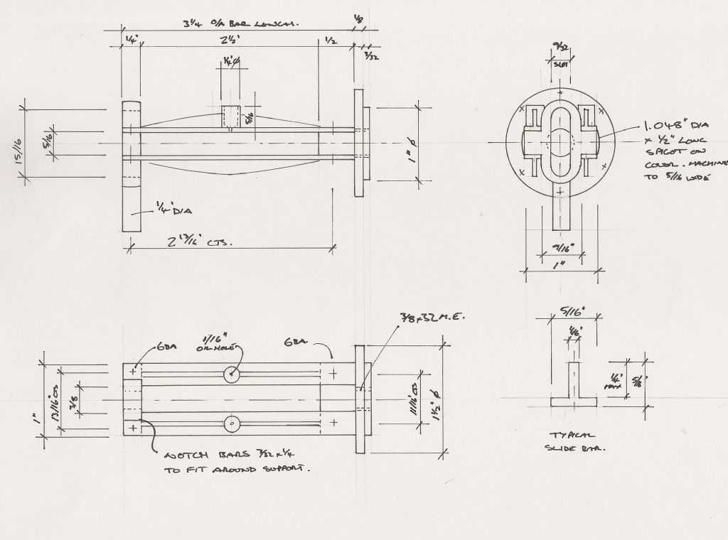

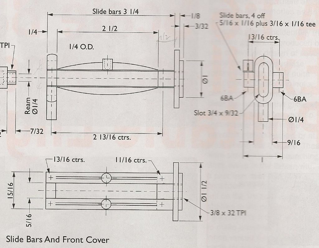

                              So are you saying the two bars are on 11/16" centres. If so the end elevation is wrong as that has them sticking out beyong the support bracket in which case the 1" dimension is wrong, the 13/16" dimension to the reinforcing web is also wrong and how do teh bars fit each side of teh support which is 9/16" wide, they would need notching around it???
                              I think a new drawing is needed as there are just too many anomolies on this one to try and describe in writing alone.

                                  Just been thinking about what I said above and looking at the photo I linked to on the previous page.
                                  If the 5/16" wide bars are on 11/16" cts that agrees with Davids 3/8" between bars. But the bar support is given as 9/16" wide ( this looks in proporting) so the bars would need to be notched out to fit round it making the bar ends 7/32" wide, this would be why the bolt spacing is increased to 13/16 at this end.
                                  Looking at the photo confirms that the bearing surface of the bar is wider tha the end that we can see.
                                  David can you confirm if the front end of the bars are notched and if so why was it not on teh drawings
                                  Another greek C**k up that has made it hard to follow is that the 15/16" & 5/16" dimensions shown against the end of the plan view actually apply to the side elevation, the 5/16" being the Horiozontal gap between the slide bars and the 15/16" is just about right for the height of the oval cutout in the support post.

                                    Further to the above this is the "drawing" as ME click both to enlarge
                                    slidebar as Me
                                    And based on Davids Measurement, looking at photos and applying a bit of common this is a quick sketch of what I think it should look like
                                    Jasons slidebars
                                    J
                                    Edited By JasonB on 29/04/2012 20:38:37

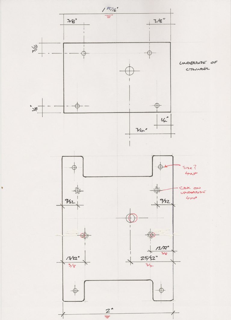

                                      Cylinder saddle was the wrong drawing. Corrected version in 4429.
                                      regards David
                                      Well the "corrected" drawing that has been published in 4429 STILL HAS ERRORS, lets hope someone will be third time lucky when the second revision is published.

                                            Drawing of the corrected saddle to follow. Any thoughts on that sketch I posted on the guide bars? as the 3/8" dimension you measured would throw a lot of other things out.
                                            Edited By JasonB on 02/05/2012 14:11:45
                                            #90110
                                              Cylinder saddle issue 4429
                                              As said above I feel this drawing is still wrong, the reason being that the position of the 1/4" steam feed hole and two of the 4 mounting hole are dimensioned at 3/4" and 3/8" in from the edge respectively. They also have the same dimension in from the end of the inverted cylinder plan that was in issue 4426. The problem is that the base of the cylinder is only 1 15/16" long but the saddle is 2" long so no allowance has been made for the 1/32" difference at this end but it has at the other because the holes are shown at 9/32" which is the 1/4" + 1/32".
                                              Click on the pic below to get a larger view of what I feel is correct in black and what the drawing in 4429 gives is shown in red.
                                              Corrected saddle
                                              Comments from Tony or David awaited

                                                      Slide bar drawing
                                                      Q. The plan view gives width over the outside of the bars and bracket as 15/16 inch. A. This is correct.
                                                      Q. The plan view gives one end of the bars at 13/16 inch centres and the other end at 11/16 inch centres? A. This is correct; you will have to relieve the slide bars at the left-hand end, as drawn, to clear the oval section.
                                                      Q. The end elevation gives the bracket as 1 inch wide and the bars project beyond the bracket. A. The bars should not project outside the 1 inch dimension. I think the 1 inch is also related to the 1 inch diameter that enters the cylinder.

                                                      Cylinder saddle.
                                                      Q. Is this the actual view of a developed shape of the curved part.
                                                      Q. The 1/8in. dimension at the bottom left is wrong, it should probably be ¼ inch.
                                                      Q. The two 9/32 inch dimensions on the left seem wrong as the hole will break through the edge, 11/32 inch would be nearer what is right.
                                                      I feel this drawing is wrong, the reason being that the position of the 1/4 inch steam feed hole and two of the four mounting holes are dimensioned at 3/4 inch and 3/8 inch in from the edge respectively. They also have the same dimension in from the end of the inverted cylinder plan that was in issue 4426. The problem is that the base of the cylinder is only 1 15/16 inch long but the saddle is 2 inches long so no allowance has been made for the 1/32 inch difference at this end but it has at the other because the holes are shown at 9/32 inch which is the 1/4 inch + 1/32 inch.
