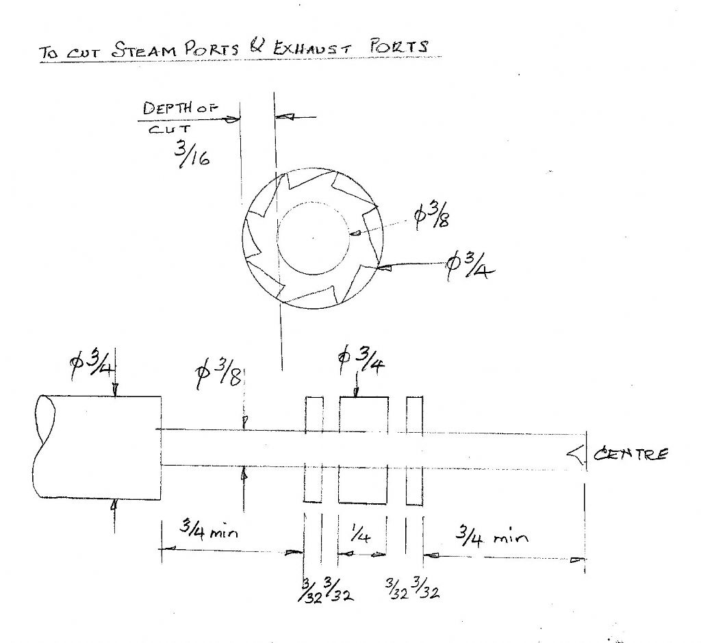

                #87368
                  Cylinder drawing issue 4426.
                  1. No setting out positions for the 10No valve chest stud holes or will they be detailed with the valve chest.
                  2. Text says machine valve face back to lines 1 & 2 but drawing shows it at least 1/32 away from them.
                  3.Length of cylinder and protrusion of end faces not shown on drawing but can be found in text.
                  4. No depth for steam port slots
                  5. Brass tube, I'll wait to see what teh text says before commenting.
                  From the comments in about the last issue I got the impression there was going to be another boiler drawing has this been missed or is it to follow out of sequence? In 4426 it would seem the boiler is "complete " and tested yet the details mentioned two posts above have not been covered??
                  J

                                                Issue 4428
                                                Slide bar drawing
                                                -Plan view gives width over the outside of the bars and bracket as 15/16
                                                -Plan view gives one end of the bars at 13/16" centers and the other end at 11/16" ctrs
                                                -End elevation gives the bracket as 1" wide and the bars project beyond the bracket which would give the outer edge of the bars as 1.125" or there abouts
                                                – and to be picky the oil cup does not show the hole carried through the slidebar
                                                Cylinder saddle.
                                                – is this the actual view of a developed shape of the curved part.
                                                – 1/8" dimension bottom left is wrong should probably be 1/4"
                                                – the two 9/32" dimensions on teh left seem wrong as the hole will break through the edge, 11/32 would be nearer whats right
                                                – No size given for the 4No corner holes to mount to the boiler/dummy wrapper.
                                                – Is it correct that the cylinder does not sit centrally on the curved flange front to back, or should the 3/4" dimension for the position of the 1/4" hole be 15/32" to allow for the 1/32 projection of the cover faces beyond the cylinder.
                                                Its now been some 6 weeks since the first queries were raised any idea of when and if they will be answered???
                                                J
                                                Edited By JasonB on 13/04/2012 15:55:52
                                                #89038
                                                David Clark 13
                                                  @davidclark13
                                                  Hi There
                                                  Cylinder saddle was the wrong drawing. Corrected version in 4429.
                                                  regards David
                                                  #89040
                                                  David Clark 13
                                                    @davidclark13
                                                    Hi There
                                                    The slidebar drawing has been checked and is as supplied apart from the hole which is shown right through.
                                                    I will forward the query.
                                                    regards David
