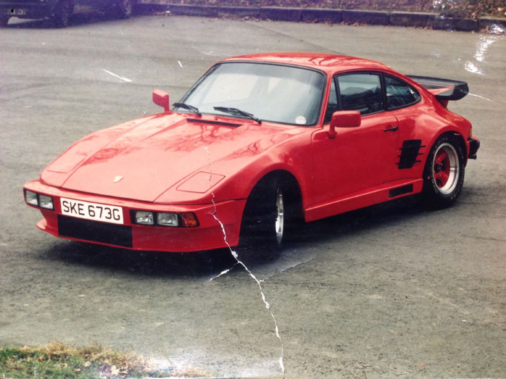

        Peter Seymour-Howell
          @peterseymour-howell39349
          Lovely cars Steve, I thought that I had it bad but you have clearly been bitten by the modified bug far worse than I….🙂
          The Beetle/911 is very convincing…very impressive sir..
          My son's are worse than me, I have no idea where they get it from..son No.2 is the worse, he's had a number of Fast Fords over the years, he's just bought himself an RS Focus with 350bhp, he was going to leave it alone but evidently a 911 showed him it's heels last week so he's now going to boost it a little. He's always telling me that his cars will beat mine but after being beaten by this 911 he knows the Focus isn't as he's seen mine leave 911's, including turbo's and recently a new GT3 for dust.
          I used to be an avid follower of the 951 on the race track admiring just how quick it was in the Porsche Cup series. Alas after watching some great racing in the late 90's early 2000's Porsche banned the older cars from the series as they kept beating their brand new models. After trying many things with handicapping Porsche then entered the fray with the then brand new 996 GT3. In the last season the field included 13 GT3's with not many 951's or older 911's still in the series. The final straw came when the championship was one by an old RS 911. Interrestingly the car with the most wins was Chris Heeley's 951, it also had a lot of DNF due to mechanical failures so only got 3rd overall. At this point Porsche had had enough of 25 year old cars beating their brand new models and made the series GT3's only.
          The most impressive thing about this is the engines had to remain standard, just goes to show how good the 951 is and why Porsche themselves when a current model rated it as the fastest car in the fleet, at that time this included the 928 GT and 911 turbo
          Going back to my son, he may have been outdone by this fat 911 but if he had been in his other car it would have been a different story altogether. His real pride and joy is his Ford Escort Cosworth which has a lot more power then my 951, IIRC around 600bhp and it is in mint condition having been fully restored and painted by my eldest son's business partner who is superb, hopefully, the same chap who's painting my car this year.
          I'll try to post a picture of the cossie later..
          Regards
          Pete
          #544392
            here you go steve, my son's 'Cossie'
            regards
            Pete
