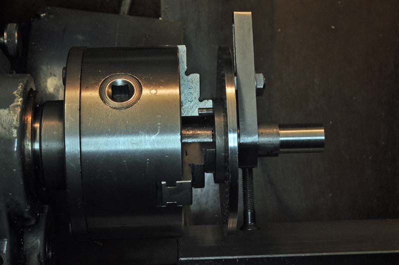

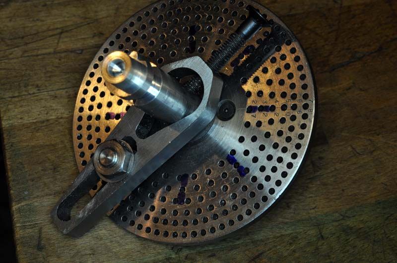

                                            Andrew,
                                            Sorry, I have misled you slightly – the angles for identical PCD (2:1 ratio) are 26.6 degrees and 63.4 degrees but 60 and 30 is as close as you can (sometimes) get from stock gears. PCD is, as you say, number of teeth N / (DP x COS (a)). so for 32 DP 16T 30 degrees PCD is .577" and for 8T 60 degrees .500". Quite close: They are identical for the "magic" angles.
                                            You are quite correct about the technique for machining except that I mounted the blank in a collet in the 3 jaw with a dividing plate mounted on it and an indexer fastened, lathe carrier style, to the blank.
                                            I'm sure you are correct about the relative equipment costs but possibly nullified by the need to move to a bigger house – my traction engine is going to be just the one MInnie smiley

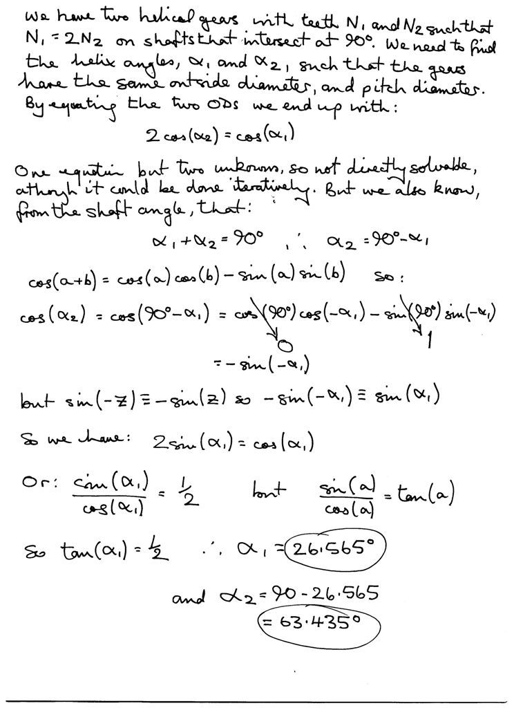

                                            Anonymous
                                              Rod: Ah, that's neat putting the dividing head on the spindle. I'm relieved that my maths isn't completely out of order. While waiting for supper to cook earlier I thought I'd have a go at solving the problem analytically. For those that can't be bothered to do the maths here is my solution:
                                              I make the PCD of the gears, with the precise angles, equal to 0.559". That gives leads of 3.5123" (89.217mm) and 0.8781" (22.303mm). From the tables for my dividing head the nearest leads with standard gears are 89.30mm and 22.32mm – it's a metric mill. I reckon that gives errrors of 0.9µm and 0.7µm per millimetre of face width. That's pretty small and certainly good enough for skew gears. In practise these relatively short leads would require a significant step up ratio in the gearing, so the dividing head spindle would be better driven directly from the table rather than through the worm reduction in the dividing head.
                                              To be precise the universal mill was £145 and the dividing head £125. One would need a pretty solid workshop for the mill, it weighs around 3500lbs, has 5hp motor and knocks the Bridgeport into a cocked hat when it comes to rigidity and simply ploughing through metal like it wasn't there. I've learnt the hard way that you really need to clamp the work down properly.

                                                  @muzzer
                                                  Andrew – you can cut out the stuff in the middle and combine lines 1 and 2 directly, giving:
                                                  2 Cos(90-a1) = Cos(a1)
                                                  but Cos(90-a1) = Sin(a1)
                                                  So line 1 becomes 2Sin(a1) = Cos(a1),
                                                  ie Tan(a1) = 1/2.
                                                  (The mixed blessing of having children of secondary school age)
