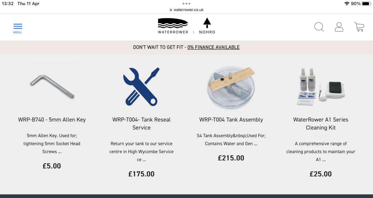

            #725342
              If you don’t mind me saying so, Danni
              … I think the price of the Allen key is a good indication of their game
              IMG_9555
              Sorry, I’m still not sure about the constructional details of the tank [“two halves”]
              Edit: __ In your position, I would be inclined to ask these people for a recommendation:
              https://www.thegluepeople.co.uk/polyurethanes-c-6_10/
                      And that price is for a key to tighten Allen screws, they probably want another fiver for a key to loosen them!
