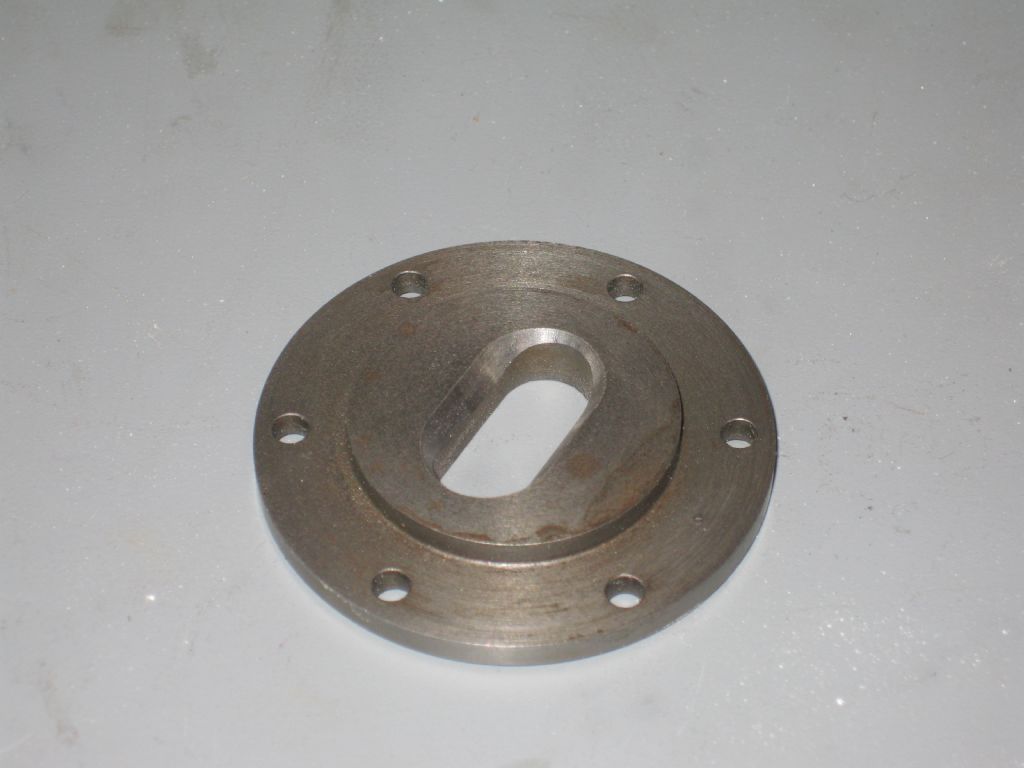

              I made the Scott a couple of years ago and it fired up first time, much to my surprise for a flame licker. One change I made is to ease the flame path into the cylinder by arranging the graphite valve block to drop down to close the port, rather than lifting to close, as shown on the drawings.
              I am trying to strip it down at the moment because I used antifreeze as a coolant and everything not painted has corroded quite badly. (I kept it in its own wooden travelling box and that exacerbated the problem). I thought antifreeze was supposed to stop that sort of problem?
              One mod I read about somewhere that I intend to try is to bevel the inside of the intake port. Don't know whether it will have any effect, positive or otherwise, but it's worth a try.

                        Here's a picture of the modified head. I took the opportunity to put the bevel on the inside of the port while the head was off for the engine overhaul.
                        Modified head

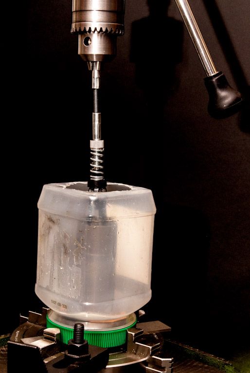

                                  I note the honing sequence on your thread. This was something new to me and I was a bit concerned about spraying oil all around the workshop. My solution was thus:-
                                  It contained all the oil, allowed progress to be observed ,made it easy to keep the hone moving smoothly, squirt in oil as necessary and provided some nice peaches as a bonus! As I say I didn't know what to expect or how long it would take but was quite easy in the end.
